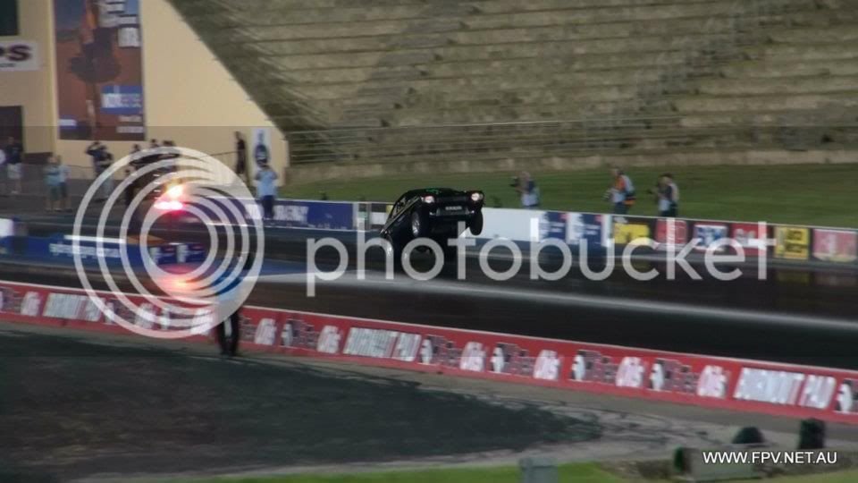

hey guys, quickie update. went out again on Saturday. same bowser E85 tune, this time with Joe back at the wheel. track improved over the day and air was good, was seeing 30-31psi going down the track. few eBoost2 tweaks and some tyre pressure changes, got Joe's bowser E85 best to 8.30@166 only 2/100ths off Elliot's time. but, the good thing that came out of it we got a MPH PB of 167.14 we are happy as to say the least. the little motor has seen over 200 dyno and track passes and she is as happy now as she was when she was done. she will be opened up and freshened up if needed after the new year. got some pretty nice air off of one of the launches.
got video's from behind and from the stand. thanks to Mark www.fpv.net.au for the vid and pic. he is a great supporter of us drag racers
