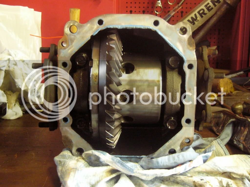

I have a pic somewhere i think, but no, i can't recall ever counting the teeth. I can say it's the larget pinion gear i've ever seen and offsets the CW over a mile
