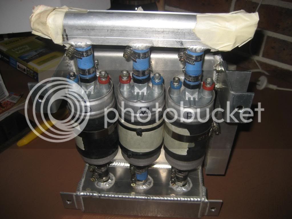

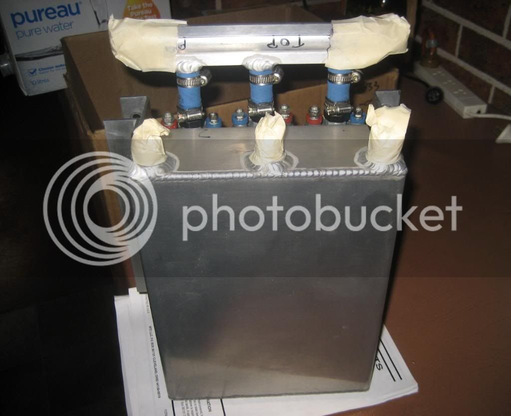

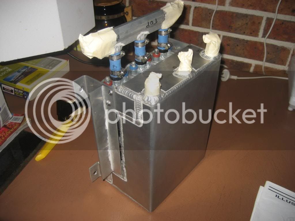

surge tank is out, thought would take a few pics just to show how very basic it is, i have seen some crazy fuel pump setups in my time :p all up it's only about 25cm x 20cm x 15cm. surge tank has enough fuel for about 20km's.
3 x Bosch 044's good for 2100hp gasoline or 1400hp E85. for the new 1UZ combo we will more than likely need to add another pump. looking for 1400-1500hp with that motor.

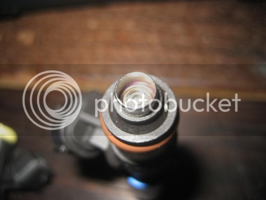

we are getting rid of the old Bosch Indy Blues and going with some Bosch 2000cc atomiser injectors, at the moment on the E90 the Indy Blues are running at a duty cycle of 86% @ 70psi the engine is making around 1150hp@30-31psi. hopefully, we will get some time to get the injectors in and take her down to Vince's and do a new tune on the good Race E90 fuel before Jamboree @ Sydney on March 31st. if we get the tune done and everything runs smooth, we are pretty confident of a new PB ;)
she might make a little more power and will definitely run better with these injectors, with the indy's it sometimes tends to hunt a little when driving. plus with the new higher comp engine that will be going in later this year, we want to make an extra 200-300hp with that engine, so this should be more than enough injector to do that.
