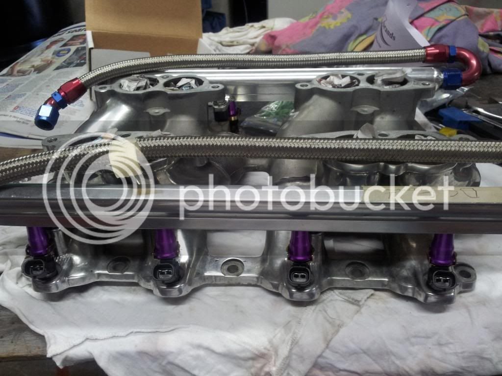

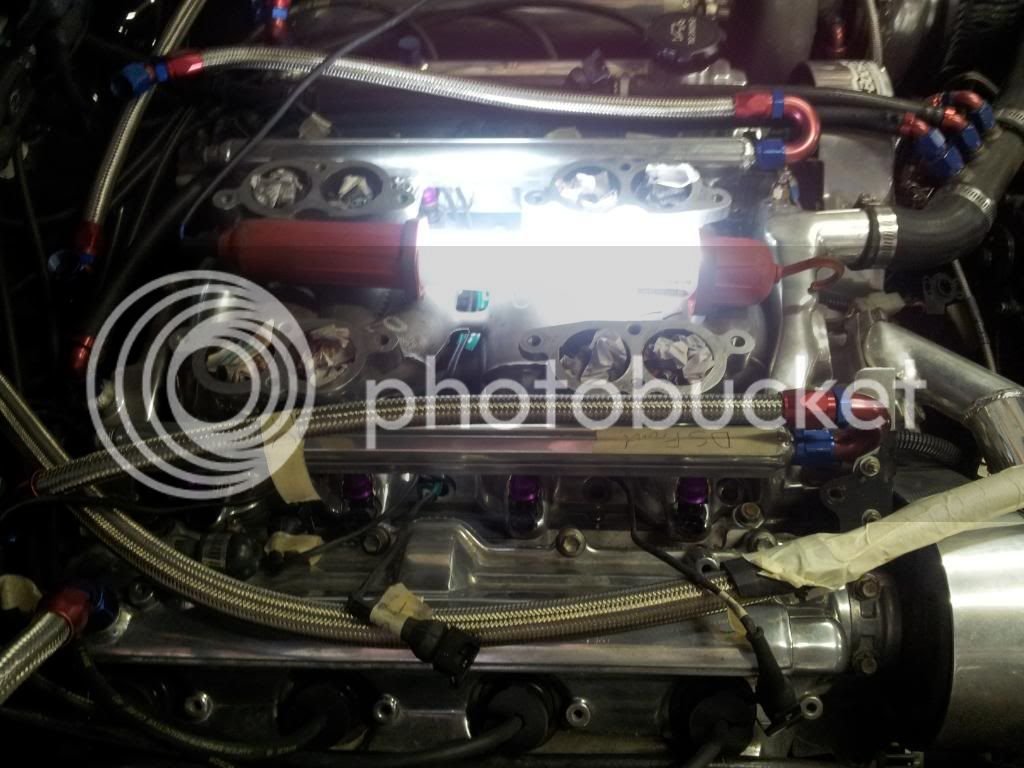

we took the manifold off to put in the new injectors, unfortunately, the new injectors we got off a mate (fortunately, didn't pay just got to try) the adapter was about 5-6mm too big and wouldn't fit into the fuel rails properly it would hit the plenum. fortunately Northmead Auto Centre had a set of ID2000 in stock, so were were able to grab a set of them to use. they fitted in perfectly.

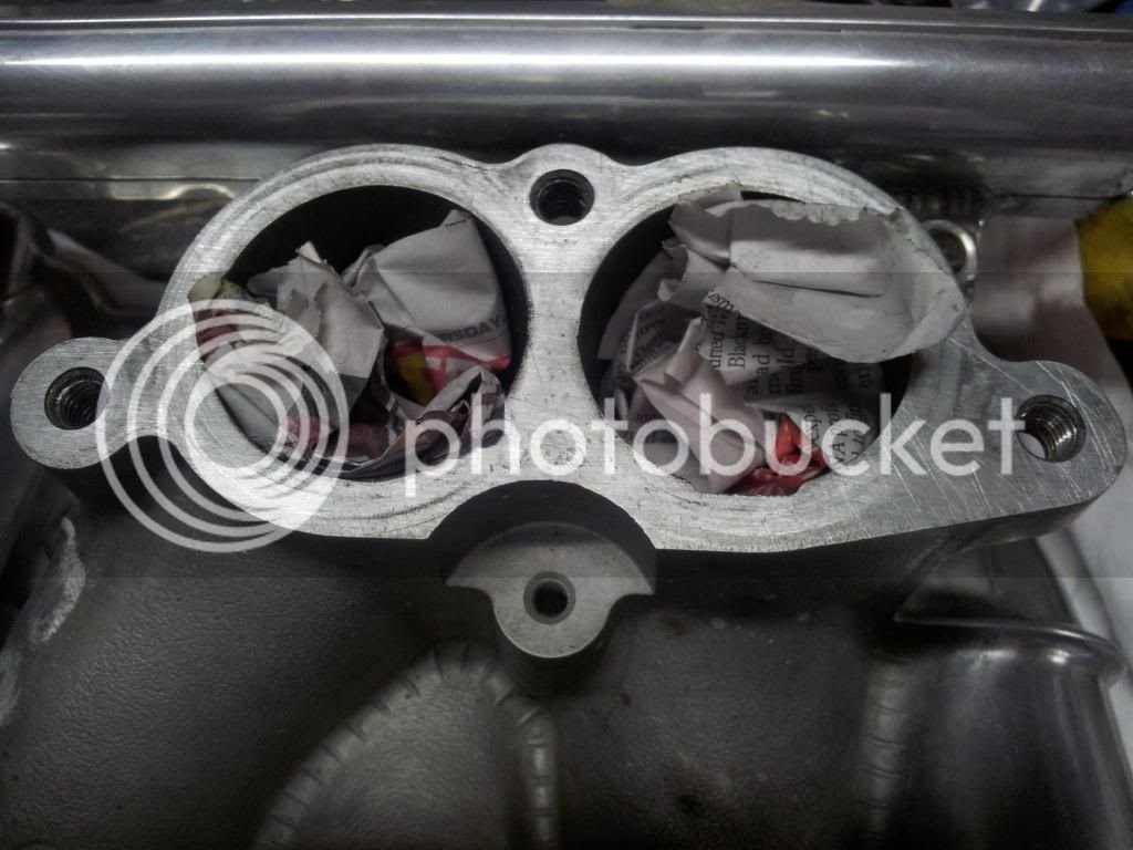

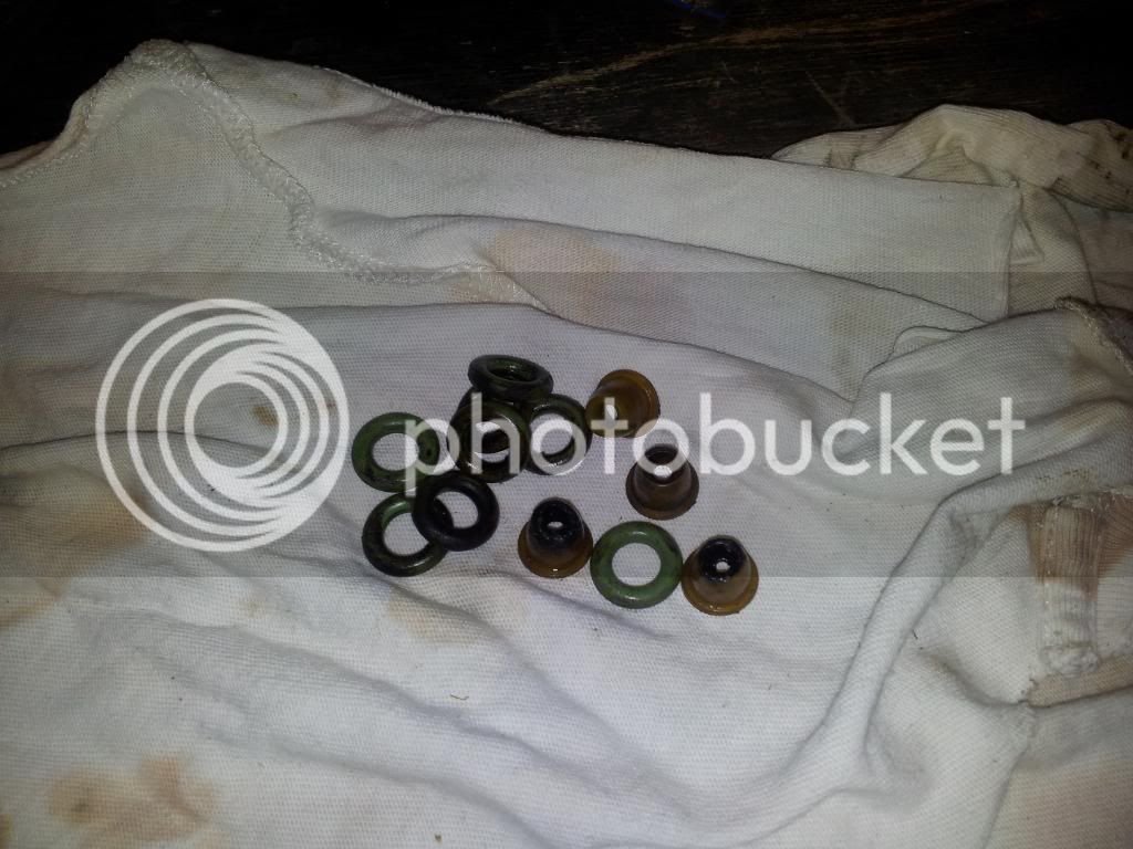

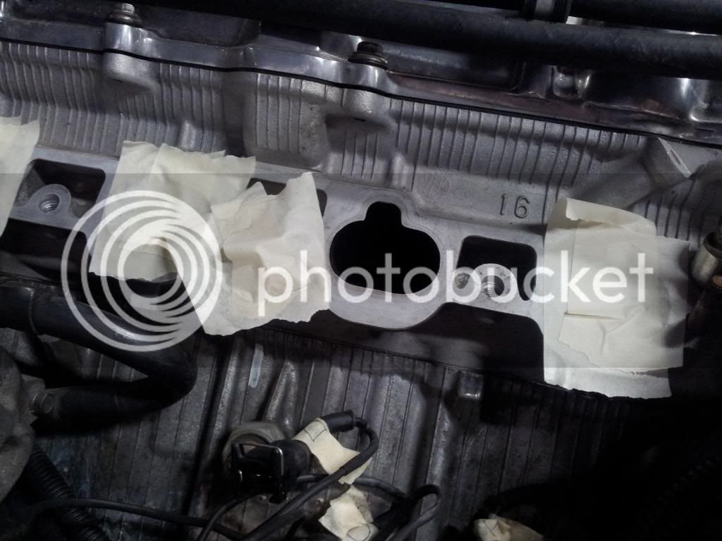

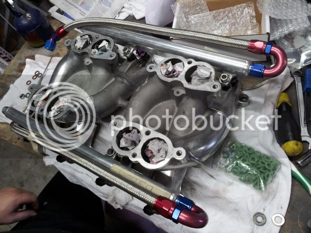

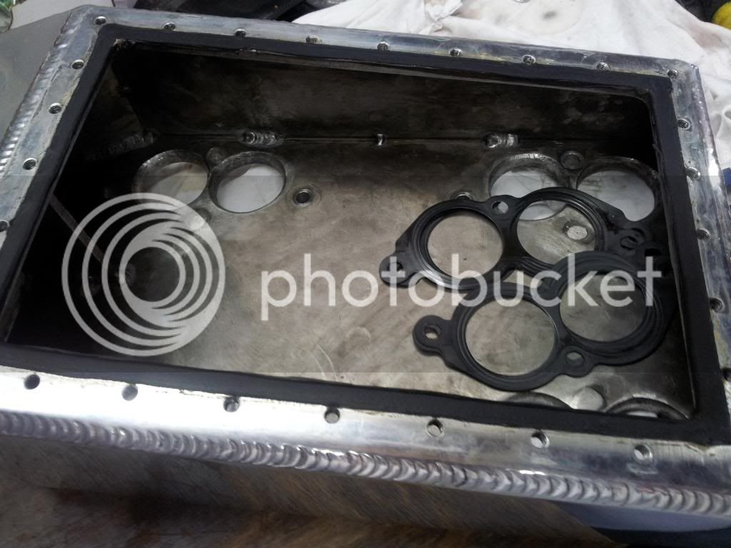

what we were shocked to find was that the injectors had made their way thru the manifold. they had been sucked thru somehow, 3 injectors were missing the cap and 4 missing o-rings. they had been passed thru the engine at sometime :knock: so it was drawing air in from the outside along with the fuel. the injectors were all gunked up as you can see in the pic below.

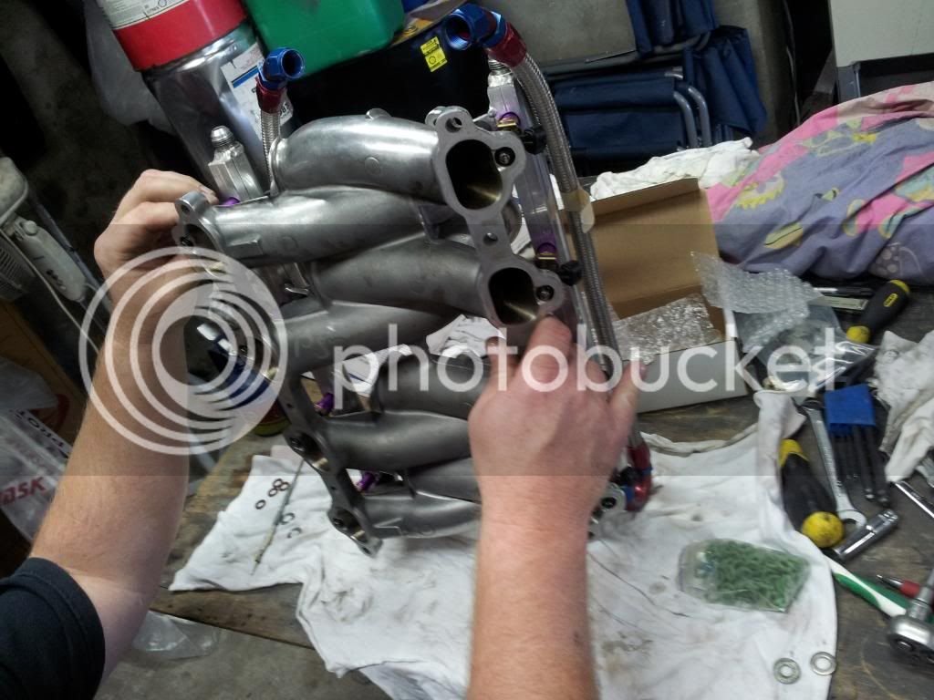

up close and personal into the manifold etc, factory lower manifold has proven awesome, we hear some people have troubles with them, but, seems to work for us. has been good so far for 1150hp@30psi on E85. just very basic setup, we have some idea's with the new engine and intake manifold which should improve it a bit
intake port
some fancy plenum with all the bell's and whistles? nope

new setup should be better, we have some interesting idea's brewing. this engine is pretty good, but, there is plenty of places more HP can be found. more efficient manifold design could pickup 50hp+ who knows. just gotta watch out for the engine trying to eat injectors :p

Who has had trouble with the lower manifold? The only issue i'm aware of is that you will make more power once you have improved it ;)
Of course that's just speculation until you do it :P
we are gonna take the car back in to Vince's today get the injectors done and run it up. we have Jamboree on Saturday and then Vince has a dyno day on the Sunday was over 80 cars last year!
there is definitely power to be made with a different intake manifold we have been discussing a few designs. the new engine is going to be a bit more special than this one, we are expecting it to be much more efficient.
don't think Joe would ever spend $4k+ on a Hogan's one like i have :p would probably work as we are both spinning ours to about 8000rpm so the runner length is good. much shorter than the factory ones, i think that is around 12'' so the hp would be down a little.

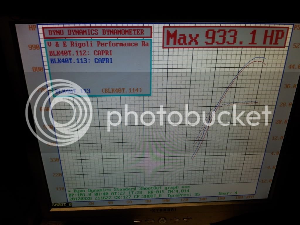

back from V&E Rigoli, we went down this time with dyno compatible tyres :p and had Vince re-tune the car with the new ID2000 injectors, and needless to say we are very happy. Vince had the tune done nice and quick, the old girl is showing more power than ever before and drives better than ever ;)
as said previously we were still on the United E85 so we weren't expecting too much, last time the car ran 8.28@167 she was showing around 800rwhp (600rwkw) tonight she knocked up 933rwhp (695rwkw), the boost was around 30-31psi, we are not sure if the turbo's are out or the wastegate springs can't hold the gate shut with anymore boost. we weren't expecting anywhere near that power, we checked the data input twice to make sure all the numbers were right and it was all good. in the workshop it was 27C, 1010 barometric pressure and humidity was around 40%.
it would be hard to credit a 100rwhp gain on the ID2000's alone. we think possibly there was some long term issue that we have now fixed without even knowing it :)

912rwhp & 933rwhp dyno graph. pretty much same boost and AFR, just a degree or 2 more timing and it picked up 20rwhp
Jebus! You guys have got to be happy with that. No matter how the power was gained. Fingers crossed it shows the improved numbers on the blacktop dyno too.
