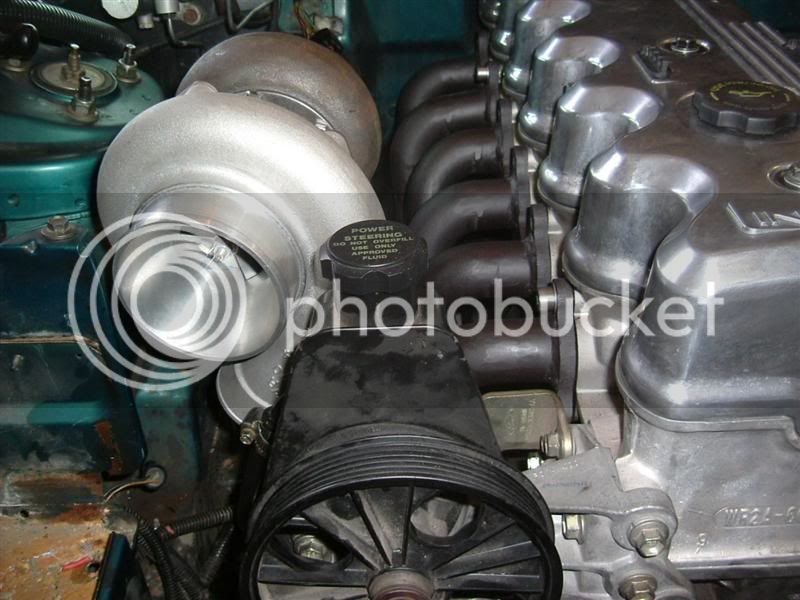

Yeah I got the old TA45S HKS turbo, got one second hand for USD400. I guess you dont really need the new technology ball bearing turbos to make the power, you just need a big ass turbo, a journal bearing old truck turbo like the TA45S means cheap to rebuild, and it still made 500WHP on 16psi on my unopened motor and stock Supra IC.

That's right. I don't see the need for ball bearing turbo if the turbo is matched with power that you use. Turbo sizing is important. If it isn't matched, then a big ball bearing turbo will still create lag..... I guess you dont really need the new technology ball bearing turbos to make the power, you just need a big ass turbo, a journal bearing old truck turbo like the TA45S means cheap to rebuild, and it still made 500WHP on 16psi on my unopened motor and stock Supra IC.
