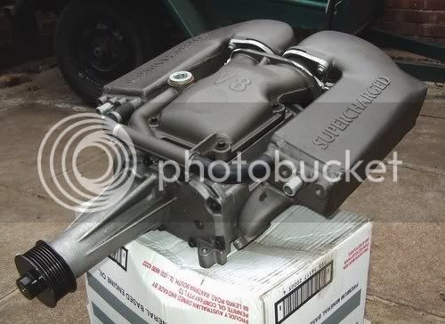

Ok, so attempt number 2 will be the m112, where will the air to water intercoolers go, in respect to the supercharger, underneath of it, or in between the turbos and the charger inlet?
theoretically the SC souldn't cause any top end restriction.....it does feel like it though so need dyno run to confirm.
M112 is alot more work but if dyno is encouraging then Mark II will be a M112 with twin a/w ICs.
The M90 comes with a CF manifold so a dead easy fit. I just made the rear SC plenum and a 5psi SC pulley
Neither :) I'm using the Jag XKR M112 which is inverted with the a/w IC sitting alongside the SC over the fuel rails...pics of the SC setup are on here somewhere.
Cool eh :)

did you make the carbon fibre inlet manifold yourself? If not who made it?
I can't find any photos of it on here. Can you post some photos of it?
