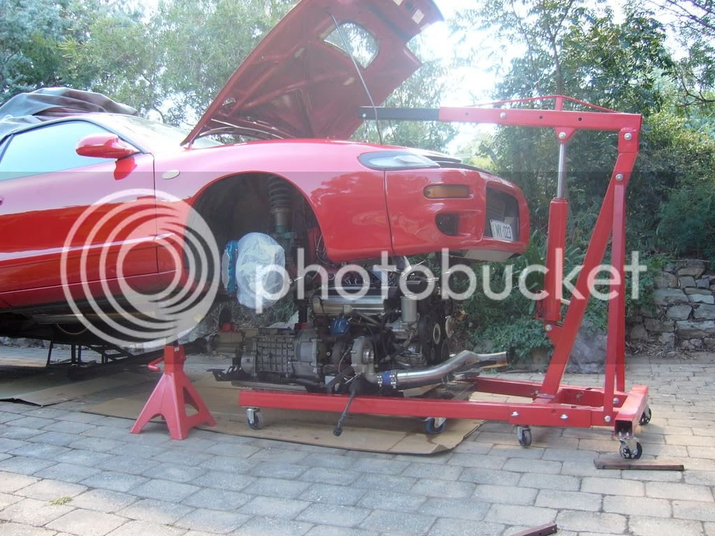

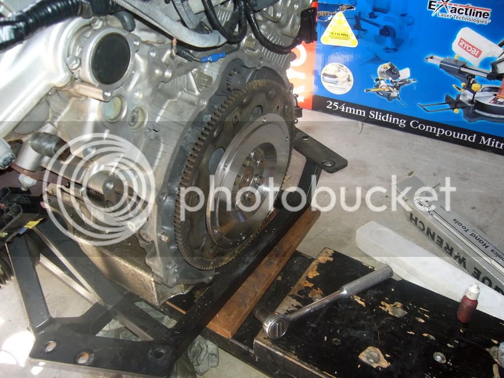

Engine and box extracted...got a few jobs to do ;)
and this shot will give you an idea of why i dread an engine pull :)
Looking awesome.

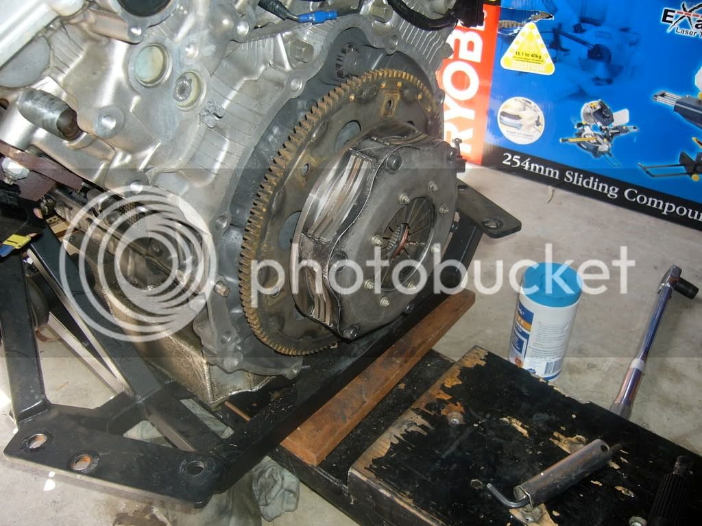

I swear you wont believe how qucik the 1UZ revs with a flywheel that size. You can actually feel very noticable engine braking just on the decel.
More engine braking will be a plus for the track.
Engine is back in and clutch works fine. Had to m,ake up ,a longer slave cyl rod so will have to try and m,ove the pivot out at som,e stage as a better solution.

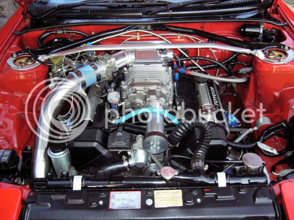

Fitted up the M90 SC and bonnet clears by heaps. Looks like a M112 would fit easy as well on a richwood manifold...hmmm.
Pics some time over the weekend.

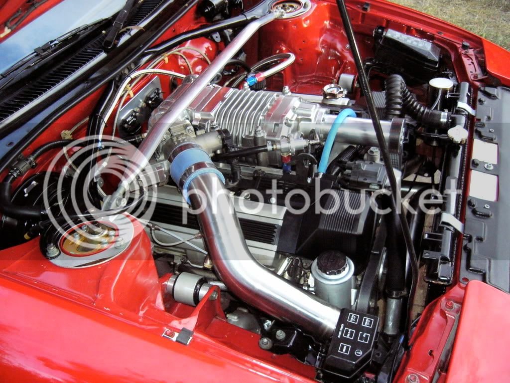

Here you go Lextremers, the world's 1st (i believe) twin turbo AND supercharged 1UZ :D

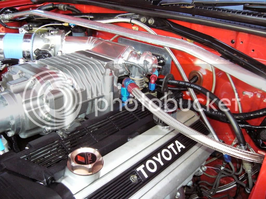

A closer look at the intake side
and my novel solution to the bypass valve....a simple (and cheap) BOV
no dyno results as yet as a few issues meant i finished too late to get there before heading off to the Toyota Nationals.....hope to have it dynoed soon though
