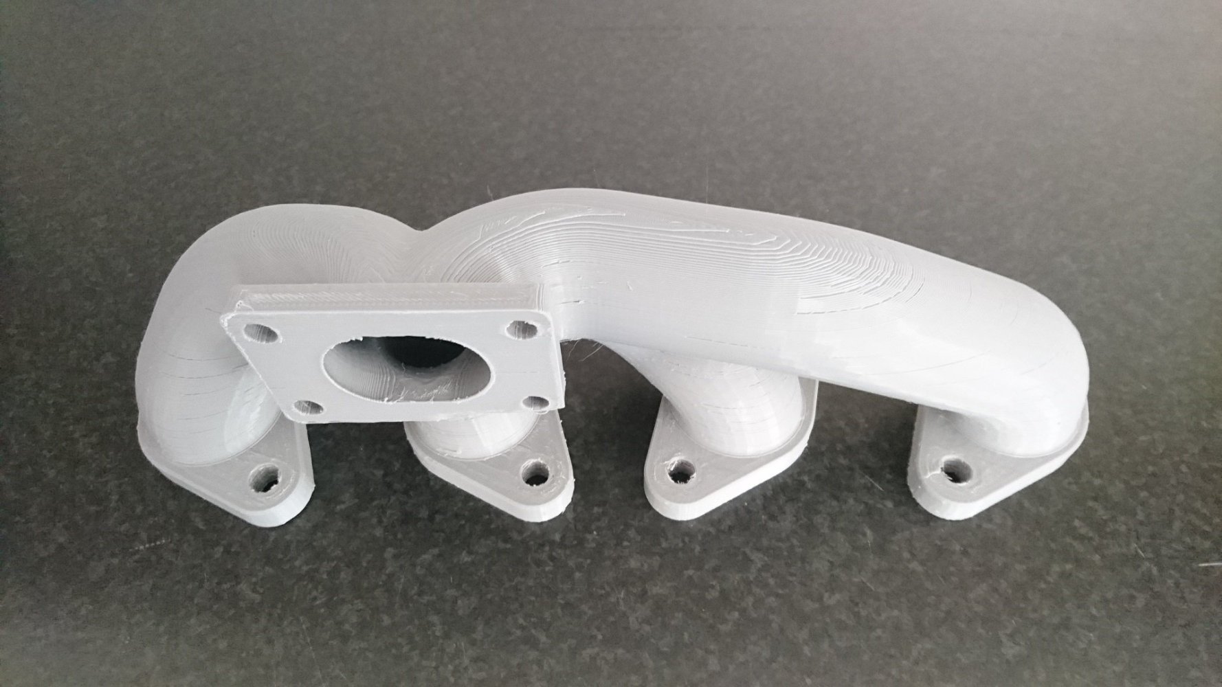

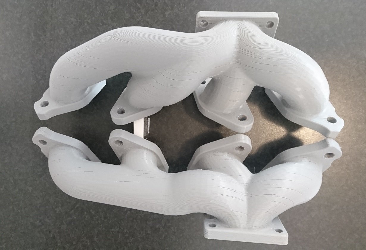

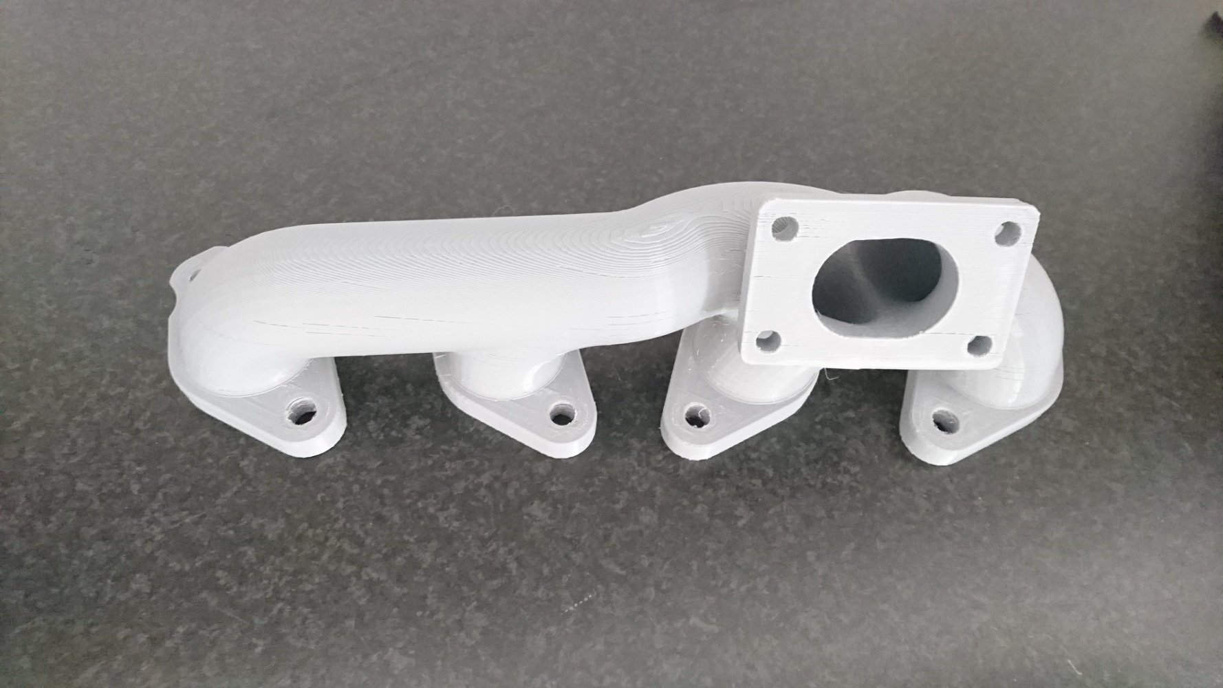

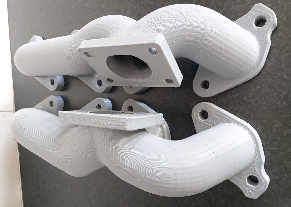

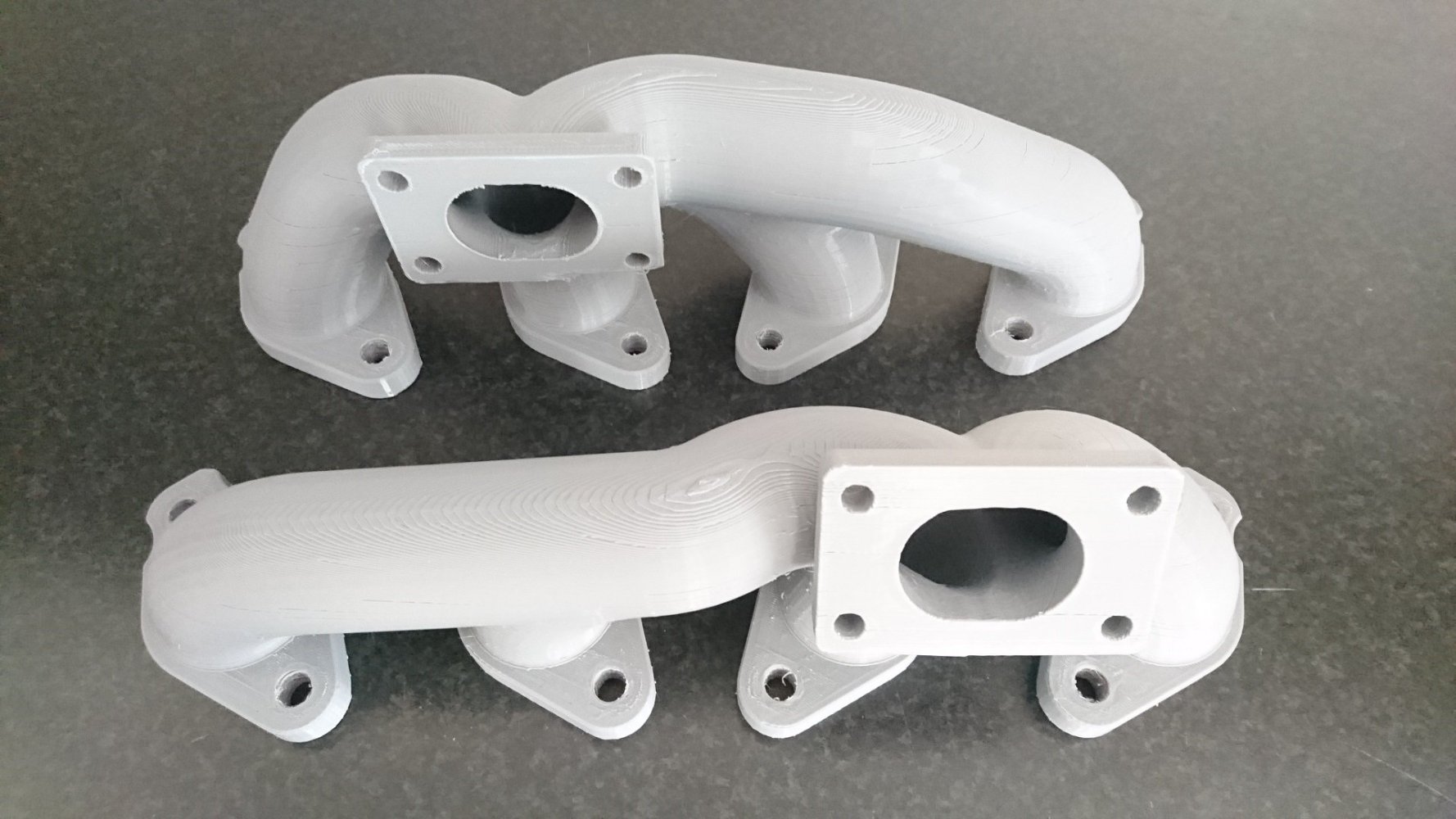

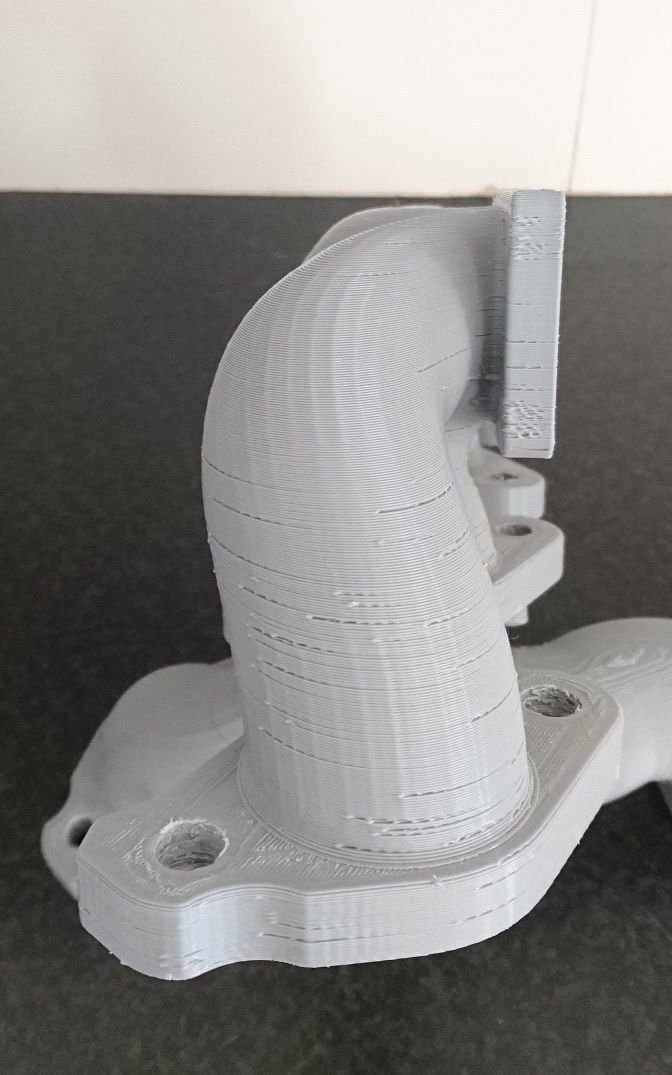

I have tested some early 3D printed versions of the manifolds in his kit car and they are as a
tight fit as I can make them, there is no space in that engine room!

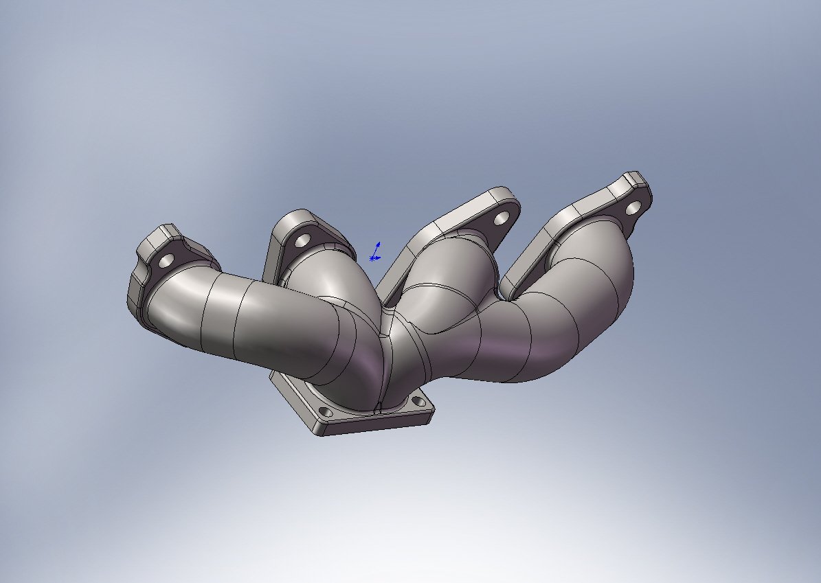

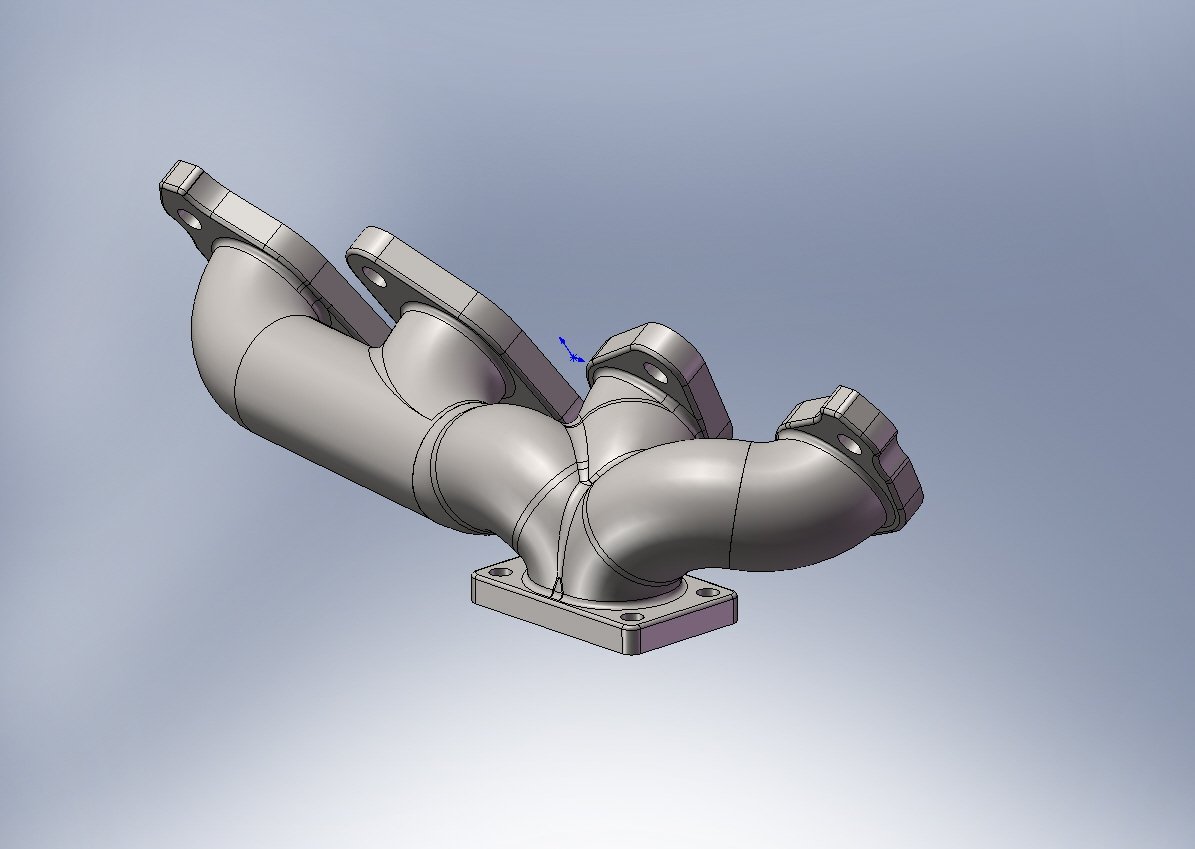

The design of the right side manifold is done. There is still some work to do on the left side
manifold.
The center of the left T25 turbo flange is placed 80 mm behind the center of cylinder 2 and 3,
the center of the right T25 turbo flange is placed 59 mm behind the center of cylinder 2 and 3,
this is done to compensate for the 21 mm offset between the sides.
It also places the turbos symmetrical VS the block and the engine mount flanges.

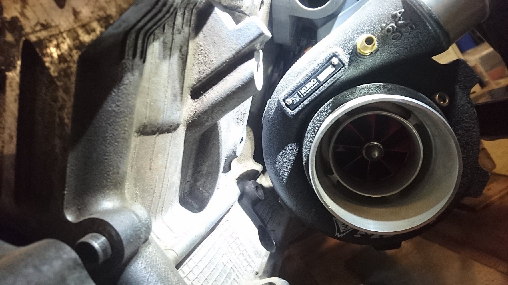

I looked into placing the turbos in the center between cylinder 2 and 3, but the outside of the
compressor housing comes into conflict with the engine mount flanges on the block.
The two turbos we have tested is Garrett GTX2867R clones, with T25 inlet flange and integrated
wastegate.
I think Mitsubishi TD04HL-19T turbos should fit, it looks like they are slightly smaller than the
Garrett ones.
The alloy will be EN-GJSA-XNi22/S-Ni22/S-Ni22 cast steel alloy, an alloy often used for turbo
turbine housings.
manifold.
wastegate.
