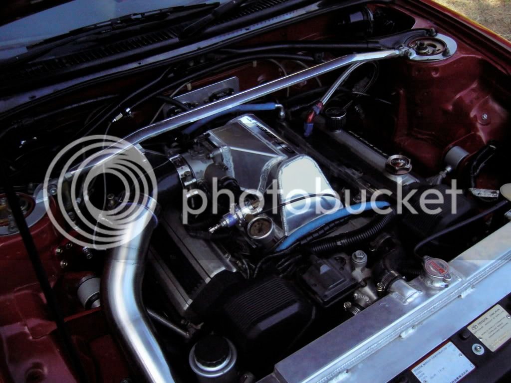

Hey Justin did you ever get yours dyno'ed with the custom lower intake?
and any progress on a new better one?
"Results were very impressive bottom and mid range. We had some issues on the dyno so top end results were a bit meaningless. At the drags i picked up approx 5mph top end so plug that into a drag calc and it suggests a good power gain. Throttle response was also greatly improved.
From my end all good. It's sold now so no further testing but MKII is in the works ;-)

I forgot the conversion to rwhp, but 10 psi with 333 rwkw is very impressive. Did you advance the timing a lot?....The new manifold was flowing so well i needed a tune. On 2 psi *less* boost and a richer/safer tune we made an extra 18rwkwSo, on a measly 10psi the car is making 333rwkw. This is on my 'test' dyno
I'll keep it in this state for the next 3 events and then think about whether i both with the ITB setup when i move to E85.
My car was dynoed on a Dyno Jet and it uses a standalone AEM from the Supra MKIV TT. I had it rewired to work with the stock harness and tuned by a pro.It depends alot on the turbo of course as all boosts aren't equalBut seeing i have 450rwhp on 10psi, it does seem a bit strange you are that much down on hp with more boost? and a dyno jet dyno as well i'm guessing which read higher than the dyno-dynamics my run was performed on?
