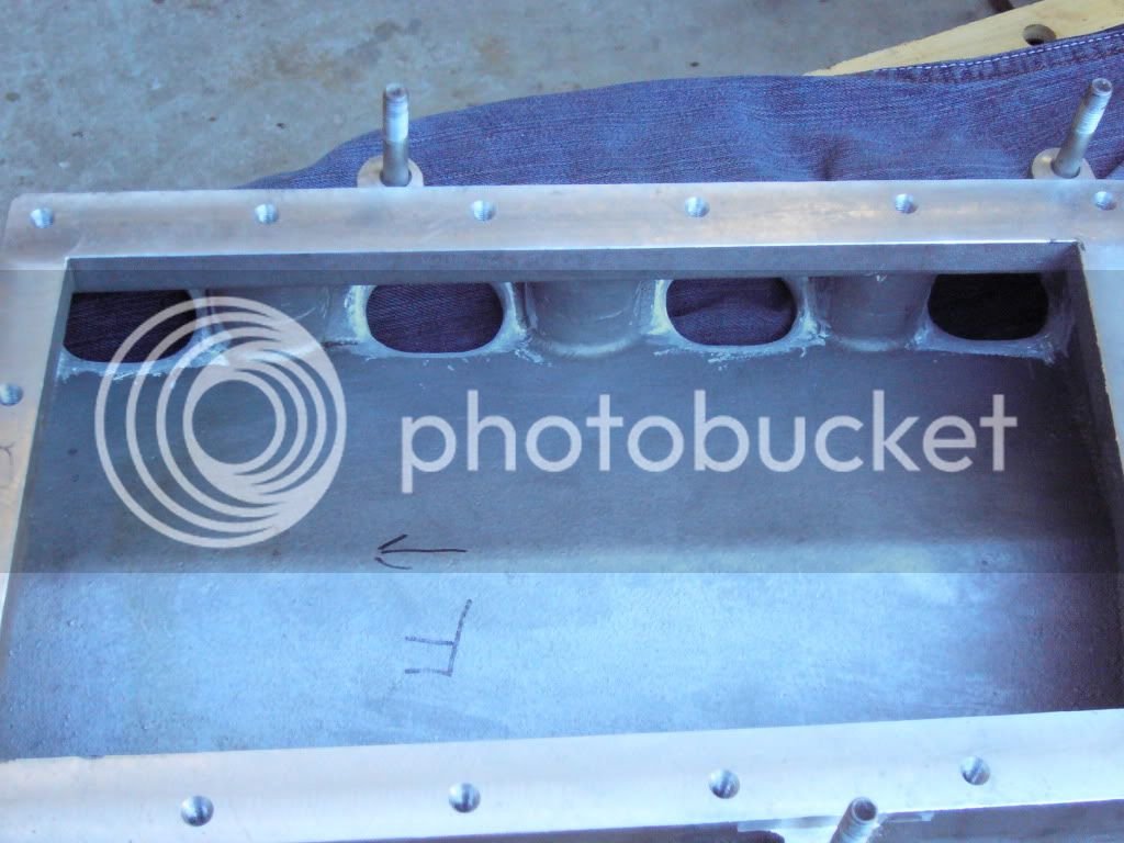

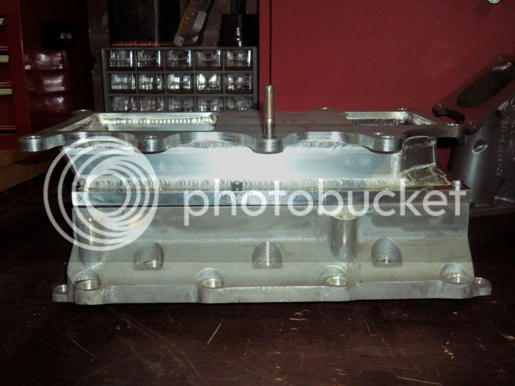

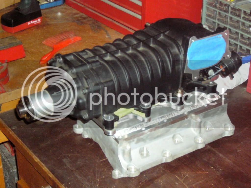

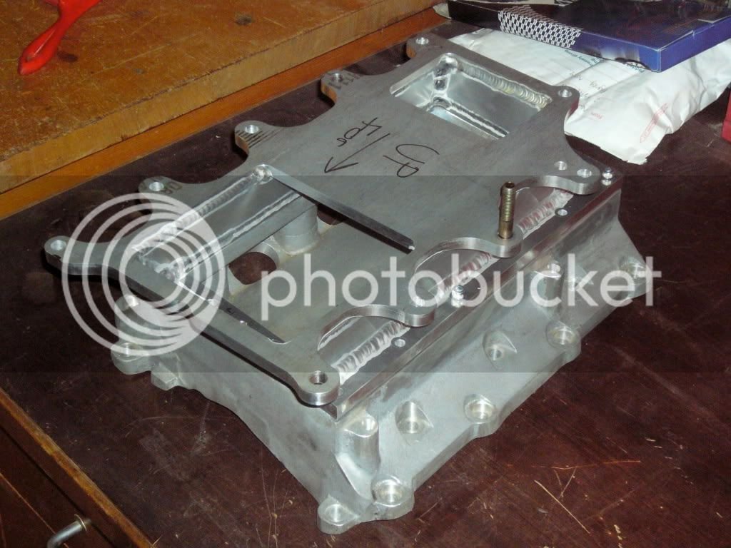

OK, so what's up your sleeve with that top adapter assembly? The front port I get, and the rear port sorta looks like it's for the bypass, but do you think it's big enough?Jeez, you could nearly fall in!
Are you putting a W2A core in that adapter, or in the manifold?
Methinks maybe this will be another twincharge setup? That's the reason for the, ahem, whopper of a bypass port?

If you could lift the supercharger up and put a flat plate under the discharge to force the air to to turn 90degrees then flow down into the manifold it would improve things a lot.
I liked Scotturnot's baffle plate idea from last year, and may try to do something similar before the next test.

Got a link to the baffle plate idea? i don't recall that
