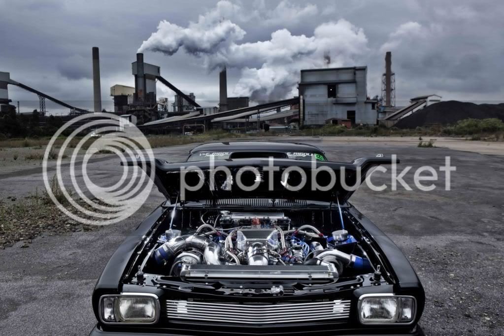

I must agree, beautiful pic and beautiful job and the car as well, hope to see you guys hit the 7's real soon, keep up the great work!
thanks, definitely working on 7's. hoping for sooner rather than later.

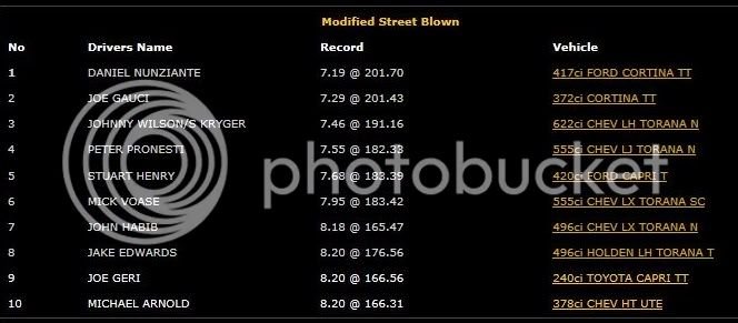

we are honoured and happy to be back in the APSA Top 10 Modified Street Blown cars in the country, sitting at number 9. the 240ci sits up there proudly with all the big cube turbo and NOS cars.

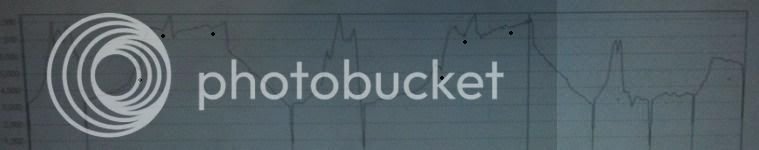

found an issue on the RPM logs last night. car is not revving right, its plateauing about 7500rpm, then dropping then picking back up again. we think its either the gearbox or converter. nothing else has changed apart from that. new box and we had the converter serviced after we lost the old box.
here's a pic, first dot is on the 2-step. 1st log 8.20 pass, 2nd log is the 8.27 pass it gets bad there because of all the popping.
You're running more boost with new tune ??
I would suspect valve springs boost holding
valves open...
Are the buckets still shim over ??
I don't really want to go that fast just consistent !!
Mind you a few years you guys possibly thought the same??
Big potential for our project then .. Ha ??
