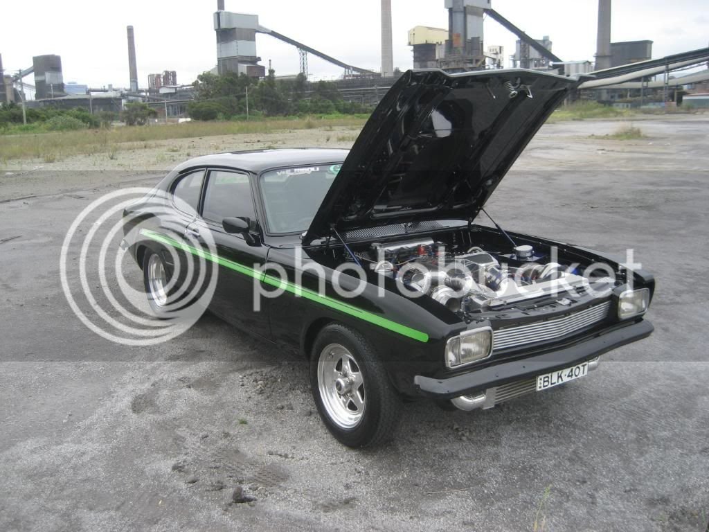

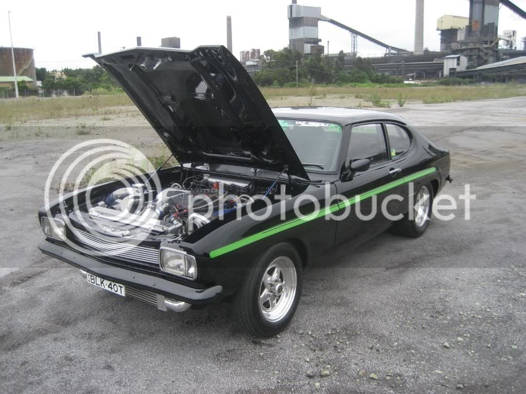

lil bit of an update, we did a photo shoot for Street Machine yesterday, we had been approached by them for a while but we didn't want to do anything until the car had proven itself, we thought it was time. we took the car down to Wollongong as they wanted the coal terminal as a backdrop, we found an old abandoned site. fortunately it was an overcast day which made taking photo's of a black car easier. the photgrapher Thomas was a real nice guy made the shoot nice n easy, he said the pictures are gonna look really good, he was very happy with them. he went for a drive in the car, was only on it's pump gas tune (700rwhp) but he left with a smile on his face. also big thanks to Steve from Peck's Towing, we were going to drive her down but Steve came along so we threw her on the back of the tow truck. here's a couple pics i took, far from professional

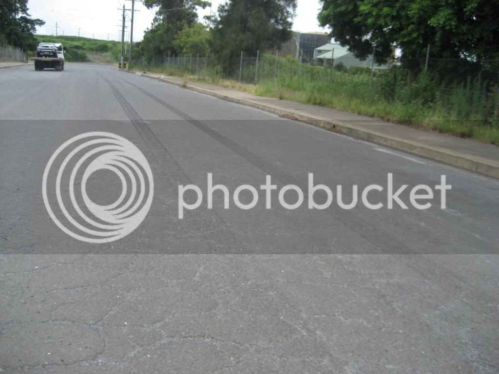

some nawty person left a powerskid

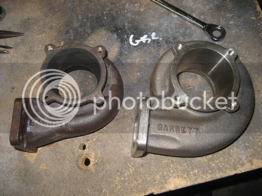

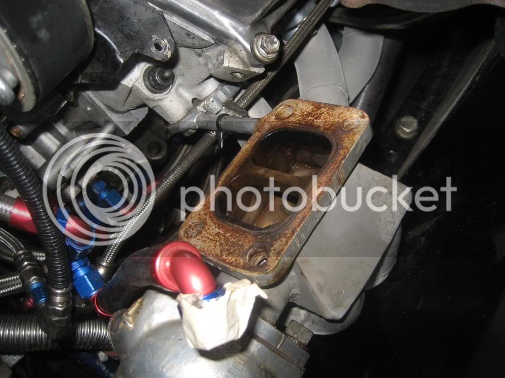

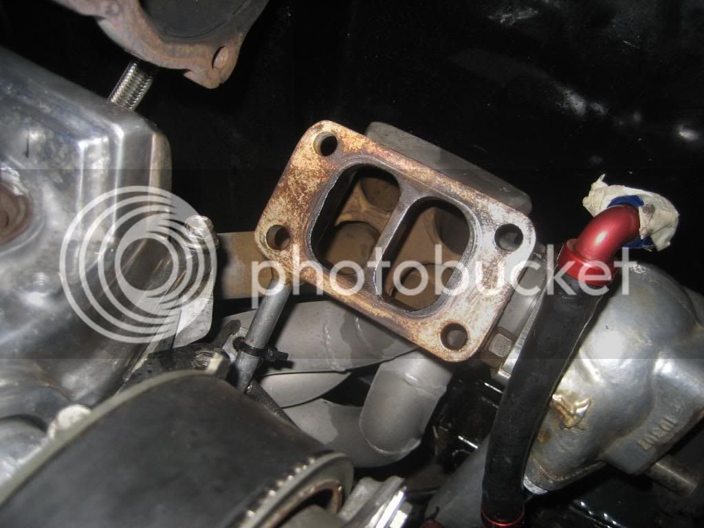

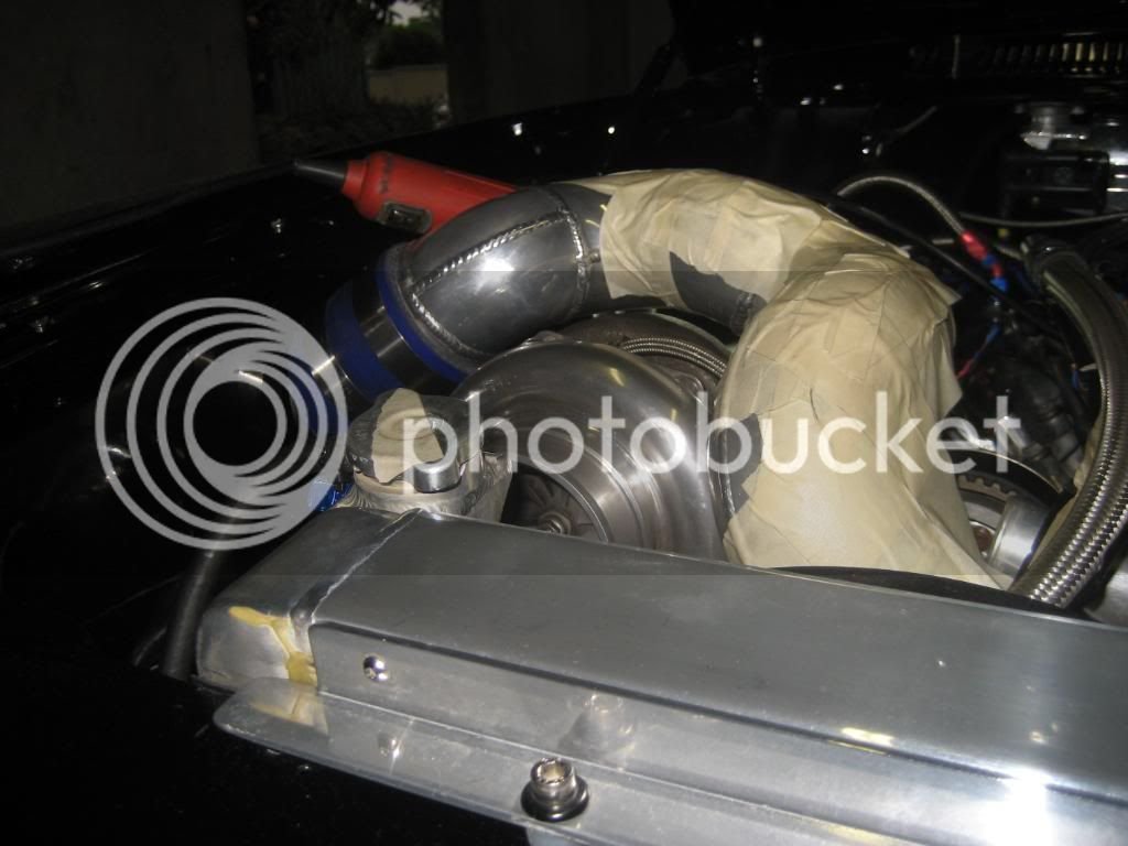

Project Seven or Project Beat John (our other brother run's 8.0@174 in his 2JZ Corolla) continued today, we are stepping it up. Joe needs to go a little faster, he is a bit bored with 8.3's so we have stepped up the rear housing we went from .63 to a 1.06, with these housing each turbo should be good for 700hp each, we were maxxing out the .62's, 1060hp at the engine. with these turbo's we are hoping to see a 30-50hp gain just by the bigger housings, we hope squeezing in another 5psi (30psi total) on the E85 will give us the extra 100hp that we need. going off the calculators we need 1200hp to just break into the 7's. we changed the housings today, because the housings are larged it just misses off the intake pipe. though we are going to change that so there is more clearance. car is back into Rigoli's this week, he will put in a new EMS CDI, the extra spark should help with the E85. we also need to setup the boost solenoid, the boost will sit at around 18psi while we are at the lights staging, soon as the transbrake comes off then the rest of the boost will come in. hopefully on the weekend she will be re-tuned.
