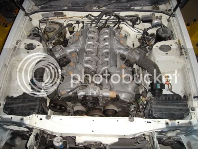

Yes I'm still alive, project is moving along a bit more.
Manifolds being built for stock throttles ATM, when they are complete I'll put up pics.

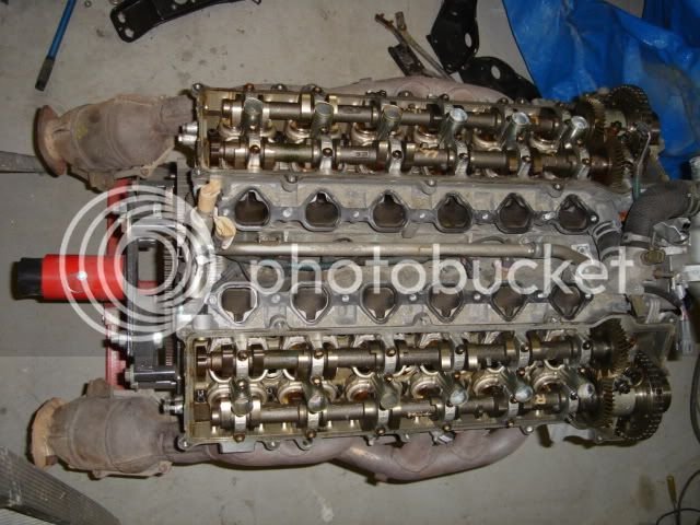

Opened up the spare engine looking to see how hard to do itb's for after the car is road legal.
Been doing a lot stuff but not a much on the car, getting some stuff sent over from Japan.
No, I'm not likely to buy another and they have been coming up on the auctions.

I do have my bell and manuals from Japan.
Sweet fit! Looks like Toyota intended it that way.
Got enough room for the big radiator & fans?
Really glad to see this happening, and I am sooooo envious :)
