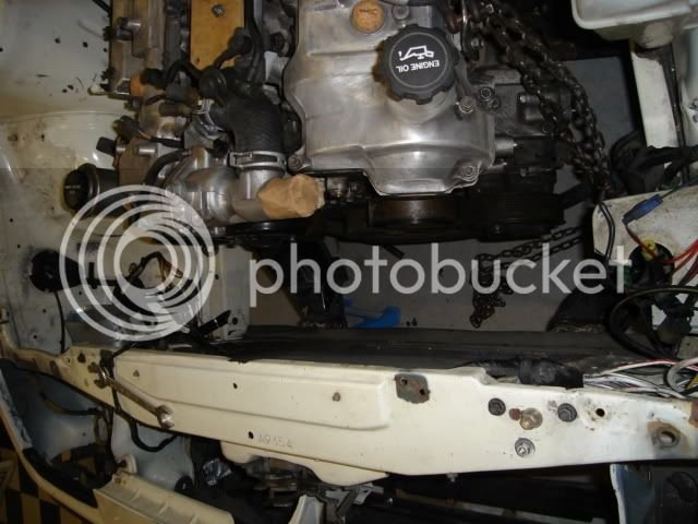

Cut some big holes to allow engine to go back as far as possible but there will still be some clearance problems with the swaybar, so the mounts for that will have to be altered.

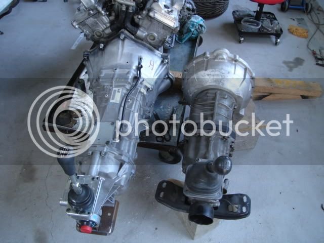

And a gearbox pic just because I have one

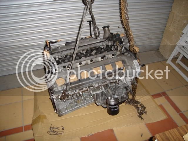

This engine was stripped bare but does have a loom and intake manifolds.
(Oooh, it does have engine cover with a big fat V12 badge, like the other)
The auction said it was a "core" for parts or rebuild.
My estimation is it has a blown head gasket or a coolant related problem. ATM it can just sit in the shed, or should I take a pic of both engines together so you can believe I have 2, LOL!

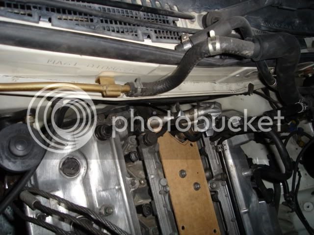

Here is some engine bay pics with motor located, little altering to do of swaybar mounts to get sump clearance.
Not a bad bit of space for headers.
