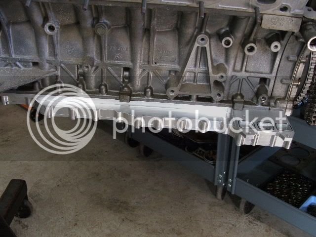

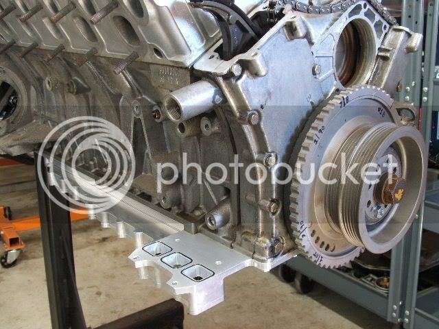

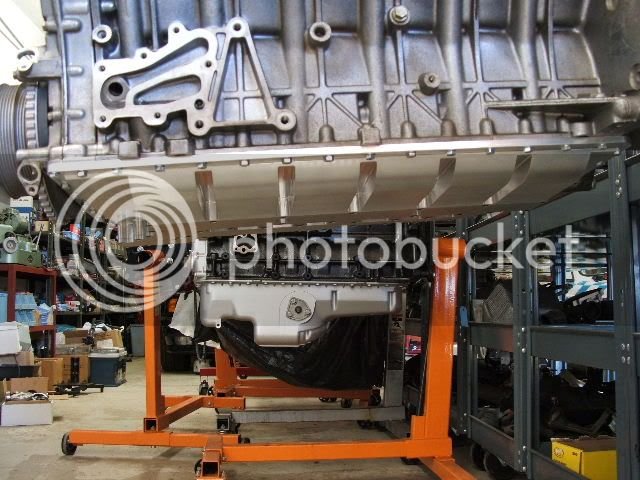

And it Fits!!!
Wow, it's almost like we knew what we were doing....... And no interferences when the engine is turned.
Next step is to get the drive pulley located on the crank dampner, then get the pump done, and we're in business......
Thanks, no I'm not personally going to commission any more of them, but anyone who wants one can purchase it direct from Bill Dailey for $1650, but he won't tool up to make only one - it would need to be at least two. Around a 3-4 week delivery also. My project was the prototype, and it cost around 1.5x that, but somebody had to pay for the design & tooling......
Nice piece John, I know you have been waiting a while for this. Almost there!
Yea..... and as the engine builder said "not to jinx anything, but there's just not much left before it's ready for the dyno."
The oil pump has to get built, once we know where the drive pulley is going to fall, and I still have to get an electric water pump, but that's an off the shelf unit, then it's just the final assembly, wiring it up and hooking up an EMS.
I was originally going to go MoTeC M800 on this, but the new AEM V2 will handle a 12 injector, 6 coil setup just fine, so in spite of my loathing for waste spark ignition systems, I'm not ready to pay a $4000 premium for true sequential.

Cheers fastegg, I'll pass these comments along to Bill Dailey who designed & built the pan. He does do very nice work for some very serious racers, not just wannabe's like me :D

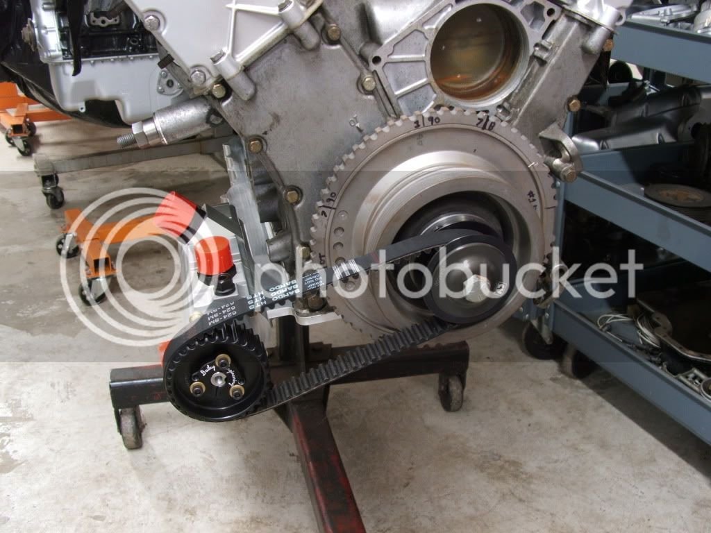

Pump fits!
So the bottom end is officially complete. Now it's just final assembly, get an EMS installed and dyno the puppy.
