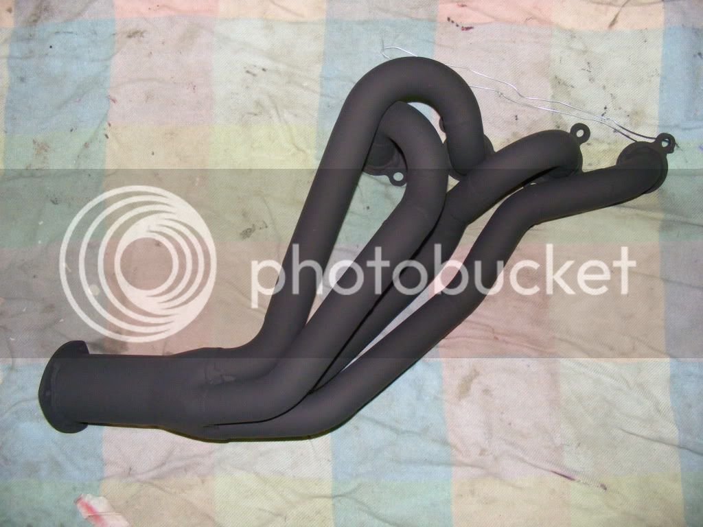

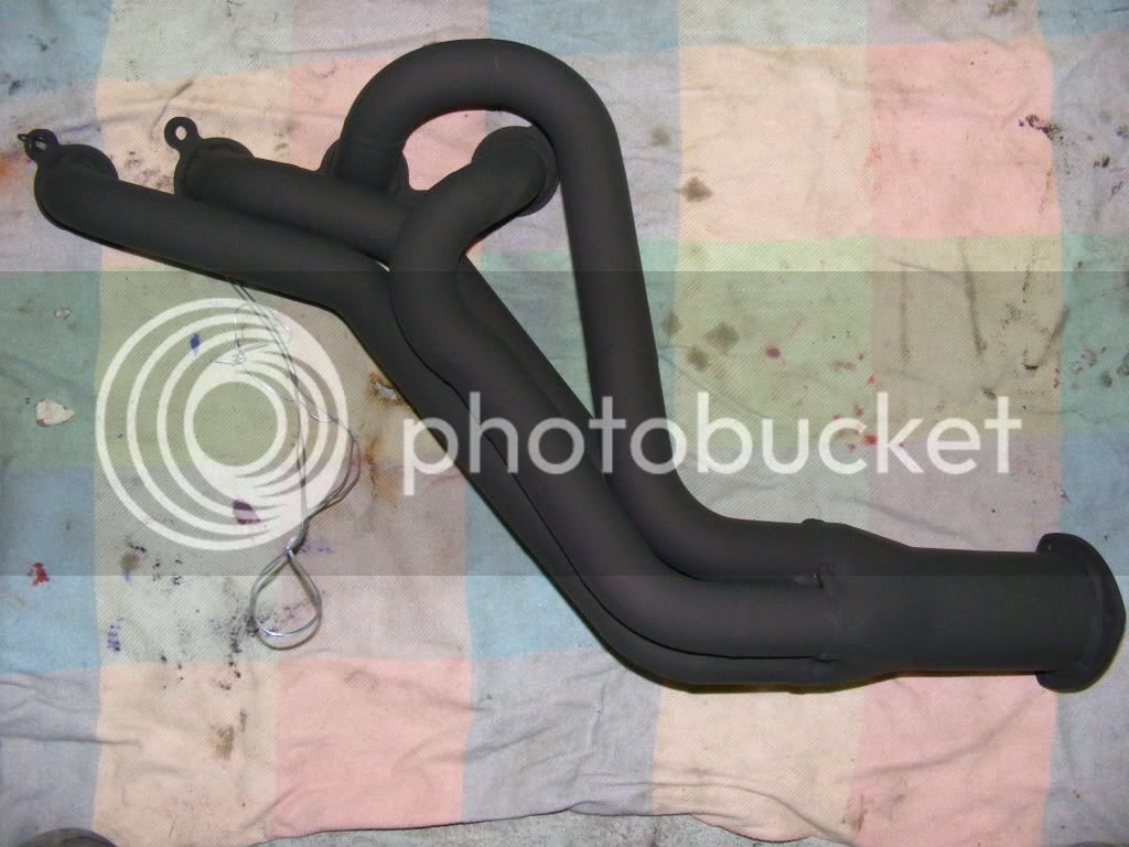

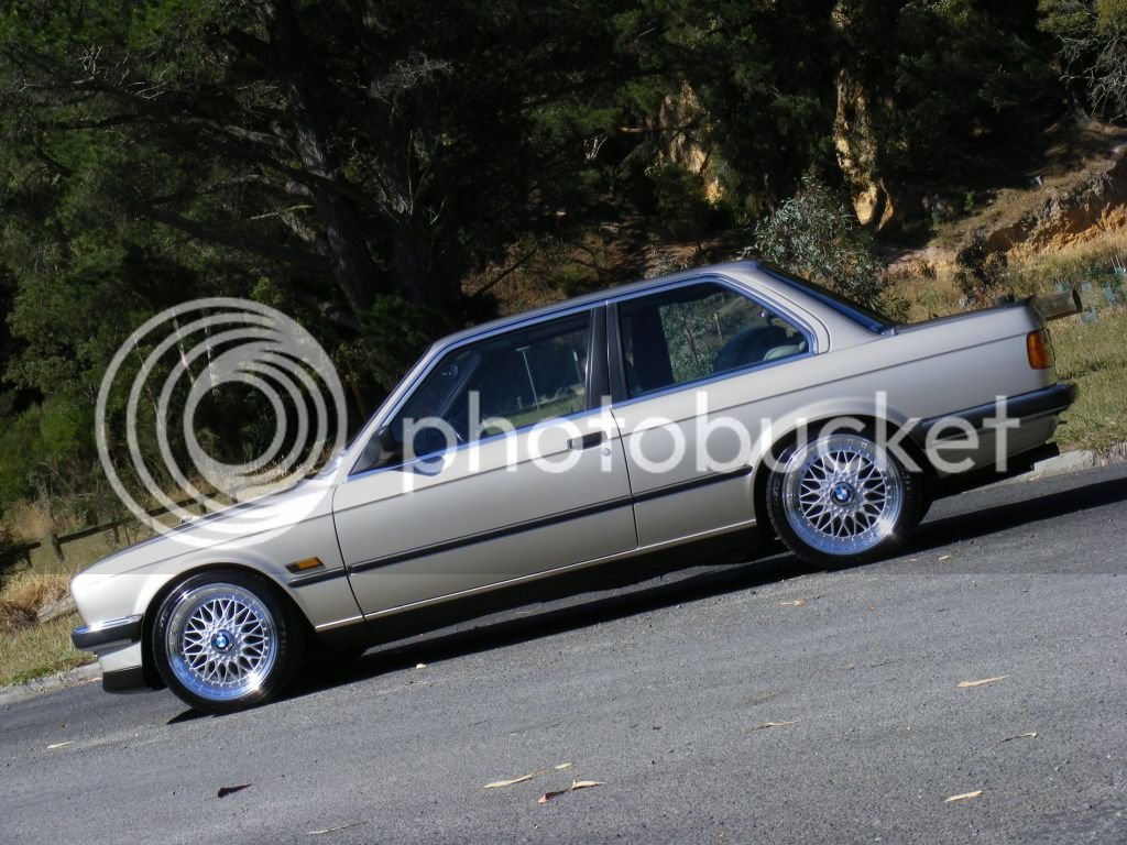

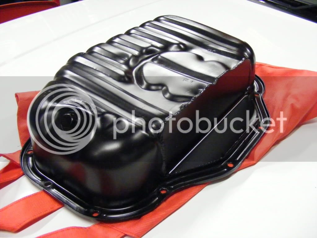

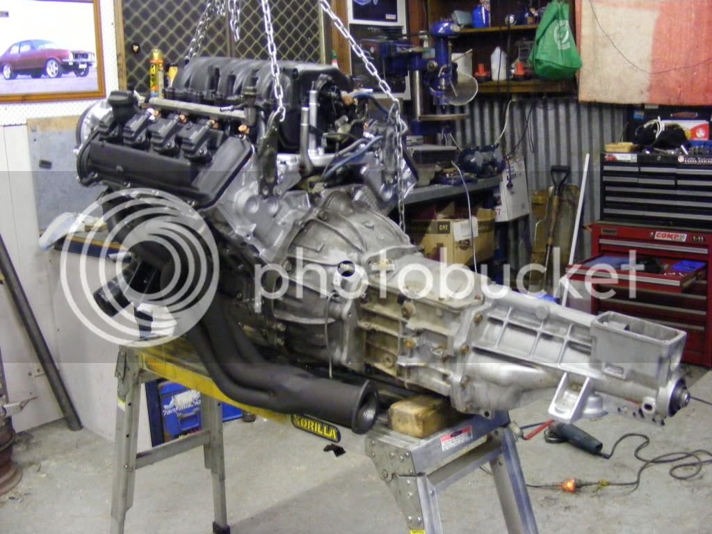

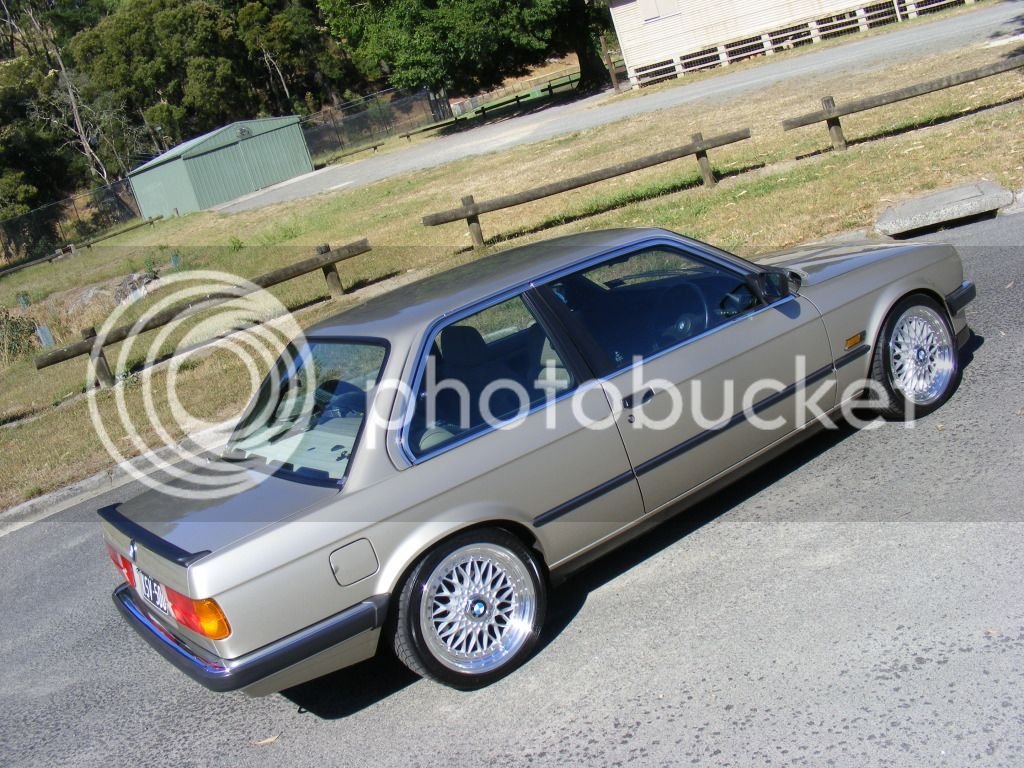

Here are some pictures from my build.
I've done all the work myself to keep costs down It is running and driving now on a linkplus G3 ecu, awesome fun, well balanced everyday car with a great sound!!

:custom made headers

Home hade custom headers

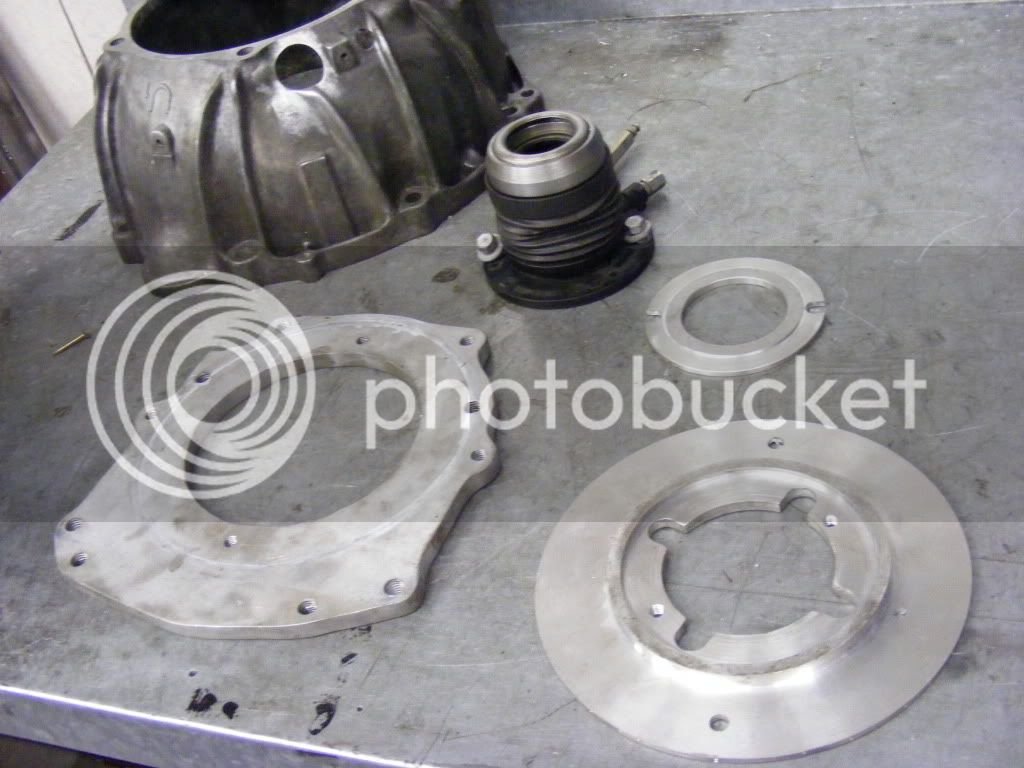

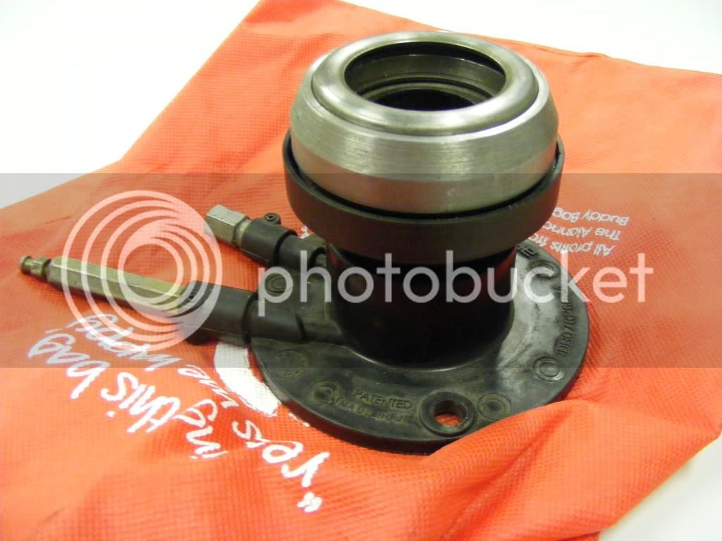

Machined adaptor/spacer ring for unit slave cylinder/thrust bearing
Modified sump
Gearbox adaptor parts
Trans/Engine/Extractors all together

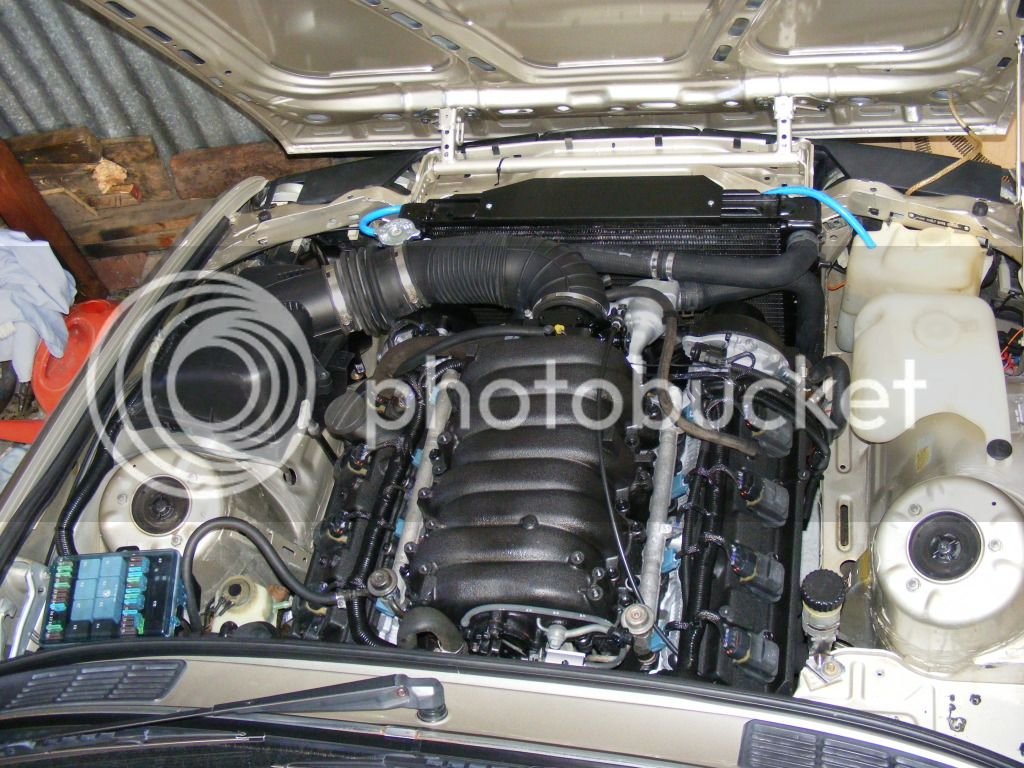

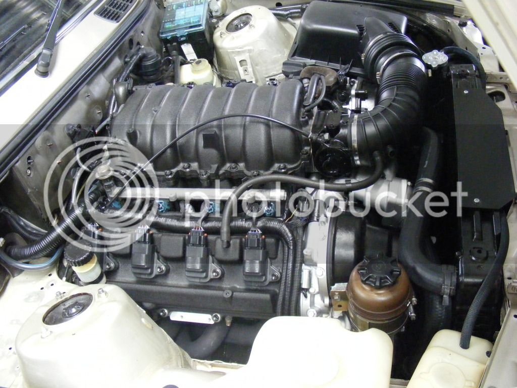

Engine bay almost complete, just a few things to finish off and paint.
The car
Very nice job, that would go very well indeed.
Pitty your in Australia, would have been good to have a gander!
I like the way you painted the manifold and cam covers.
I've always been annoyed at the way the VVTi engines looked as stock, but yours shows they can be made quite presentable! Good job.
Hah, I see we have both used BMW ZF power steering tanks. I have one from an old 535i that is now the reservoir for the hydraulic 1UZ engine fan.
