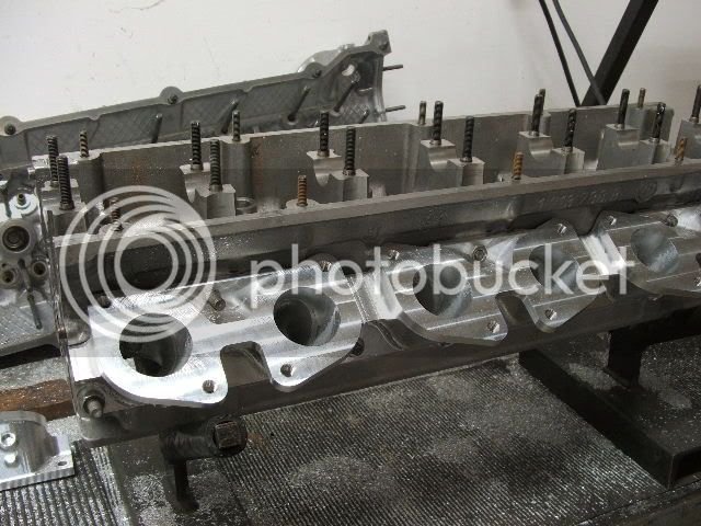

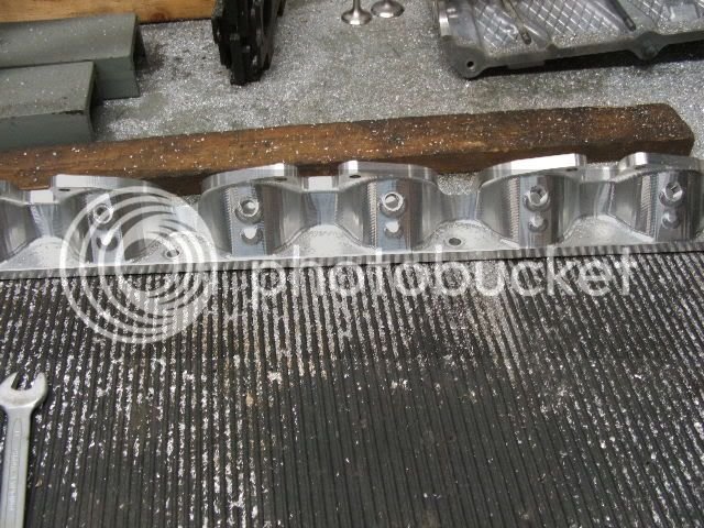

Here's some progress pics. These are the billet adapter/intakes for the TWM ITB's. This is before polishing and port matching:

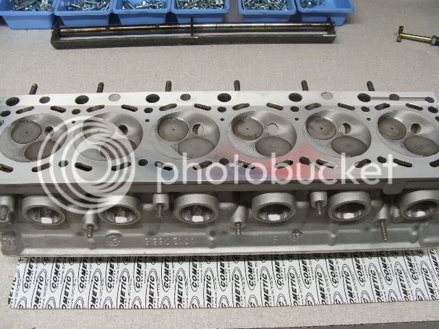

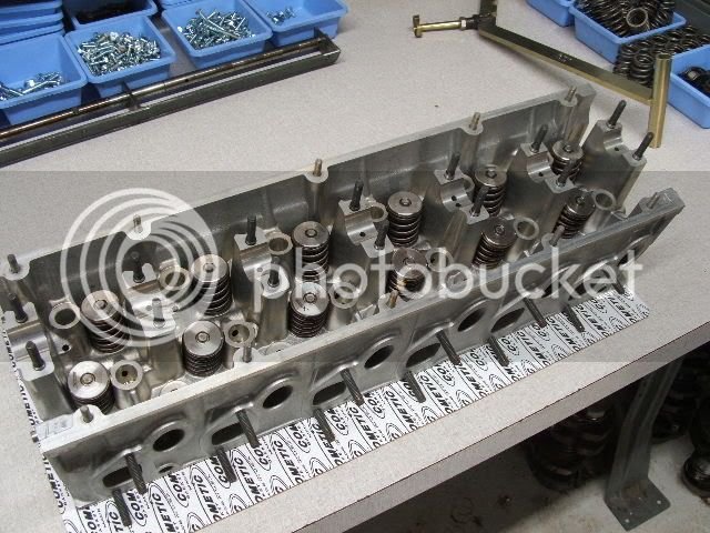

No, it's certainly not gorgeous like a Ferrari motor, but attractive in its own Teutonic way.
Compared to the four valve pentroof chambers we all know & love, those two valve hemi chambers, really do look ancient don't they?
nice work on the manifolds John. What are the holes next to the exhaust ports?

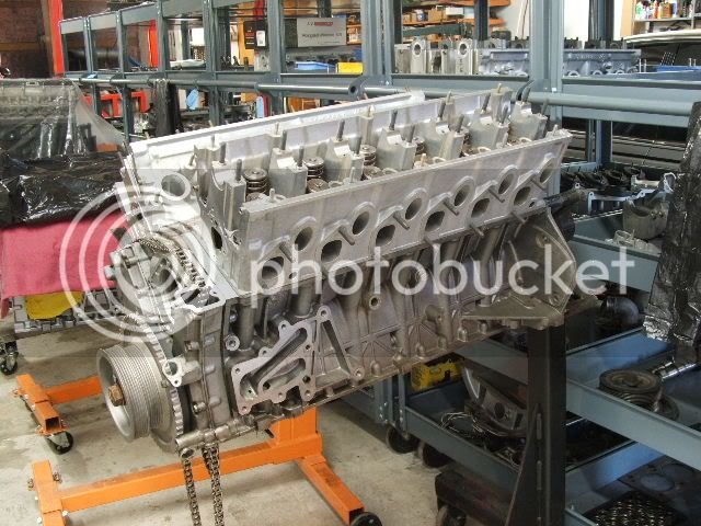

Also looks like a great engine workshop, can't say I have seen anywhere like that over here.
Thanks Andy, this builder is a legend in the BMW community. Those "holes" next to the exhaust ports are for the sparkplugs, hehehe. Shows how used we've become to our Japanese 4 valve heads!

Every time I look at the exhaust side of these heads I think how strange they look. These heads really do look more like they belong on a domestic cam in block engine than an OHC setup.

Thermactor, you just don't know how good it is to see some progress. My adventure with these BMW V12's began in 2005, and with this particular engine in 2007.
