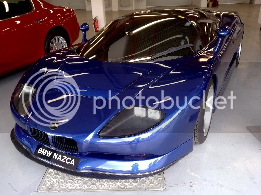

How about BMW NAZCA 1993 powerd by bmw alpina 5.7 v12.
BMW built 3 this one was up for sale september 2011 for 1.1 million dollars owened by The Sultan of Brunei.
