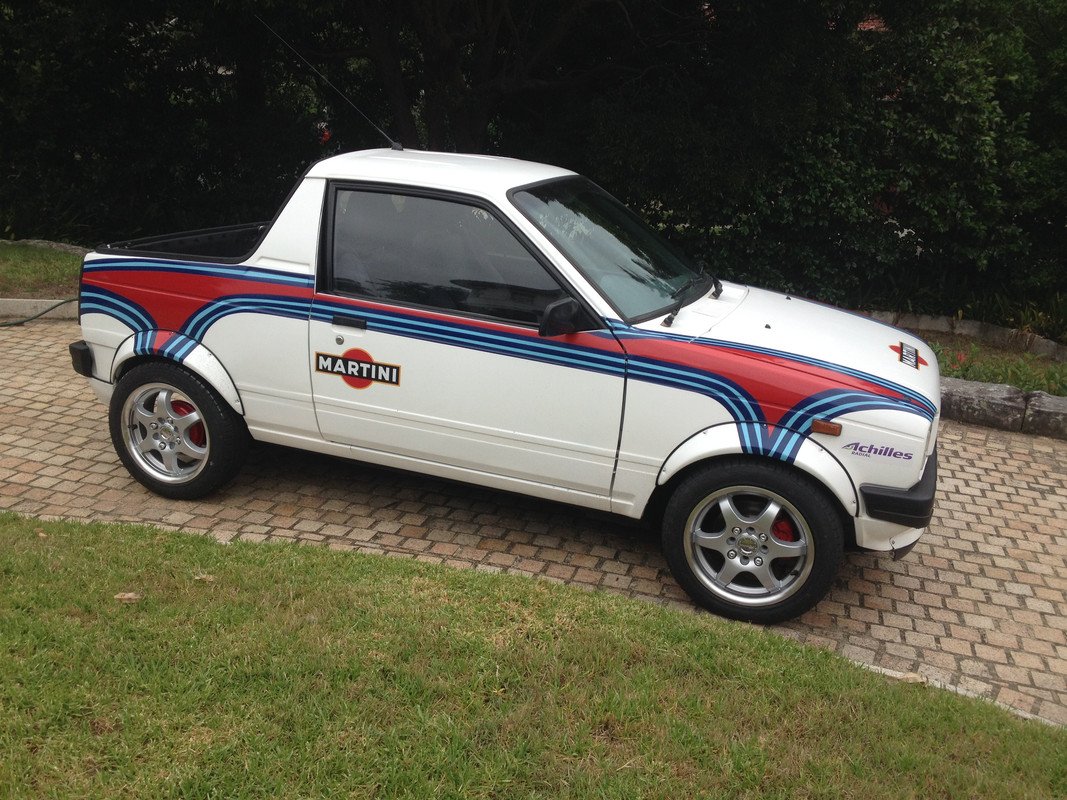

A friend tried his best to get me to talk my son out of buying the MightyBoy.
He said it was a coffin on wheels.
Well after 2 years he's still alive.
His car was originally red like your photo.
Now it looks like this.
