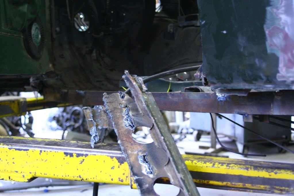

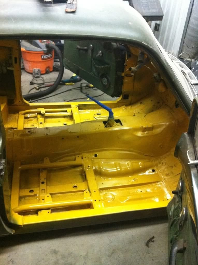

Out with the old rusty sh!t:

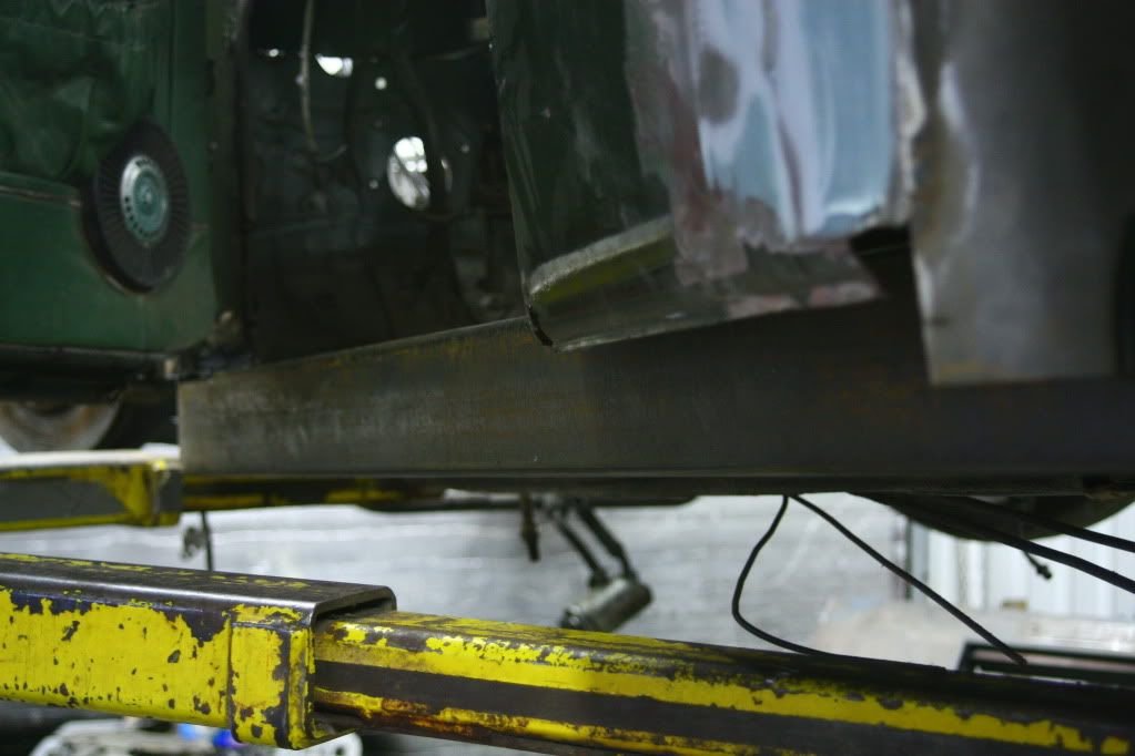

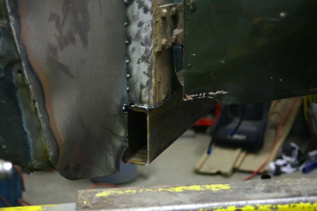

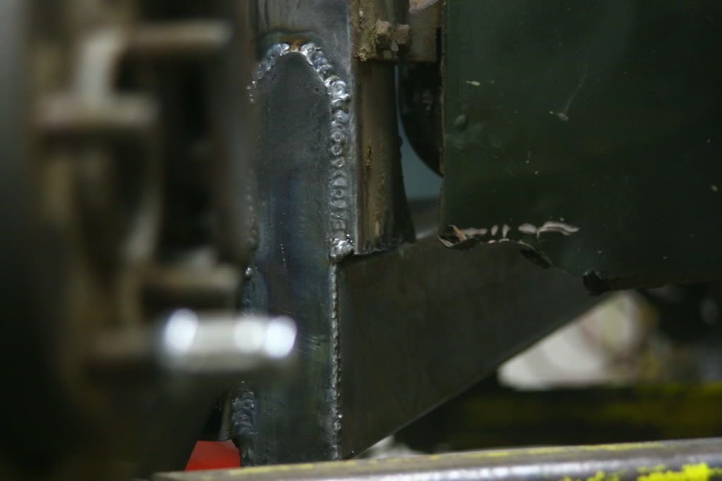

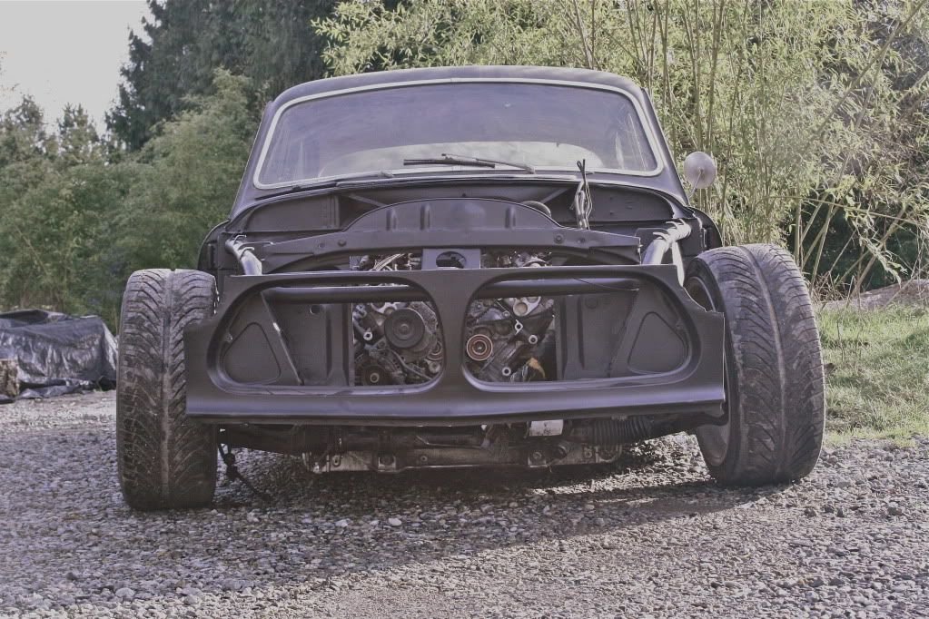

In with the new structural sh!t:

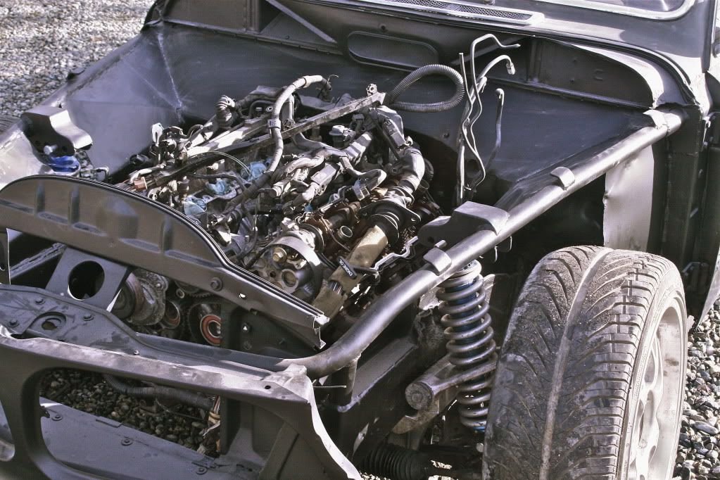

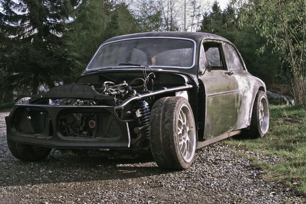

2x4 .120 wall, it will become my outer frame rail and something really solid to attach a cage too.

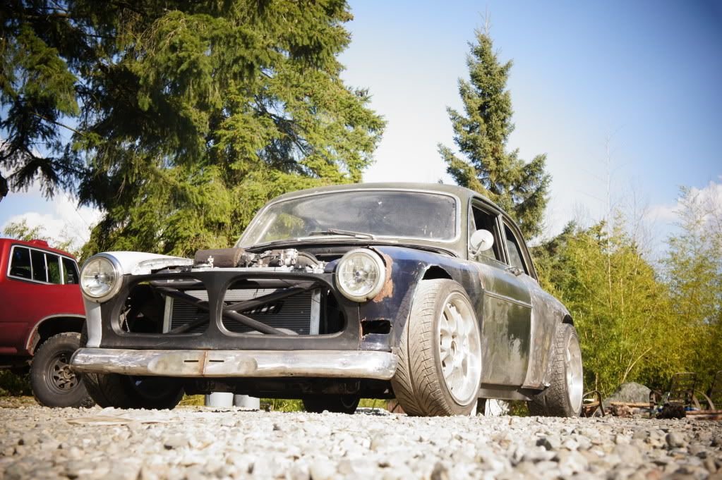

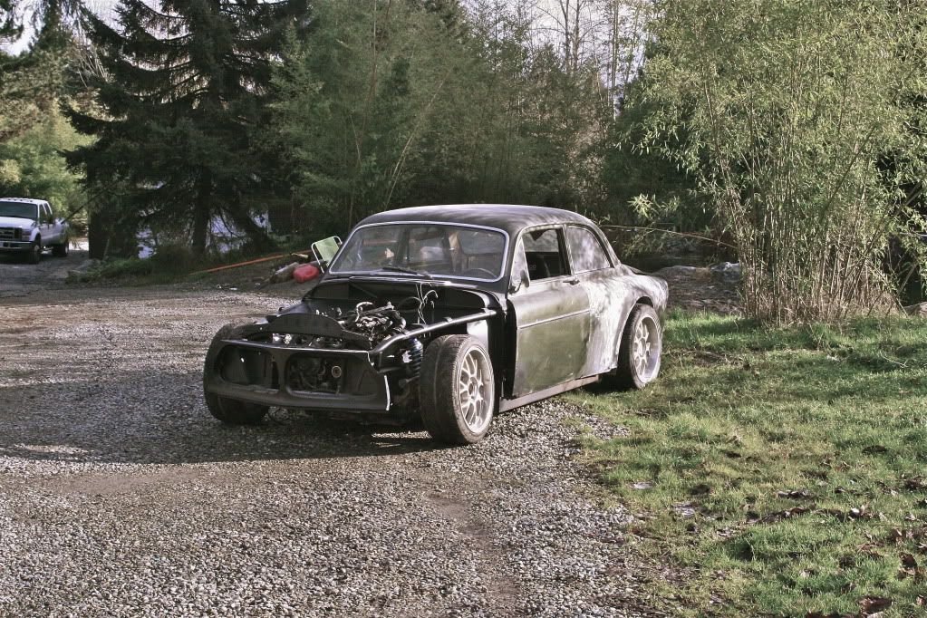

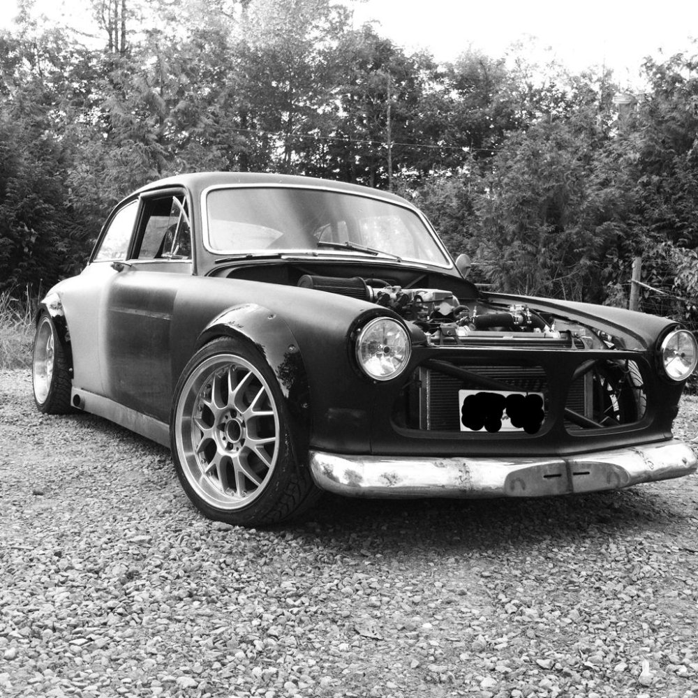

Ok....it has finally rolled out of the shop sprung on its own springs. F*ck what a great feeling. ;)

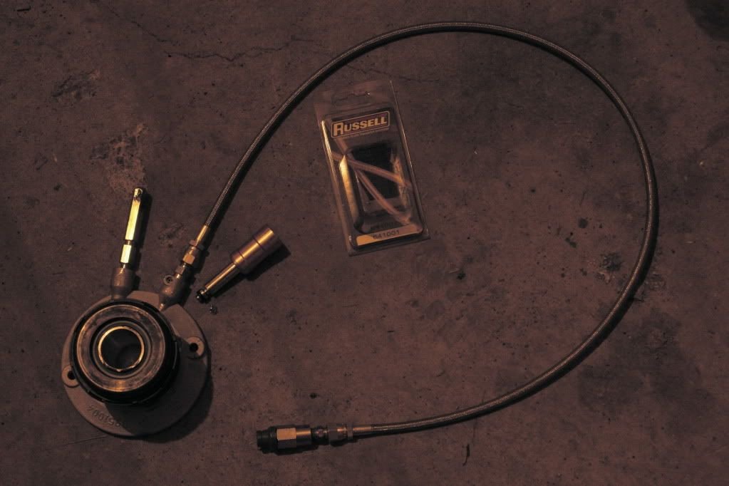

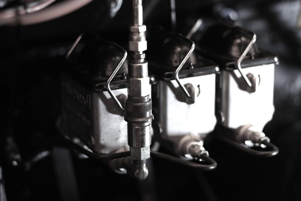

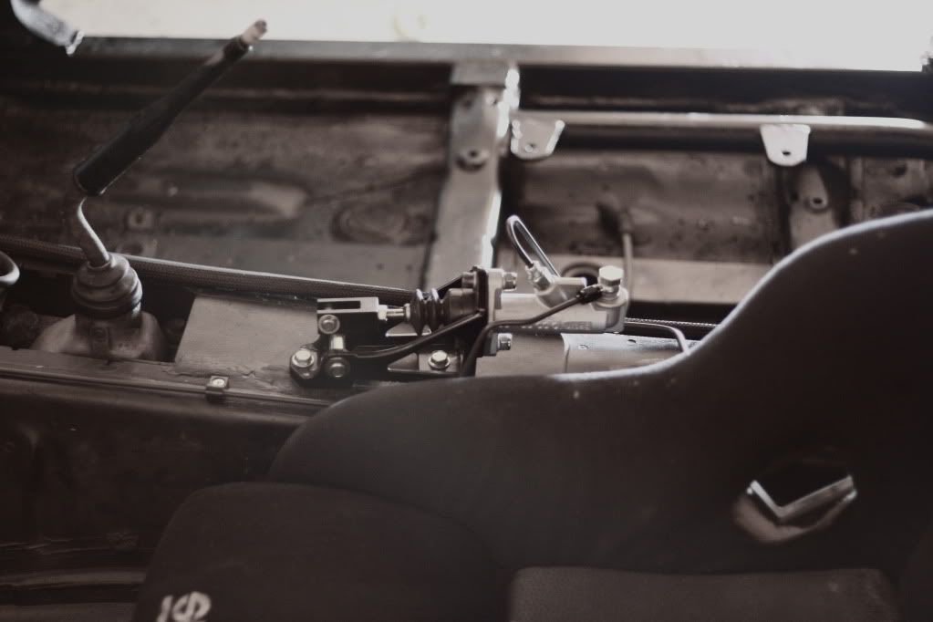

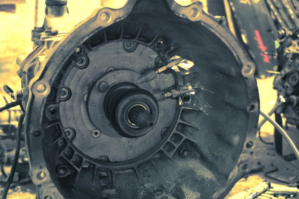

Camaro hydraulic slave with custom line and quick disconnect:

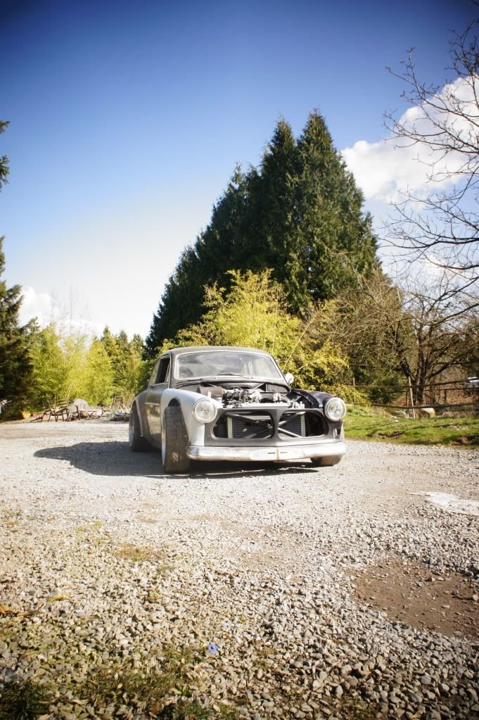

Yes Primer!

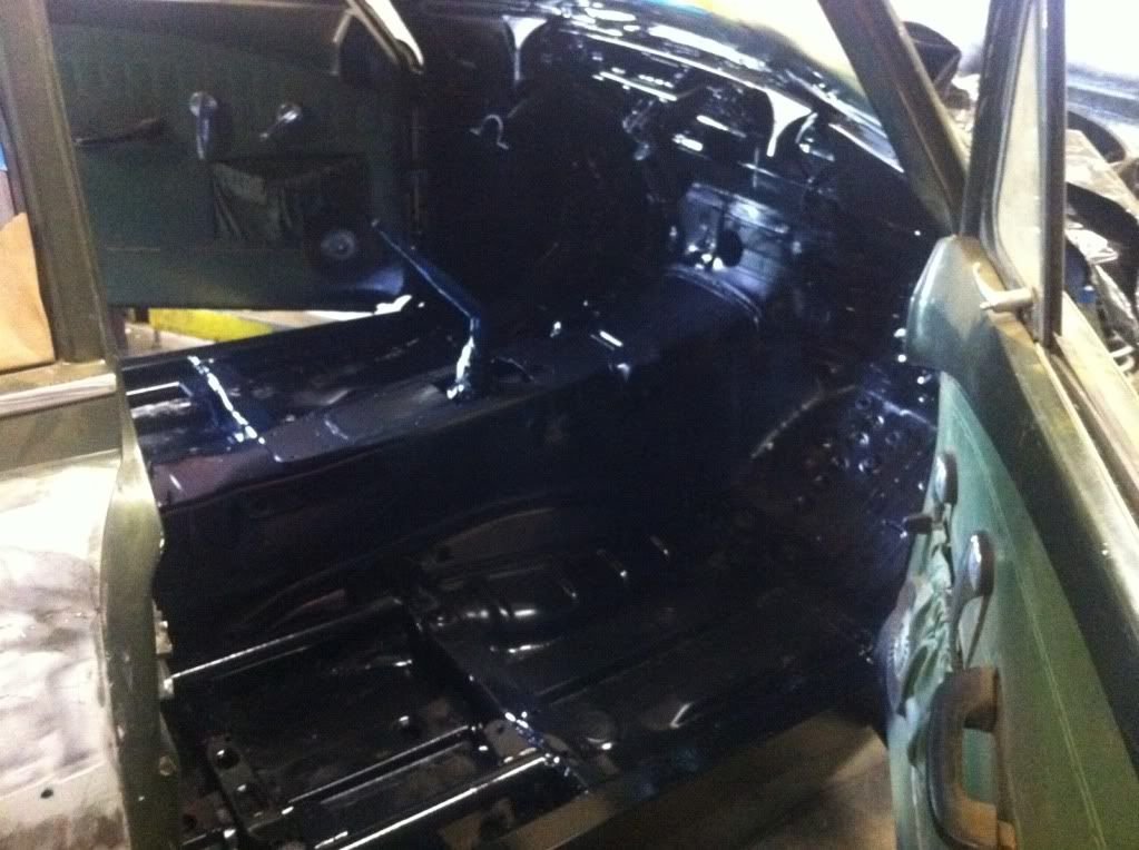

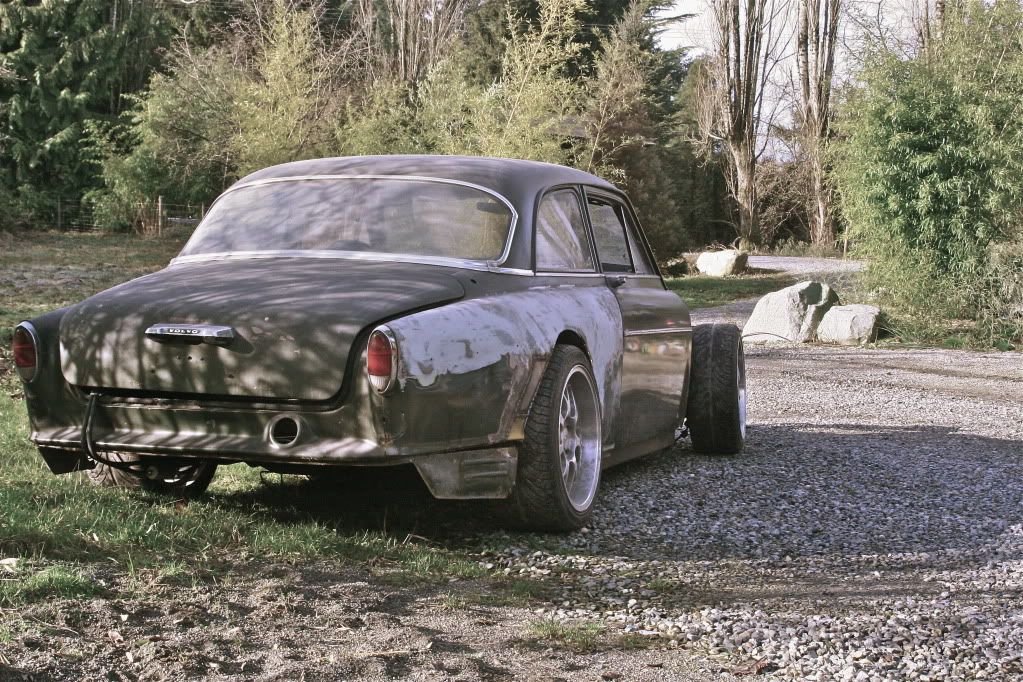

Got the last touches finished to get this thing out the door, the whole interior, trunk, undercarraige and pretty much everything that I've touched is now John Deere Blitz Black.....

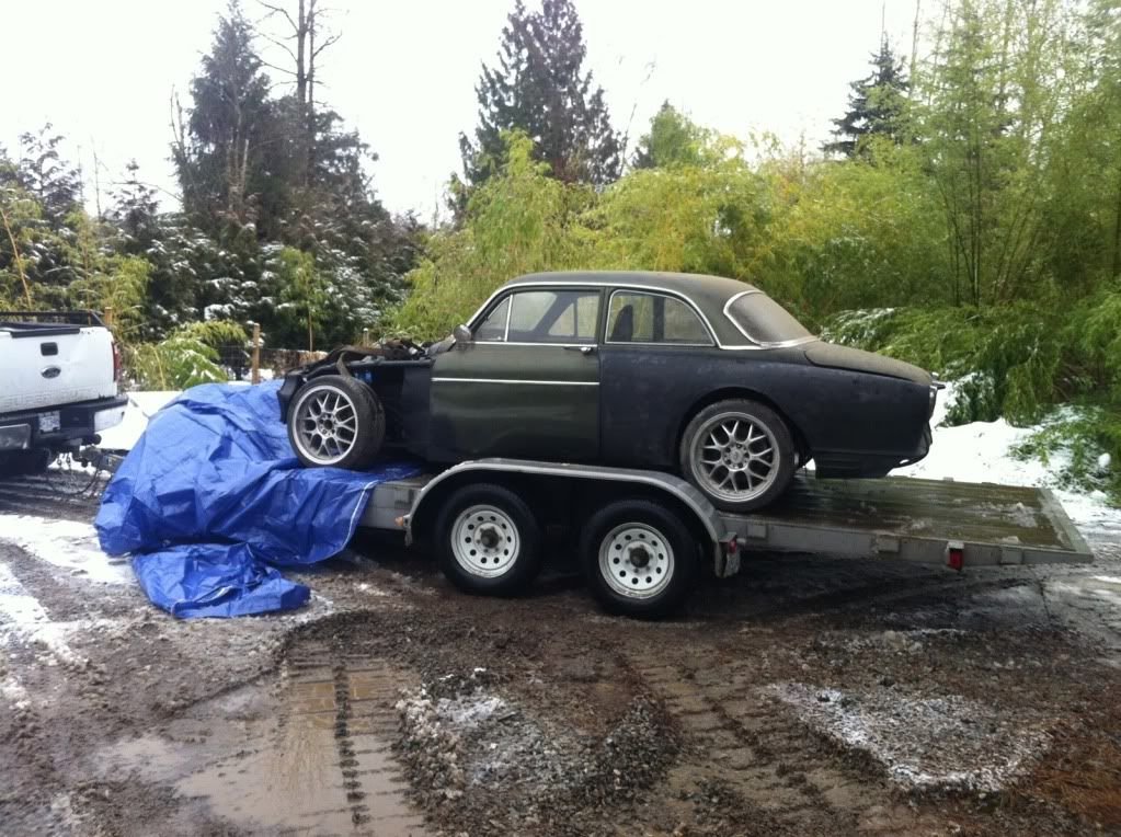

And off to the Independent Speed Shop! Should be almost read to drive in a week or two. Thanks to Ryan at Disturbed Industries for the use of his trailer!

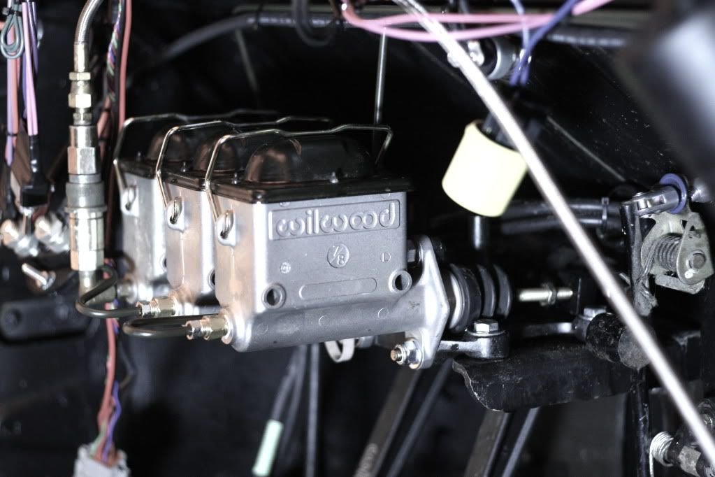

Some of Bill at Independent Speed shops work....making me nice brake lines, plumbing and wiring everything. Dash is not installed so all the switches and buttons are just dangling.

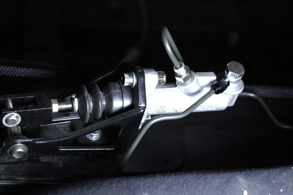

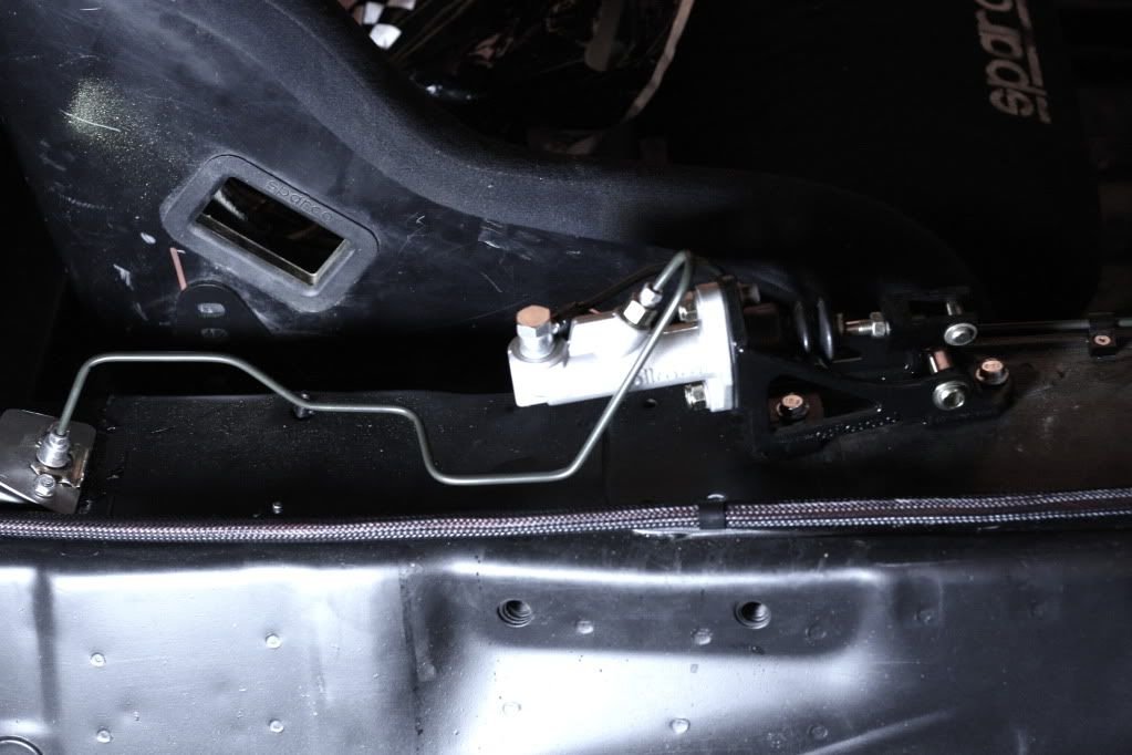

Hydraulic Hand Brake, I need to make the lever next:
Wilwood pedal assembly:

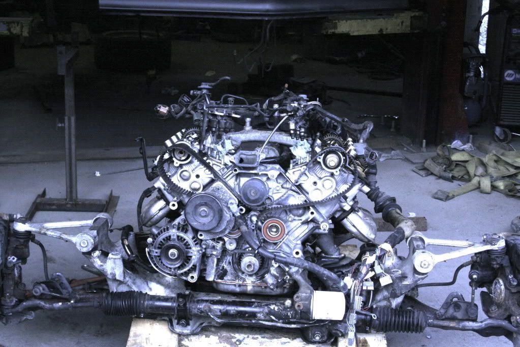

Here's a bit of an update:

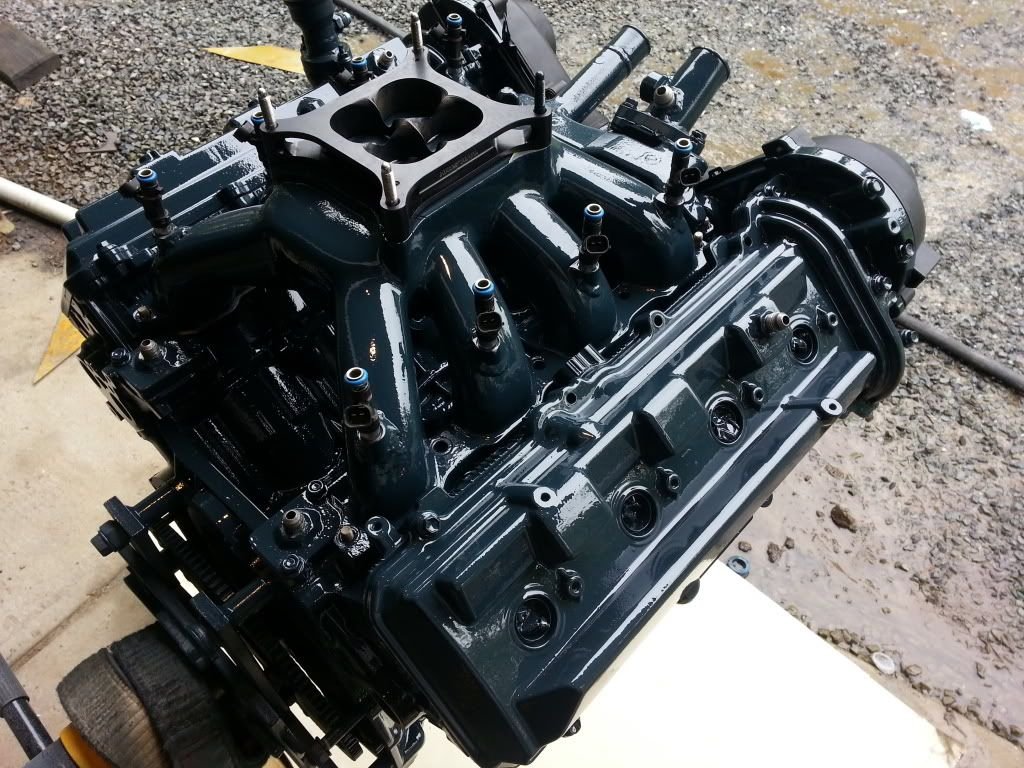

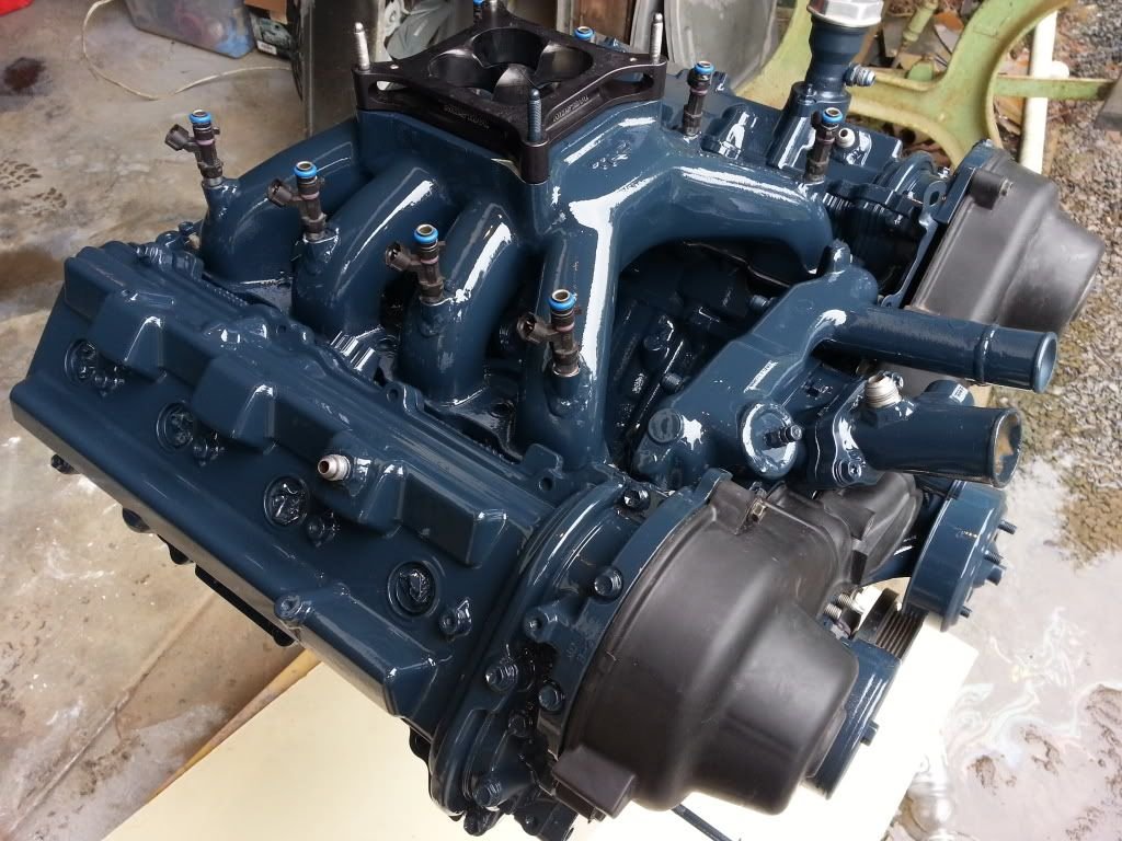

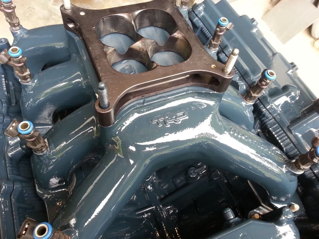

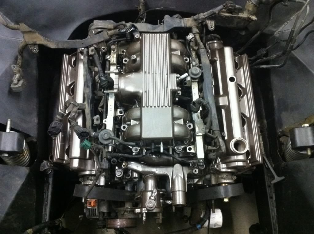

new motor.....450hp 2UZ, billet crank, h-beam rods, web cams, and a bunch of other nifty stuff to make it go fast. Painted it nimbus grey....looks a bit more blue in the pics than in real life. ;)
whats the story on that intake manifold says TRD looks to be a carbie setup with injector bosses welded on.. a little :confused:
