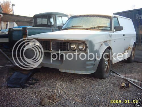

Since my last post I've completely re-wired the car using a 'Keep It Clean' universal loom, and I must say it came together a lot quicker than I first thought. With a little planning and mapping what wires I needed to keep, plus using quality terminals, plugs and tools, I can say I'm very happy with the outcome. The only downer was the sports dash I'm changing over to has kept blowing fuses whereas the old dash worked fine. Turned out to be a blown diode or something so an easy fix.
Now just down to air intake, hoses for power steering and water and an exhaust. Oh, and then put the interior back in.
