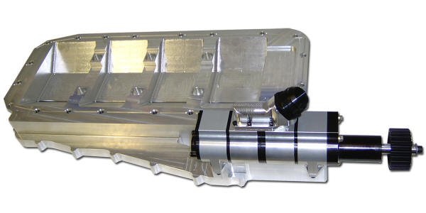

Actually, the square root of SFA has happened on the motor over the holidays. We had to discard the idea of an integral dry sump pan and pump, because although it's very compact and looks gorgeous, only a professional race team could afford it
Here's the kind of work that Dailey Engineering: www.daileyengineering.com does. This is a Dodge Hemi dry sump pan with integral pump:
They make these for Chevies, Fords and Mopar, and if you have a new application, it'll run around $10K for the prototype, and about half that for production units <sigh>. Anybody up for a GP on V12 dry sump systems?

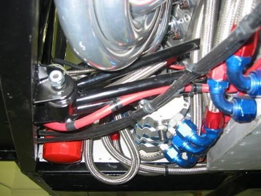

Sure looks nicer than the typical spaghetti of braided hose you usually see around a dry sump setup doesn't it? Here's Jay Esterer's dry sump setup, (same motor as mine, but in an Ultima):
So we're back to square one on doing a fairly conventional dry sump setup and still trying to find space for everything.

We considered the Dailey Eng. integrated sump/oil pump, he was supplying TRD for the Lexus/Grand Am engines.
As the sump on the Reynard is the lower engine mount we could not use the Dailey setup, went with one of his pumps though and we have a bunch of snakes with all the hoses.
The Dailey pump is an absolute jewel, 4 - roots type scavenge, gear pressure and centrifugal oil/air seperator. Not the cheapest but by far the best.
Bill is also one of the nicest guys to deal with, nothing is too much trouble.
Erol, I'd always heard he built good stuff, and was hoping I could incorporate at least part of his system. Maybe I can still go for his pump, if not the whole integrated setup.
