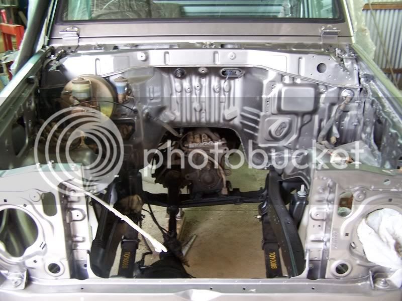

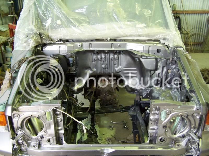

Glad to hear it's all lookin good Big. Here's a before and after pic of my firewall. Of all the forums I have my buildup on, I have never posted these pics before. P.S. Yes my box is tilted aswell.
Haha..same box as mine..zzz at least yours was fitting first time..by the looks mine has a longer input shaft too..:O
