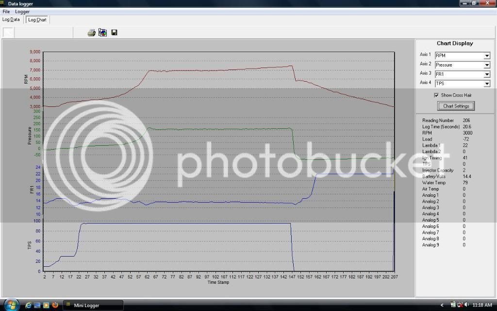

crazy lean pass, AFR's 13.7:1. couldnt see any signs of detonation. plugs looked good, no lifting heads.
