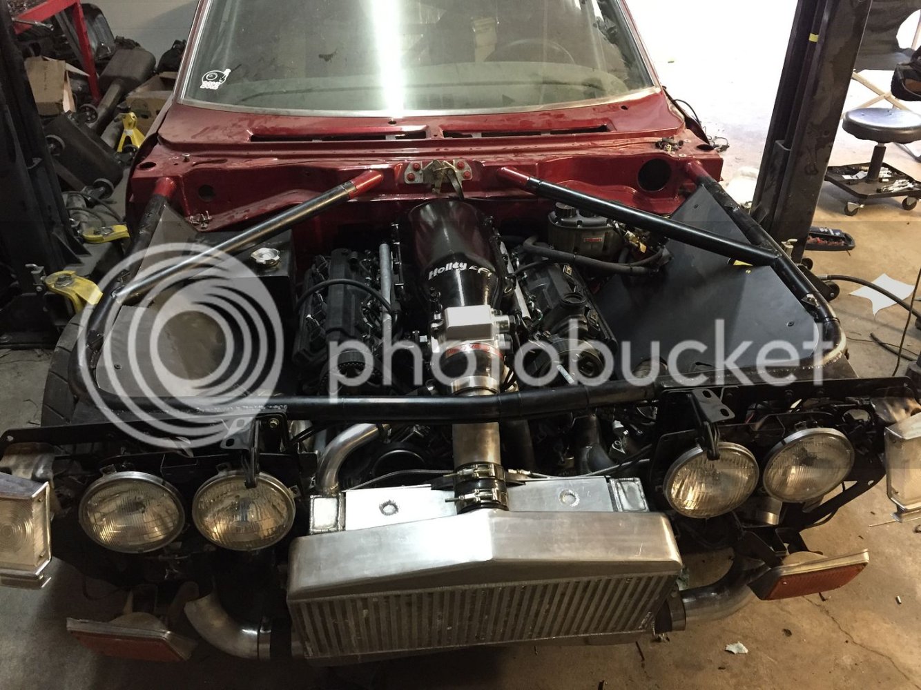

Haha yeah the holley plenum top was the best idea I've had building this thing, the plenum top and the flange were both in stock at summit and were super cheap

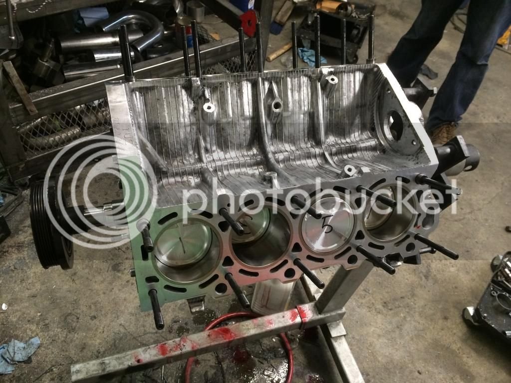

This is why I've been too busy to post
Early block and heads
Ross 9.5:1 .040 pistons
TTC chromoly I-beam rods w/arp2000 bolts
ACL main and rod bearings
ARP head studs
Crower 264/272 cams
Cometic MLS gaskets
Etc
Time to get it together and turn up the boost!
Holy ....balls, looks awesome.

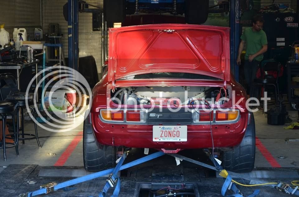

A tip for future dyno runs. Don't use good rubber...metal rollers kill them and you'll read lower as well (if that matters...of course it does ;) )
Use the hardest rubber you can find and run around 45psi

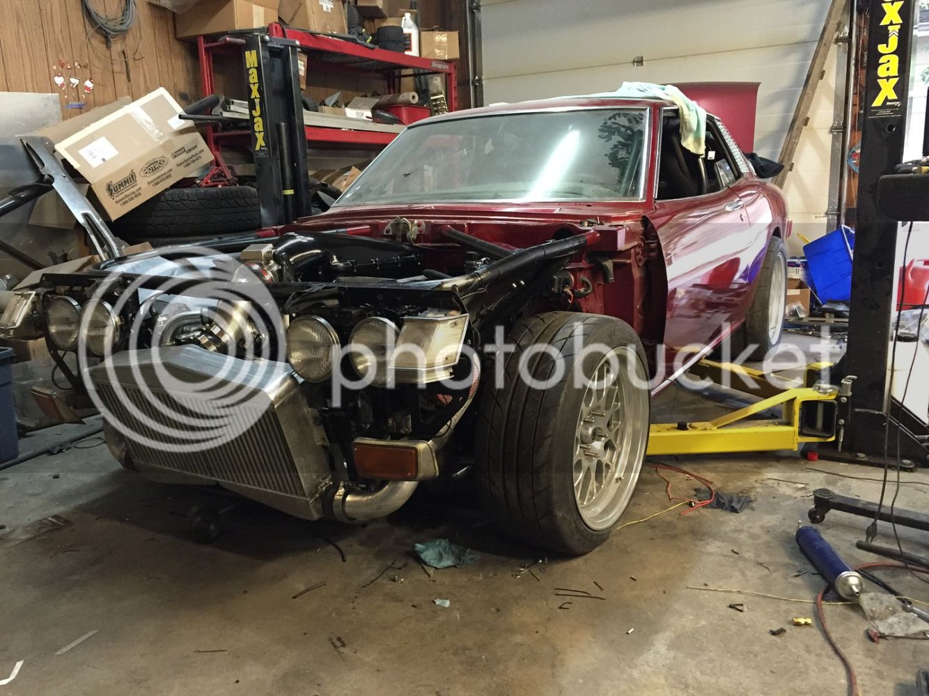

A few new things
-full forged built long block
-painless performance 26 circuit wiring harness
-tilton pedal box assembly with heel mounted master cylinders
And lots of other goodies. I actually just fired the car up for the first time in 7months after a full re-wire of the electrical, fuel system, new motor, modded cooling system and a bunch of other stuff. Should hopefully be driving it in the next couple days to see how it is!

Strapped it on the dyno.
-First pass @14psi was 508whp uncorrected spinning to 7200rpm
-Second pass was @17psi and made 575whp uncorrected spinning to 7500rpm
-Third pass was really rich AFR (10.1 LOL) so we rescaled the fuel and loaded the map
-Fourth pass.....loud knocking noise as soon as I fired it up, immediate thought was probably the loudest rod knock Id ever heard, turns out this noisy t56 magnum that's been a lemon since brand new finally lunched the counter shaft. $3000usd paperweight at the moment. Engine is good and it's just the transmission at this point. Still sucks though, I'll pull it out next week and see what needs to be replaced
