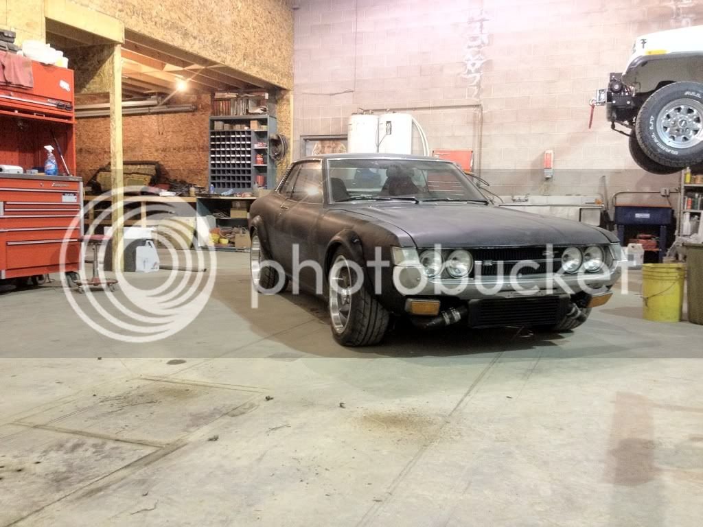

'72 RA21 Coupe, 1uzfe and Single Turbo

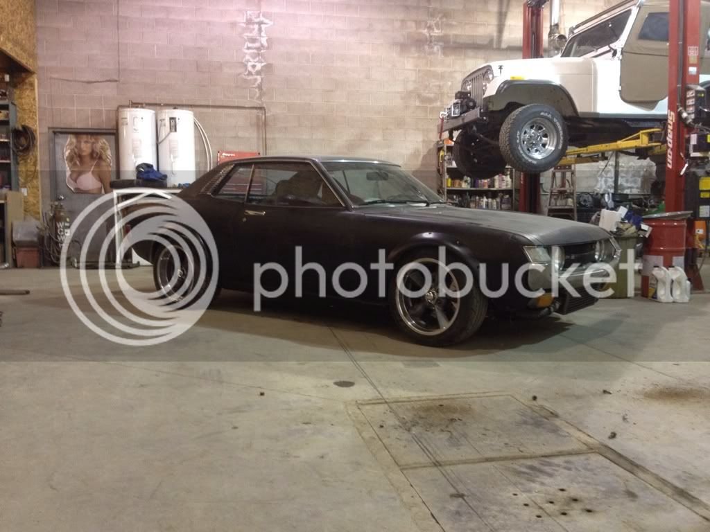

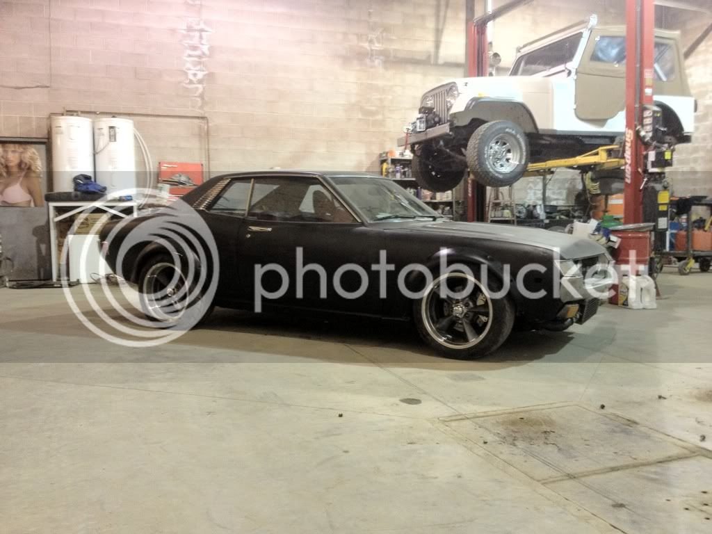

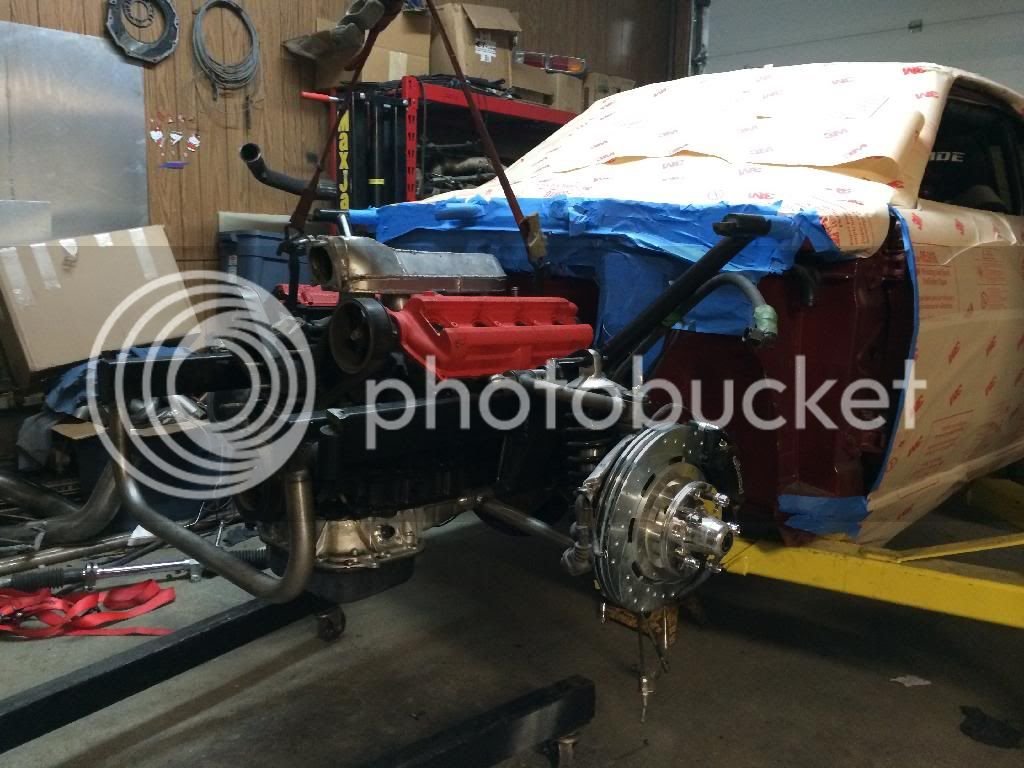

Done a fair bit of work lately, cut out all the rusty bits of rocker panels and opened up the wheel arches to fit the new toysport fender flares. Currently spacers in the back and longer boxed control arms up front. All new steering parts: inner/outer tie rods, ball joints, aw11 rack that doesn't have a dead spot in the middle etc.
Still have to lower the rear about 2 1/2", currently wearing stock rear springs
Longer control arms

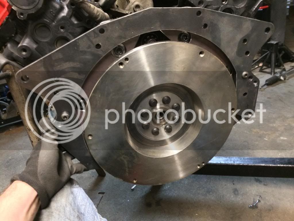

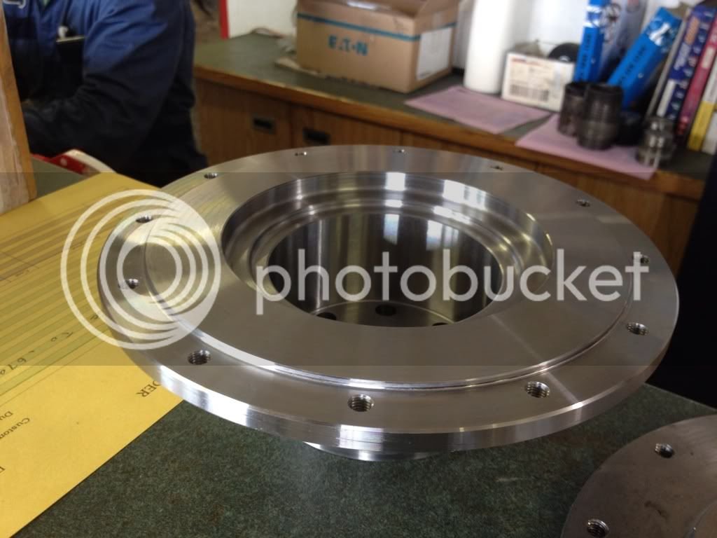

had a new flywheel made up, 4140 chromo

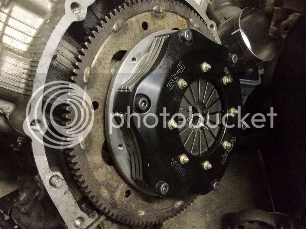

to house this clutch, tilton 7.25" triple plate for 26spline chevy input

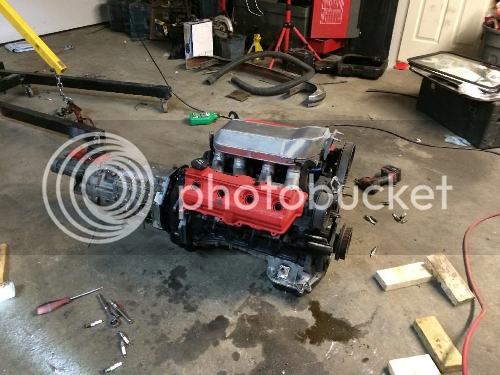

for this transmission, tremec t56 magnum close ratio box

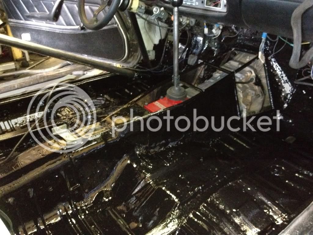

picture of it in the car with framework for sheetmetal
here is most of it done, I made a 1piece aluminum cover for easy access

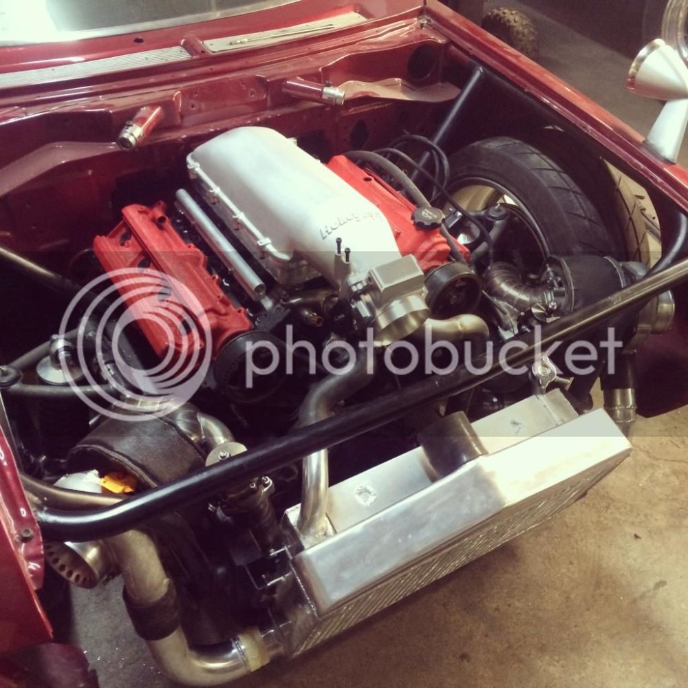

finally got to run it on another dyno after switching to the .81AR turbine housing and i was correct in my guess that the dyno read high with the 0.48AR, most guys when they swap to the bigger housings usually pick up 40-50hp well with the new dyno I was down to 508whp first pull and by the 5th pull i was back up to 534whp uncorrected(580ish corrected)
I still dont have my new intake manifold on the car yet due to some issues with my transmission swap but the trans is back with tremec right now and I should have it back next week and hope to have it all back and running soon

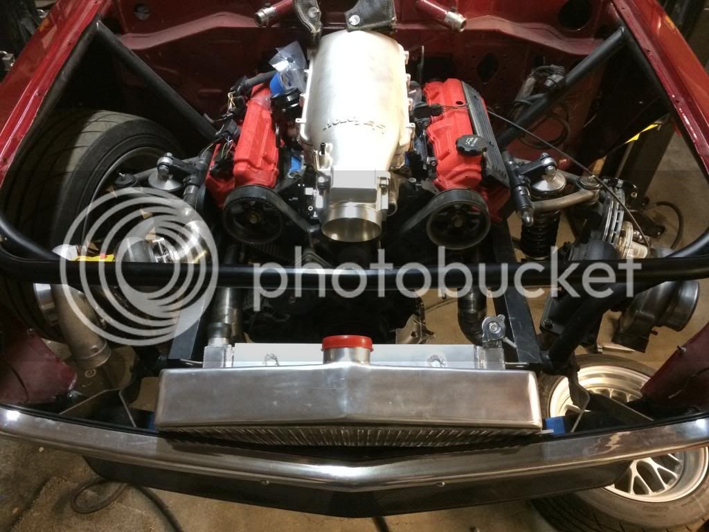

Just realized I haven't updated this in a long time, here's today's update if I remember I'll come back and fill in what's missing for the last year and a half
New adapter plates, custom 4140 cromo flywheel to run LSx sized clutch (spec stg4)
Tremec t56 magnum, QuickTime scatter shield
Mostly located and starting and building motor mounts
