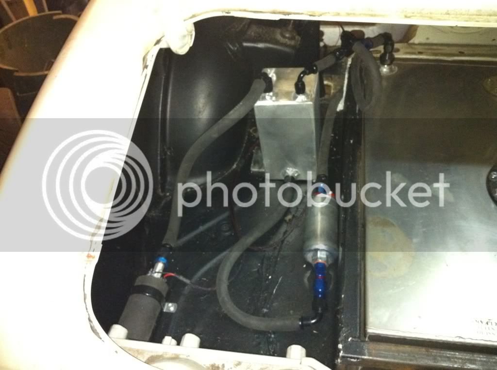

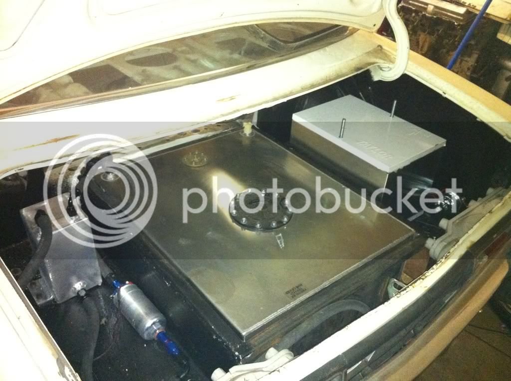

Built a skeleton for the fuel cell
Mounted the fuel cell in the car

looks like a great project! a couple questions, what capacity is that fuel cell, looks pretty big.
How wide are those tires? 265? looks very sweet.

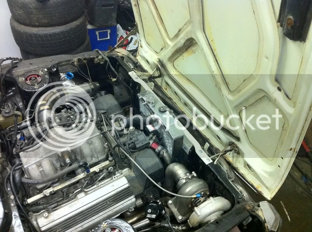

it runs

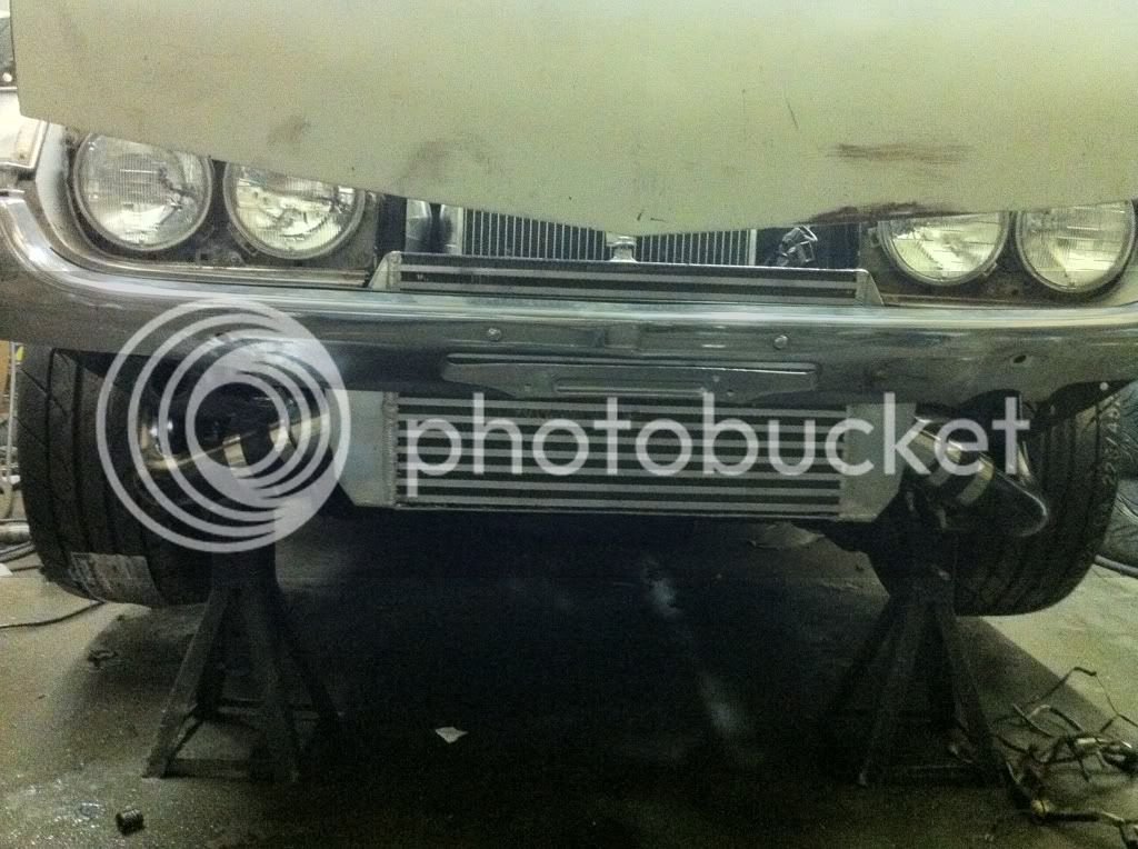

Radiator and intercooler done, now makes pew pew sounds!
Still need to re-do all the underhood wiring ie headlights, alternator, gauges etc
Steve
Nice results mate...that's good power at such a low boost level. What fuel? and what turbo again?
The same power nose over around 5300rpm we love so well ;)
Sorry fuel is 94 octane pump gas (I think about 97ron for you Aussies) and the turbo is a pte billet 6262 ballbearing with a .58 t4 vband exhaust housing. I was worried about it choking flow on the top end but don't see any evidence of that yet
