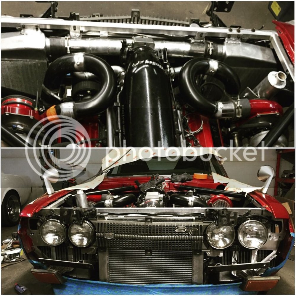

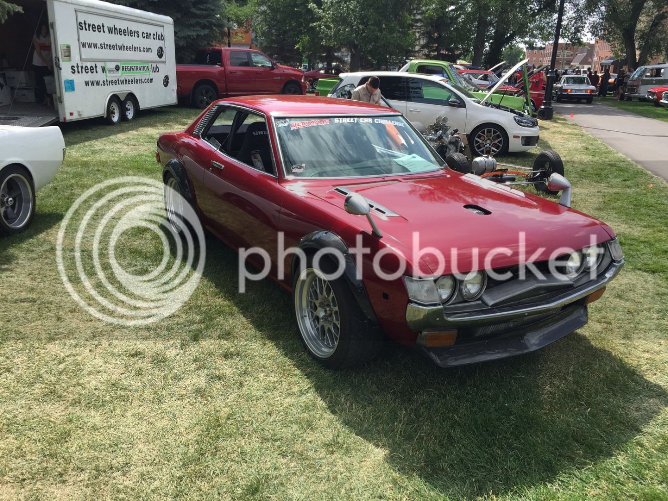

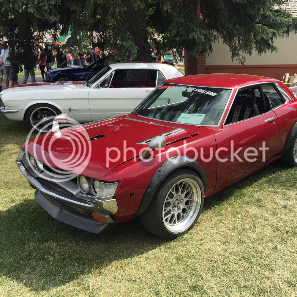

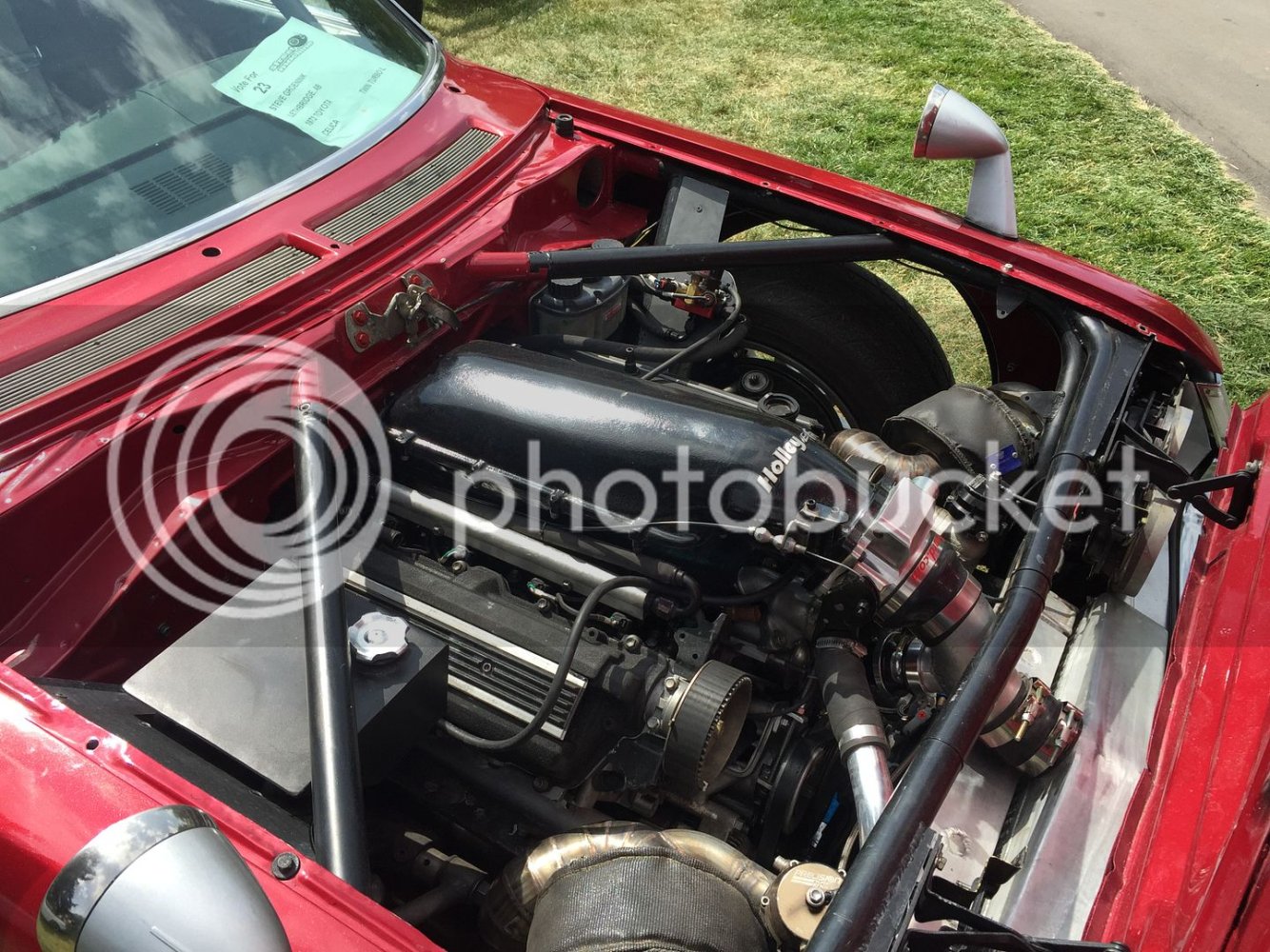

lots of changes this year
all new front framerails, new turbo locations, new manifolds/downpipes, intercoolers, radiator etc
this pic was with the single front mount intercooler
twin sidemounts now

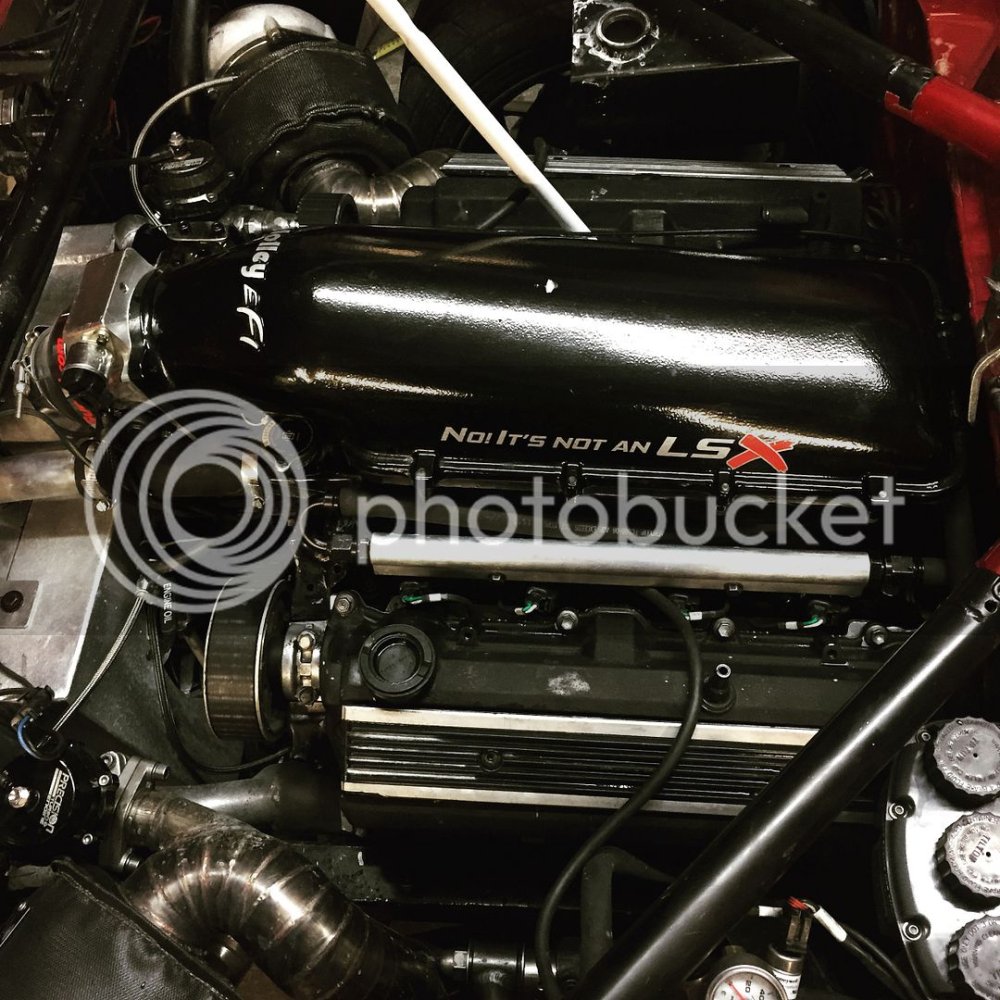

100% stock unopened early engine(forged engine is getting some upgrades)

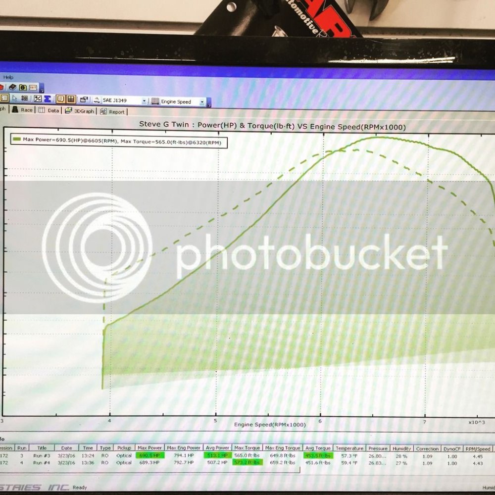

Is there a big difference in IAT between the old intercooler setup vs the new side mounts?
How much Boost do you running? 26.8 psi at the Dyno, right?

That 690whp was at 16psi of boost, I haven't really checked IAT's as a comparison but on four dyno pulls within 15minutes, the last run started at approx 15degreesF over ambient and only climbed about 6degreesF, that's with no fan on the car from the dyno.
The actual Intercooler cores are the same as all I did was cut the old core in half and build new end tanks, but the overall affect on the cooling system itself will be huge by removing that great big airflow restriction from in front of the radiator
What's the main reason why you change the intercooler setup? Water temp issues?
A few reasons, primarily for the better airflow into the radiator but also aesthetic cause the Intercooler was just way to huge and ugly sticking out front. Now I can run a stock grill setup and it looks way cleaner now
Oh, great numbers with only 16psi! That's awesome!

Those numbers are a 100% unopened high mileage stock 1994 ls400 engine. Only thing I did was clean it up and paint the valve covers. Stock cam's, headgaskets, bolts etc

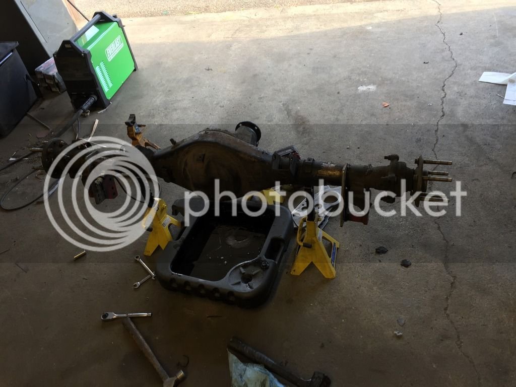

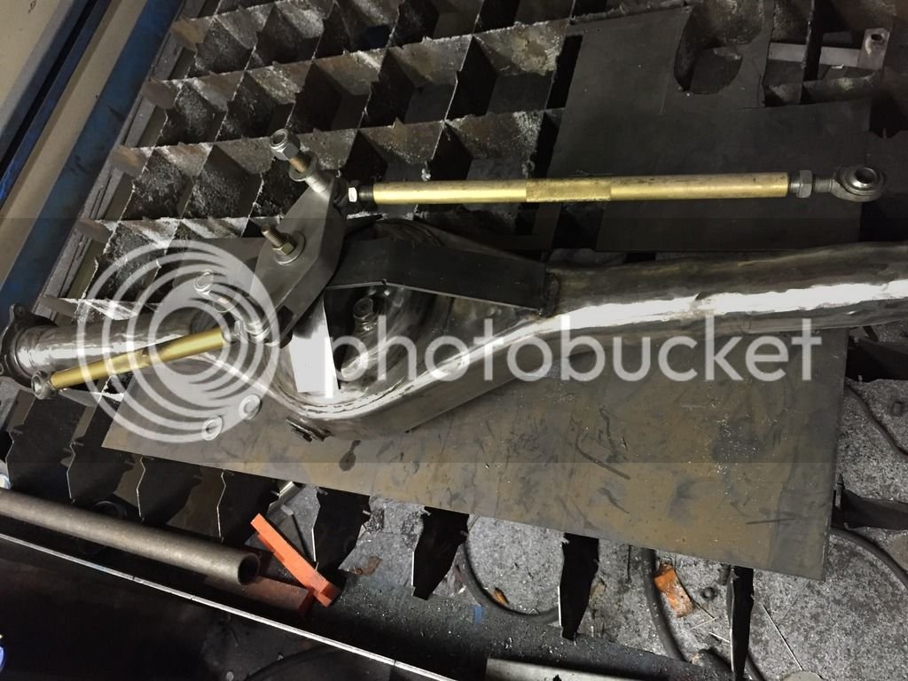

Well I figured it was time to finally make this thing capable of putting all that power to the ground

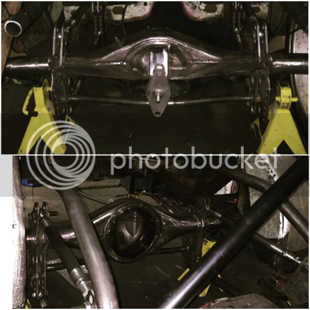

Out comes the scabbed together 8" axle, this things been through the wringer a few times, tearing link mounts in half multiple times LOL

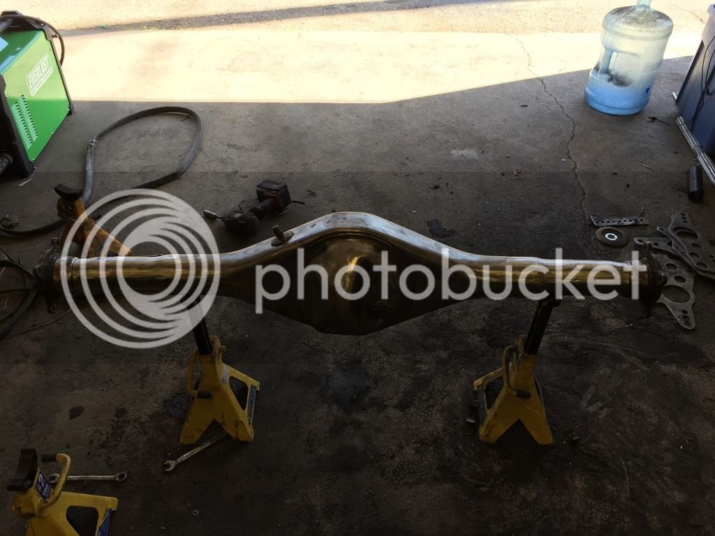

Cleaned it down to the bare housing

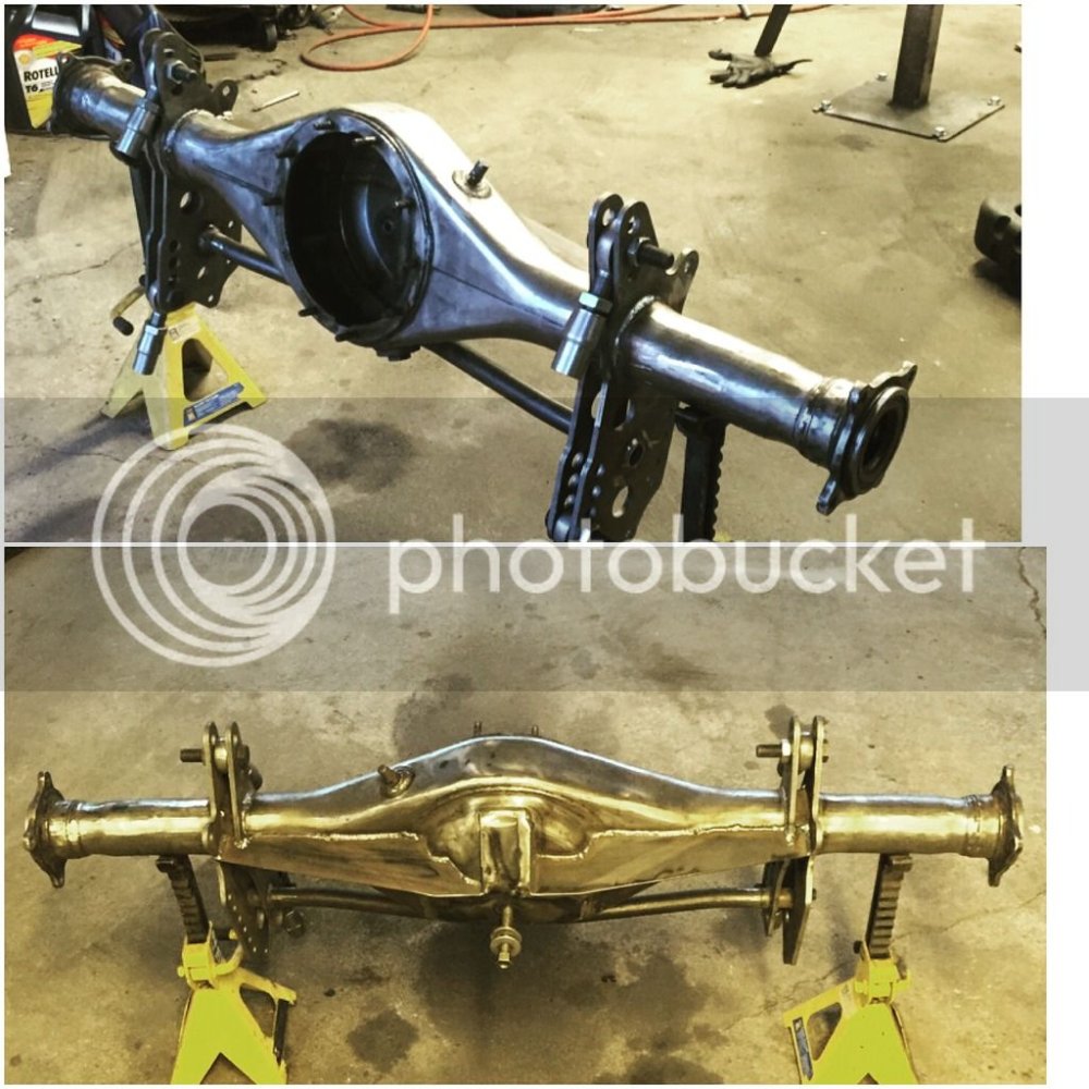

Built a watts link locator to replace the panhard rod, this will keep the axle Centered to the body throughout the suspension stroke and prevent it from unsettling the tires through corners

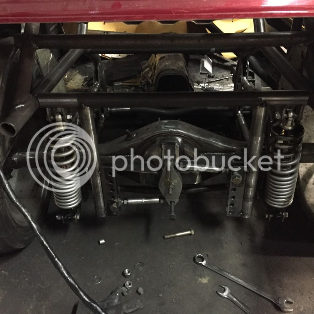

Added the competition engineering parallel 4-link brackets and added some braces to the rear. This setup should hopefully give me the best of both worlds, traction in a straight line when I want it and with a quick damper setup change it should allow me some great cornering too!

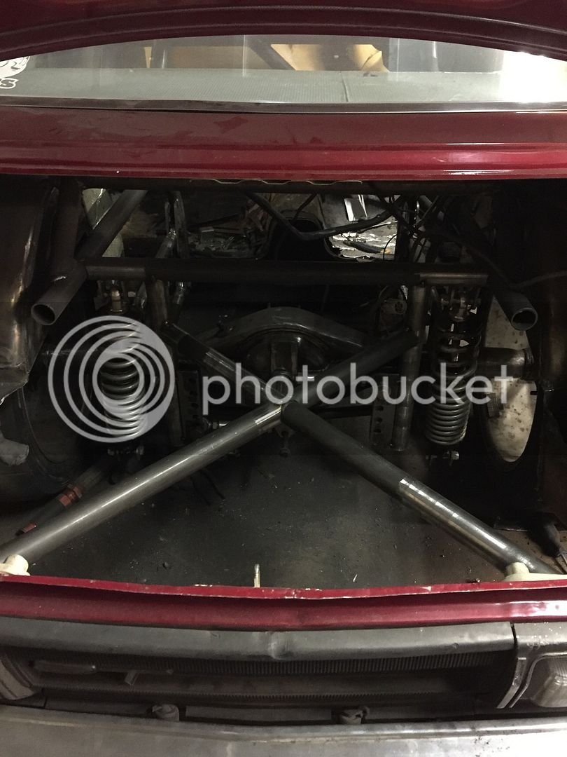

I forgot to take some pics yesterday of the giant hole in the rear of the car where the new chromoly tubular frame rails and crossmember will be.
Got the frame rails and mounts in
Shocks, watts link, and some reinforcement braces tacked on
Added a couple cross braces
Couple more bars to add, then burn all the tubes in with the TIG, and then start adding some sheet metal to close it all in
