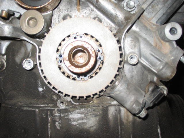

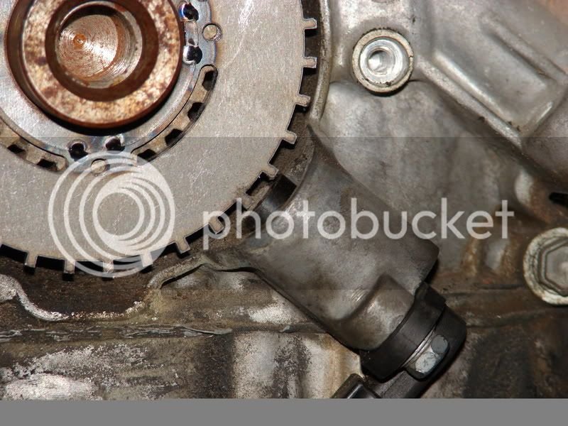

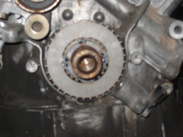

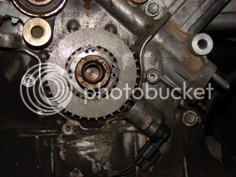

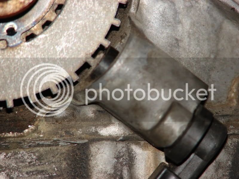

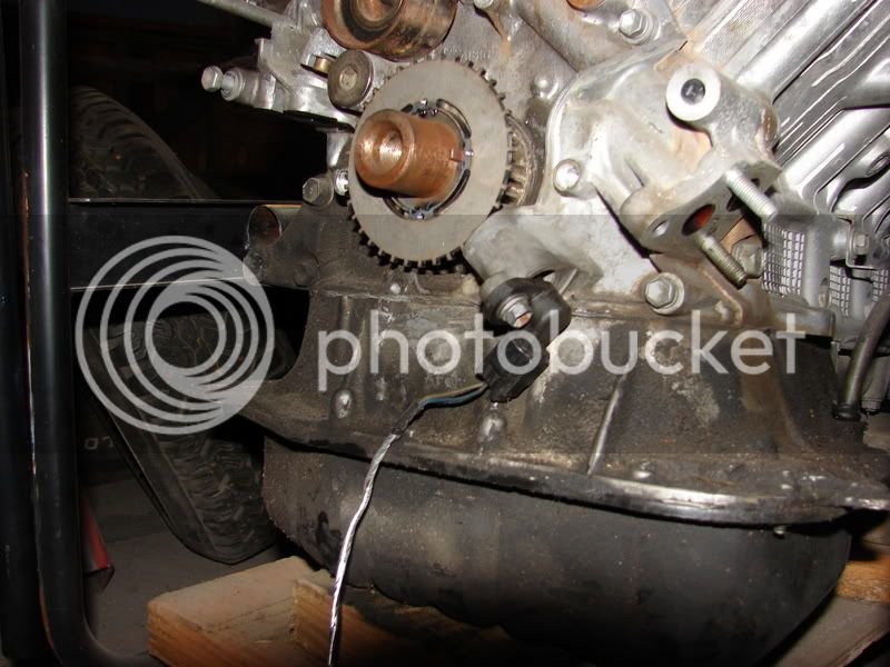

I am Jason. Here is another interesting discovery I made. The VR sensor from a late 90's Ford Windstar fits in the same place as the Stock 1UZ's VR sensor.
If the Ford's EDIS VR Sensor recognizes the new wheel Lex has made, It should make the 1UZ a dream to make run. DSC00660.jpg
Well, the Lexus's VR sensor has a little higher resistance than the Ford VR Sensor from what I am understanding. It might work just fine though? I only was curious to see if the Ford V6 one would fit or not when I discovered it would fit. I know for a fact EDIS works with Ford VR Sensors. Not sure it will with the Toyota one?? I will soon find out though.

Well, most of the credit belongs to Lextreme. If he had not had these wheels created I would have lost interest or not be as far along as I am.
In my research for what others had done to run their 1UZ on MS I discovered he was in the process of having a 36-1 wheel developed.

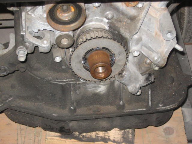

Now with his design he has made it practically idiot proof. It is a two piece wheel with the first piece specifically notched for the crank and the second piece had 36 evenly spaced teeth. Both pieces have 4 alignment hole you can tap and thread or use alignment dowels and do what I did, tack(sp) them together because no matter where you aligned the 4 holes it always comes out the same. After this you choose the tooth 60 degrees before the sensor and file it off (which I have not done yet).
Now my next step is to determine whether or not EDIS recognizes this wheel. That actually will be rather simple. I have (2) 1UZ's and the other one I have is complete. So I will put this wheel and Ford VR Sensor on it, Wire up two Coil Packs, One EDIS 8, and an IMPCO 425 LPG Carb w/Tank to see if it fires. In theory it should but I am not 100% sure.

Jason, I was just curious because from your photos it didn't look like you'd used the 2nd piece (the one with the notch in it for the keyway).
David, thanks, but it certainly needed both of us to make it happen. I had the idea, but no access to a fabricator, then we both worked it out together how to make it and get the necessary offset, etc.
