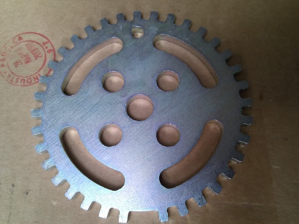

Contact David (Lextreme). He may have some leftover from the last batch, or perhaps he could be persuaded to make another run if there's enough interest.

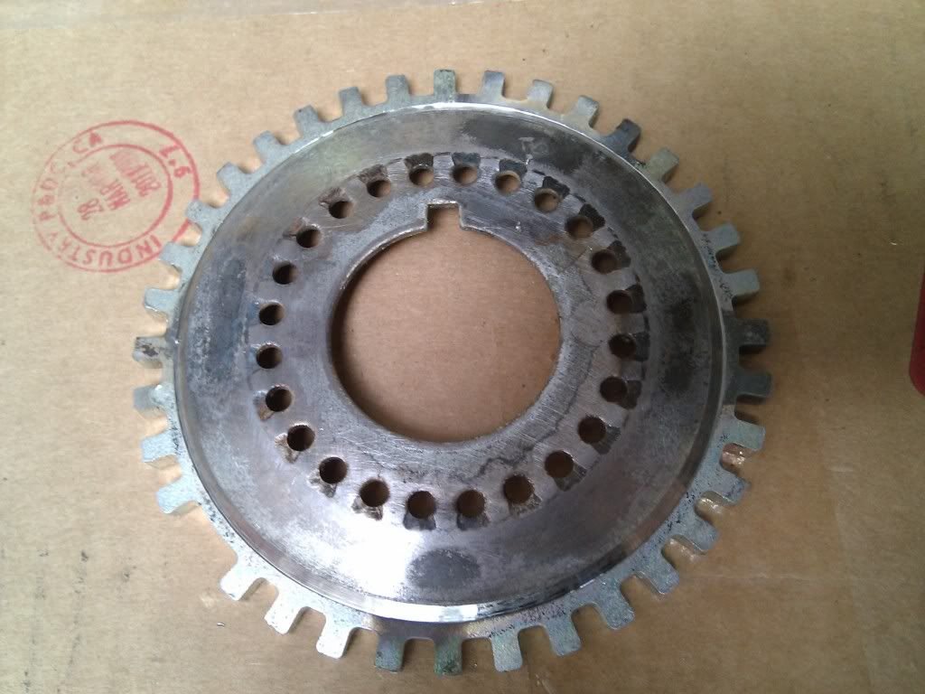

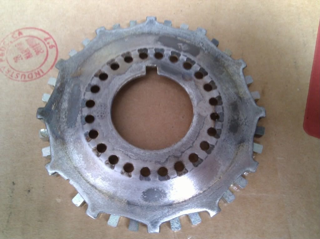

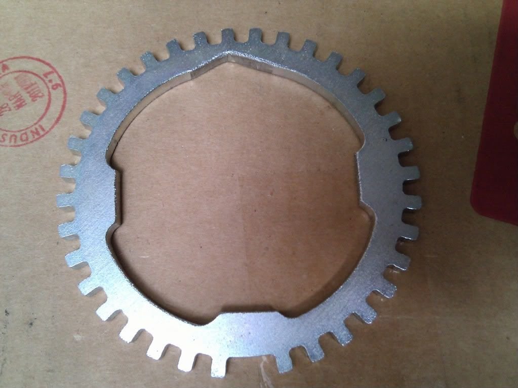

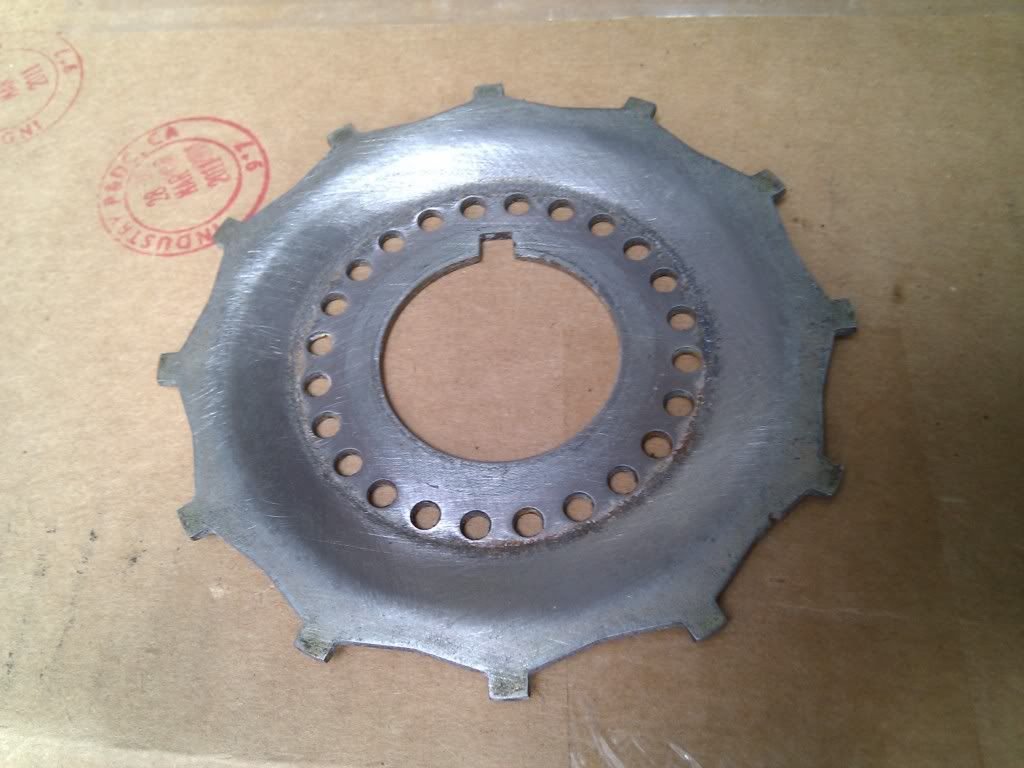

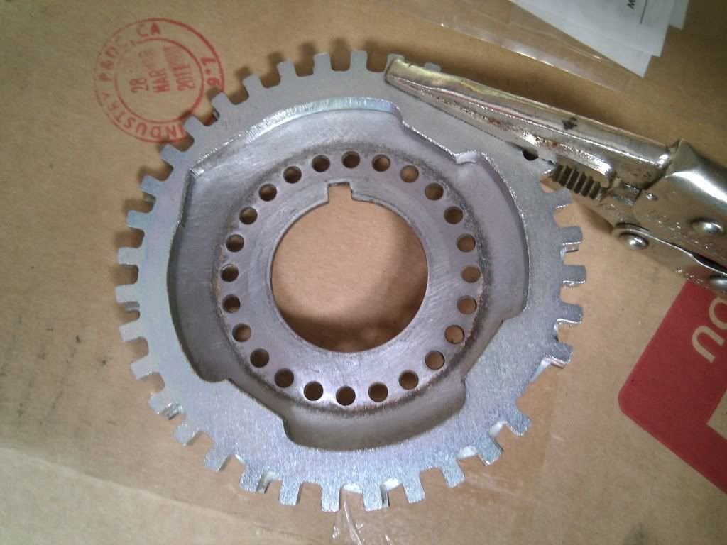

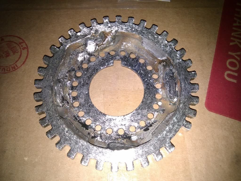

Ok not sure how much use this is to you guys but I have spent the day making up my own trigger wheel.
I started with a standard 100mm diameter wheel and merged it with the original 12 pointed 1UZ wheel and it went something like this

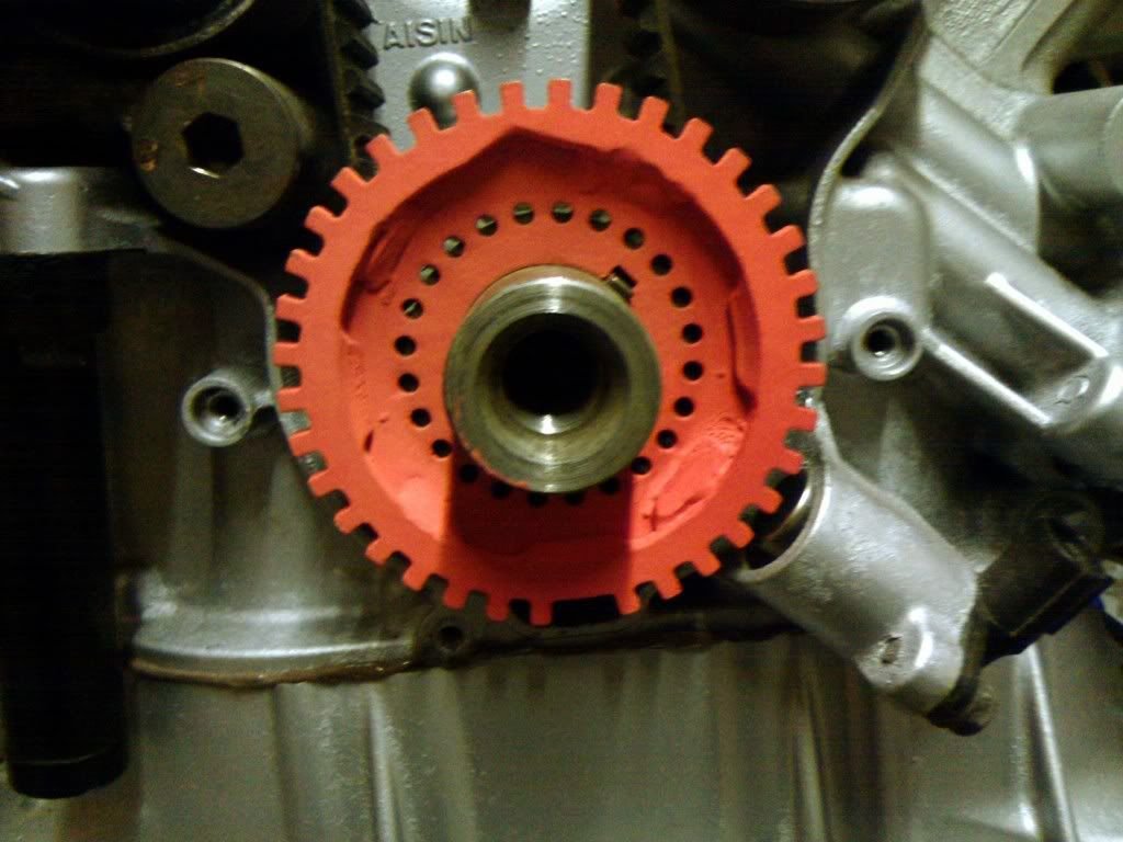

Perfect Power just confirmed that wheel is definitely for the UZ engines, and it comes with a spacer to give the correct offset.
The user simply has to grind off the appropriate tooth to get the 36-1 pattern.
