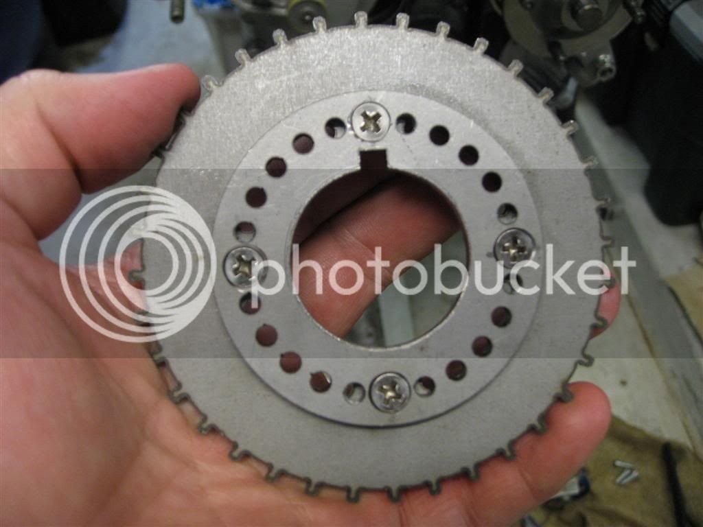

From cribbj's post a couple pages ago.
Mine looks the same except that it hasn't been screwed together yet.
Edit: I'm considering tig welding instead of screws - because I can.
David, it wasn't a Megasquirt, but it was the Megajolt Lt Jr. that I ran mine with for breakin. Same principle, though.
Your wheel works fine - the trick is to cut the right tooth out for the missing tooth, and this is also the same for both the Megasquirt and the Megajolt Lt Jr.

Got my triggerwheel today, david. Tank you, it looks good :-)
Btw.. I got my UZ fired with megasquirt extra, with the original triggerwhhel wiith one tooth grinded off, but will swap to the 36 tooth wheel when I got it mapped better to gain the better resolution of that wheel.
I consider tig welding of it as well to make sure the parts don't get loose from each other...

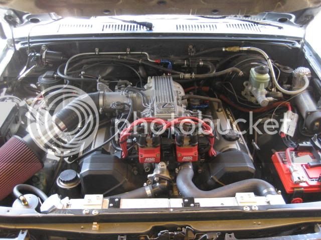

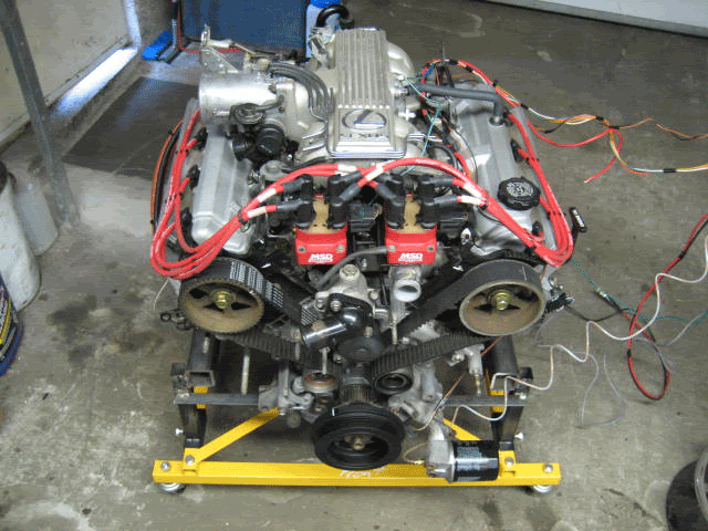

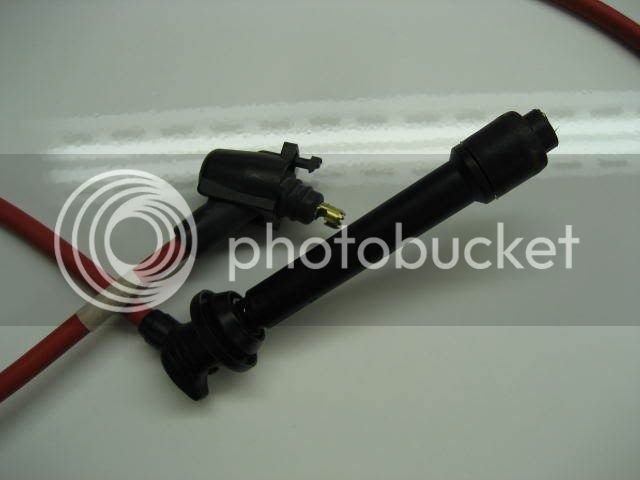

Hello all i had quick question about using the Ford EDIS system with the 1uzfe. What plug wires fit the engine side and ford coil pack side? Is there a stock ford set from another motor or are you guys splicing wires somehow or did you buy some crimp on coil end adapters from accell or MSD? I looked at getting a set for a lincoln mark VIII but the plug boot is about 2 inches too long. Does anyone have a picture of their motor with the edis system fitted?
Mine is working with the EDIS system but i'm using a hacked up set of mustang wires to run it and want something better looking.
thanks
Paul
hi
i just approched a ht lead maker in my state and they made me a set.
i told them what ends i needed on them and how long i needed them and supplied them to order.
i payed $180aud for mine
try google there will be someone near you
