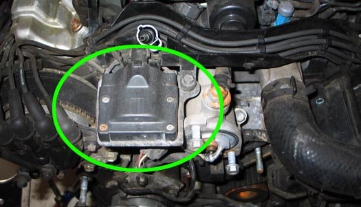

I just realized that I don't have an ignitor for this motor. Are all 1UZ ignitors created equal? Anybody have a pic of one so I get the right thing?

Depending on what engine you run the igniters are different.
The Crown and SC400/Soarer use different plugs. They don't interchange.
Some Corollas use the same igniters as the Crown but I can't tell you which.
Try getting a part # from your local Toyota dealer and then hit the wreckers.
Well I just hope the SC400 and the LS400 use the same ones. I think I just bought sc400 ignitors for my LS =] I need to get my show (project truck) on the road!
As long as the plug plugs into the igniter it will work.
Don't forget the igniters needs to have a good earth.
Yep I got that loud and clear. I took my Tacoma into the stealership (friend worked there so they hook me up) because it started running horrible all the sudden. They replaced the ignitor just on a guess and it didn't help at all. They didn't even clean the crusty mount where it's located and it still ran crappy. I just took it back after a couple more days and after 10 minutes of looking I realized a ground strap had broken that grounds the rear of the engine! I cleaned off the dirt on the ignitor mount/ground and put in a spiffy new cable for a ground strap. I still have that spare ignitor... wonder if it would work for my 1uz...
I was at a wrecking yard yesterday and took down the part # of an ignitor for a 1990-1991 LS400 #89621-12010. This seems to be a very common part. The wrecker wanted $100 for ONE and I laughed. :lmao:
You can find these on Ebay for pennies.
To all those with Crown engines please note the LS400 and Soarer igniter doesn NOT fit the Crown loom.
Actually I'm going to use the ignitors I have for my trucks 3rz currently. They show the same part number so I'll just change the connectors out on the harness. There are some SC400 ones on ebay for 30-40 all the time (which should work once the connector is modified) but I think the ones I have now should work.
