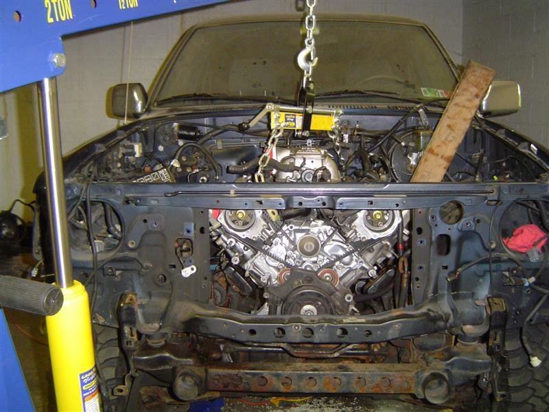

I am hoping to remove my 1" BL, but I'm still not sure that can happen yet. Going for low and planning to hack my fenders/footwells.

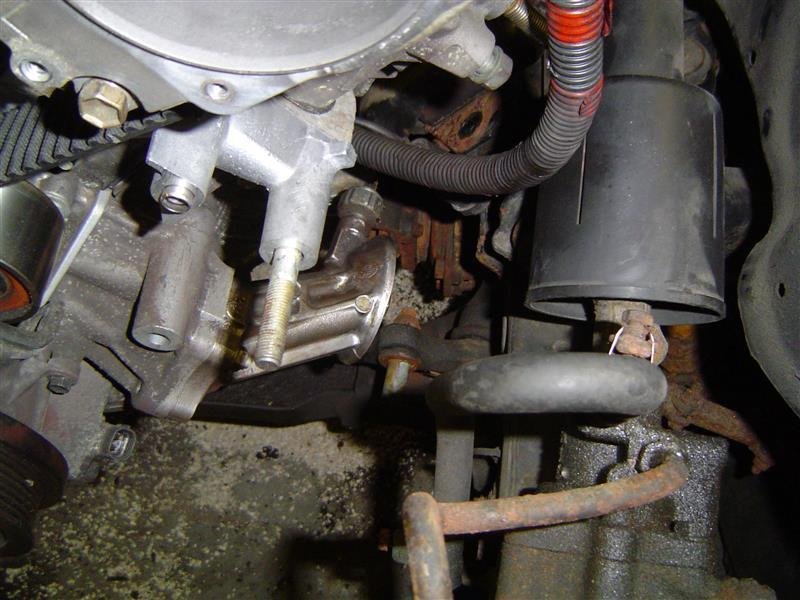

Did another trial fit of the oil filter mount. Framerail clearance is an issue.

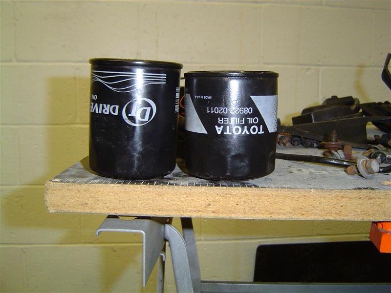

On the left is the 1UZ filter on the right, the 3VZE. Neither of them make it.

Looks like a relocation or more of a block hugger mount is in order.
Not sure yet, but it appears that the stock steering stabilizer location can be reused. Might be tight with the beefy OME though.
