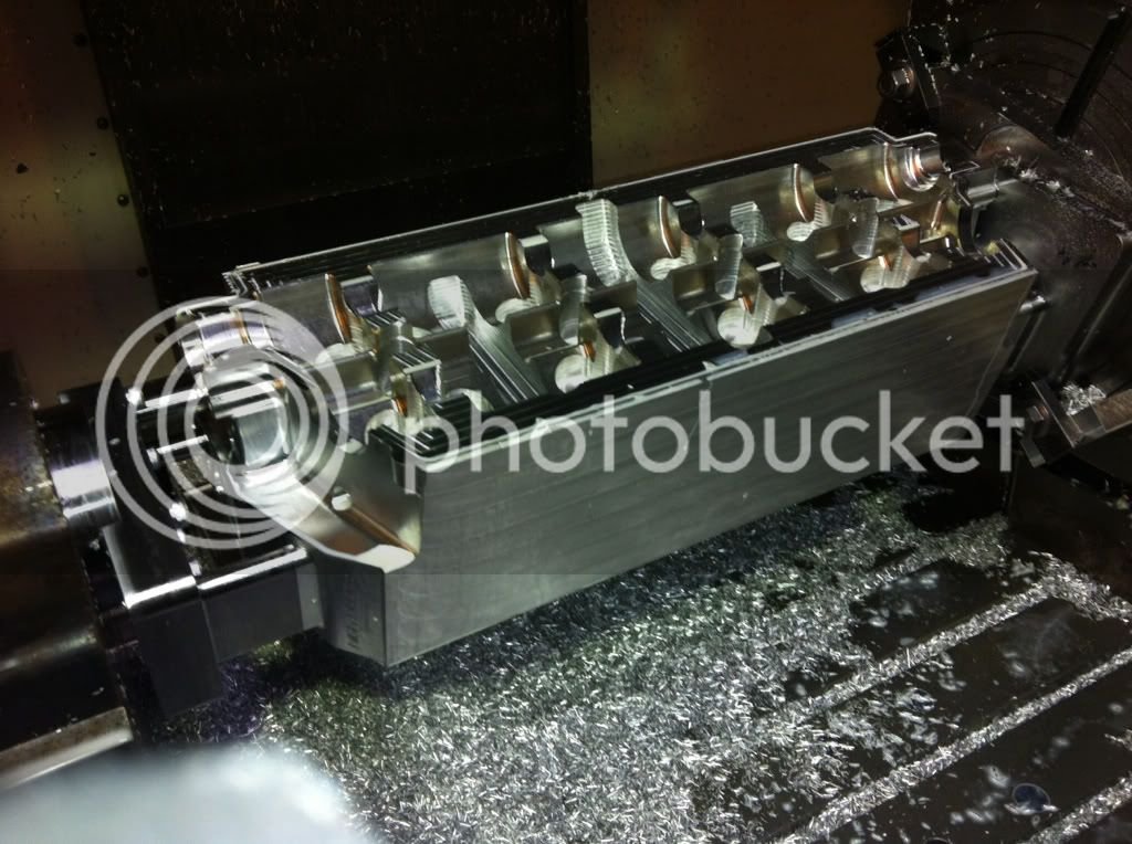

Received the new billet crank - just gorgeous piece of art - went to hemi mains so I can get better race main bearings. Big ends are chev small block large journal.
Had to remove quite a lot of material from the block to get the rods to swing with the 3.75 stroke. The block is over 1 inch thick on the sides no plenty of material left.
Have the new liners for the 3.85" bore, and flat top CP pistons at 11:1 comp. Had to lift the gudgeon pin right up into the oil ring groove to use the chev 5.7" GRP ally rods. Much better blown alky rings this time too.
New billet heads are now in the CNC machine getting cut from Alumec 89 ally. A new billet manifold has to follow - with nice o-rings on the inlet face instead of gaskets.

Wow Paul, are there any Toyota bits left in that engine? Bore spacing maybe? :)
Show us some pics of your new crank!
