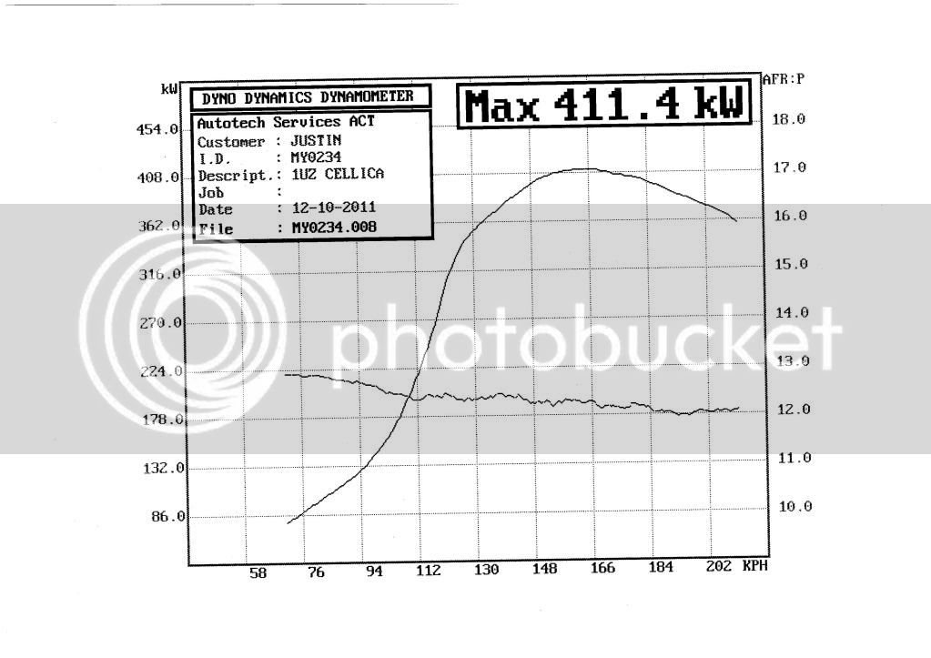

So breaking news. Back on the dyno to sort out a weird lean spot that developed. Ramped up the new boost controller too On 14psi the car reeled off 365rwkw and just kept making more power the more timing we added. Still more left in it but i feel for the stock bottom end so didn't pump the ign adv boundaries any further. We did wind up the boost though. On 17psi.....
... am I reading this correctly ?? 17:1 afr? Thats mad lean! My uz popped when my gauge read that high but then again I was a bit mad that day
Amazing power Justin, and im guessing on E85/E98? If its ethanol, and you successfully pulled that much power at that AFR... im sold on the safety that goes along with it. I would like to see a 2J pull that kind of power at that low os boost.
I guess I read the AFR right side of the graph as if it was referring to the 400+kw line. I read the plot thinking that the 400kw was at a super lean 17:1. My mistake, got the x/y jumbled up
Geez, you have got to be happy with those numbers Justen, rather impressive! What sort of torque figures did you end up with?
I am getting so eager now to get this E85 happening and bump up the boost some more. They are definitely proving to be an awesome pairing when applied together.
