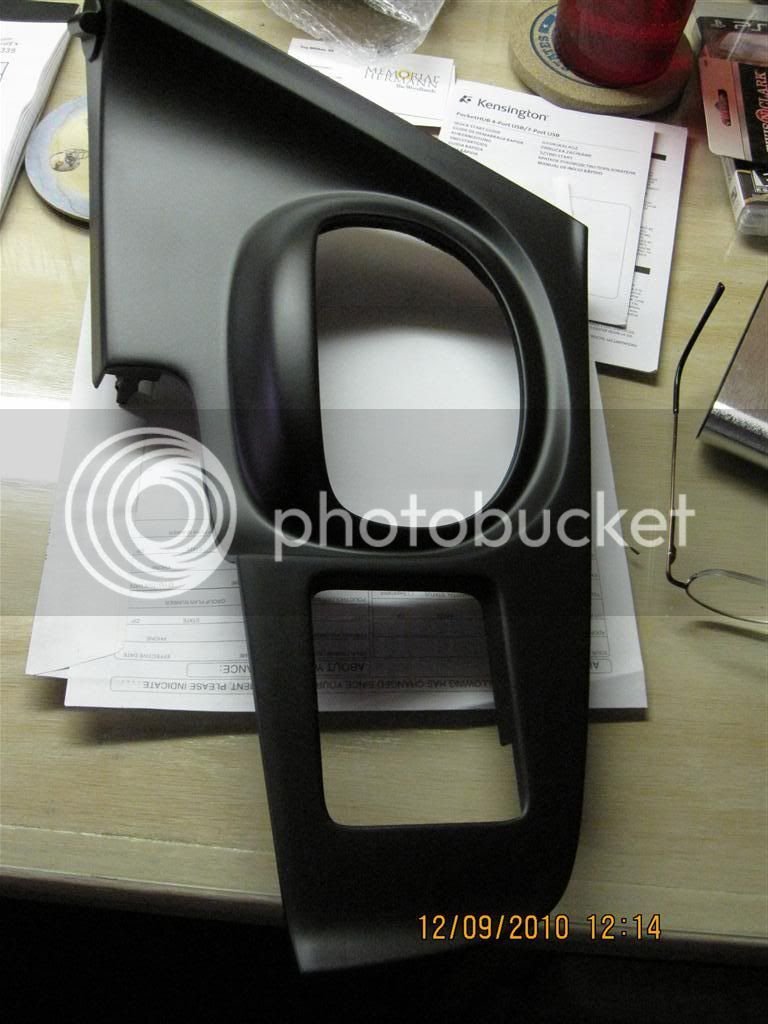

The plastic filler wasn't available in small quantities at the paint store, so I picked up some Bondo for scratch filling. Now I wish I hadn't - that stuff was supposed to cure to a sandable surface in 4-6 minutes, but it's been 4 hours, and it's still tacky. That door panel is the last piece to be painted; all the rest are finished and are curing overnight, so I'll reassemble the dash tomorrow and take a few more pics.
Any latest pics? I may recoat my car's interior later on. As for Bondo that take more more time to dry, it could be the hardener is not enough. It normally cures within 30-60 minutes.
Tried taking some flash pics, but the dark colored panels are fooling my digicam, and I'm not smart enough to override the settings. I'll try to get some pics in strong daylight today, before I put the panels back in. They came out really well; the SEM paint is very forgiving and made me look like a much better painter than I am.
Edit: Not so thrilled with the clear coating on the main panel (the $200 one) and the ashtray. Under strong light, I'm seeing some subtle color differences here & there - almost like shadows, so I think I'll scuff them up, put another layer of the black over the clear, and call it good. I don't know if a color coat should be applied over a clear, so I'll practice on a junk piece first.
I'm really PO'd about this Bondo; it's still tacky after letting it sit overnight. I even hit it with a hair dryer last night to help it cure, but it's not working. This wasn't the conventional stuff in a can with separate hardener, it came in a single tube, and when it came out it looked more like liquid glue. I had misgivings about it then, but decided to press on anyway. Big mistake. I'm going to try sanding it, and if that doesn't work, I'll try to get the stuff off completely.
I can see an emergency order to Curt Aigner for a new switch panel looming on Monday....... $30 for this little chunk of plastic, but still better than if I'd screwed up one of the other panels like the one with the radio cutout and HVAC controls. That little puppy has a list price over $200 and still costs $150 with our Toyota parts discount.
Edit: the Bondo sanded OK - it was just the surface that was tacky; underneath it was solid. This piece is now primered and looks fine.

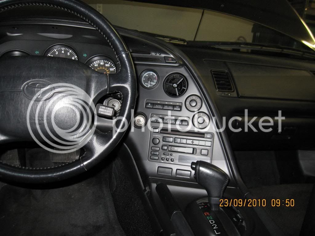

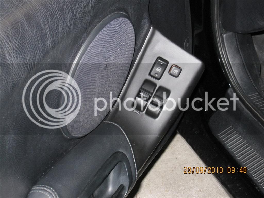

We had a couple of days of rain here, so I didn't get any good pics of the panels before I put them back in, but here's some shots of them after installation:
The driver's door switch panel that had all the scratches:
The main ($200) panel that I was worried about screwing up:
The shifter/console panel:
They all came out really well - the SEM paint was the key.

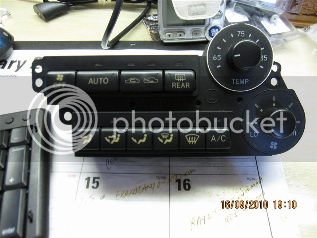

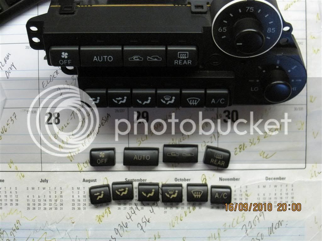

While I was at it, I decided to replace all the A/C buttons on the dash. These are a well known issue with Supras as they get yellowed and funky looking with age. Here's the A/C panel with the old buttons:
And the new buttons:

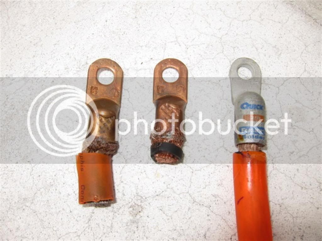

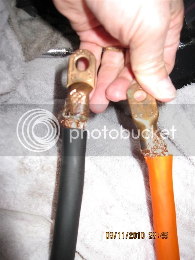

Here are the battery cables that I paid to have "soldered":
Pretty ugly, eh? Obviously they're not well soldered, and I'm guessing that the shop probably tried to use a soldering iron, or didn't have a large enough torch, didn't prepare the cables well, used the wrong size lugs, etc. You name it, they screwed it up. To make matters worse, when they failed at the soldering, they tried to smash the connector in a vise to finish it off, then covered their tracks with heat shrink. If the positive cable hadn't been done so poorly, and hadn't had that little dogleg in it, I probably wouldn't have noticed. But as soon as the heat shrink came off, I knew I had problems.
These are the ends I cut off, and on the right is an end that I soldered, using a proper sized torch, and the right size lugs with their own solder & flux pellets. I also cleaned the cables thoroughly before soldering, and melted some rosin flux on them to be sure I'd get a good joint. Soldering big cable terminals isn't exactly a snap to do, but it sure ain't rocket science either:

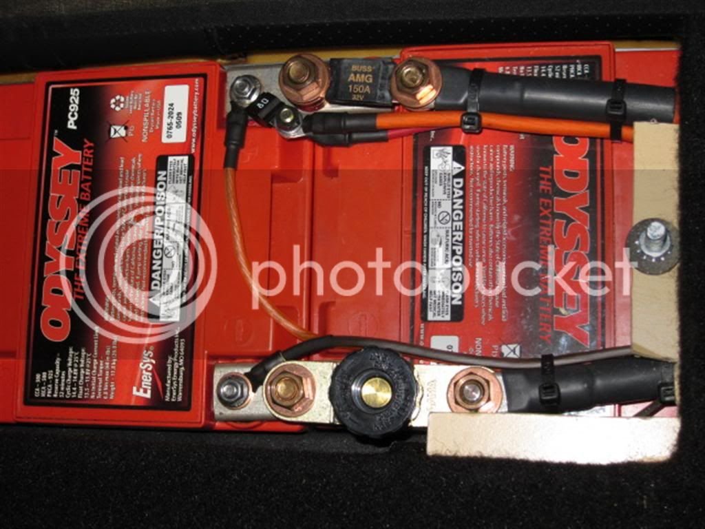

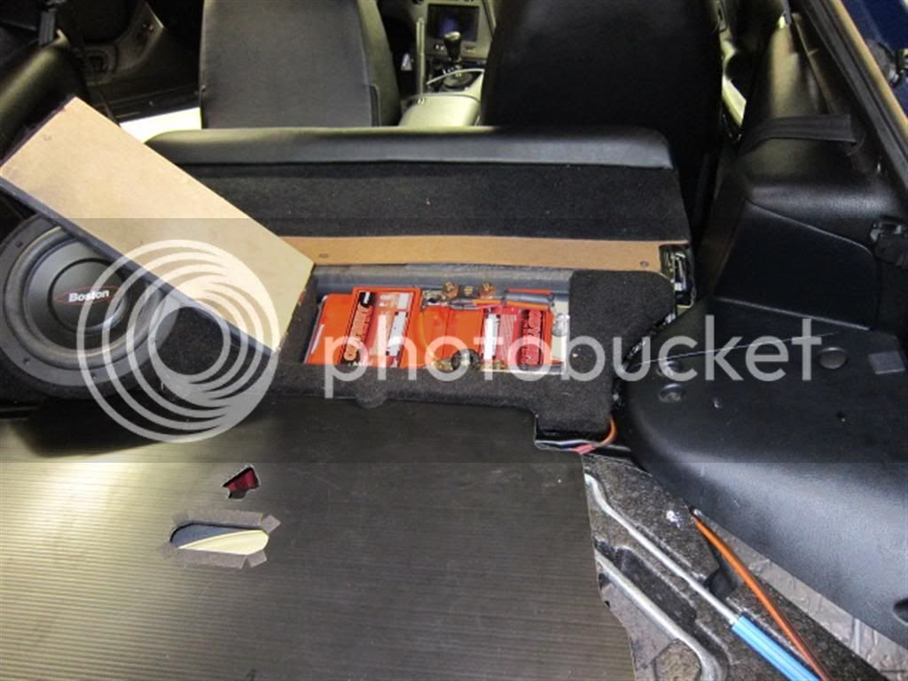

So here's the finished product, properly soldered, with heavy duty heat shrink tubing, and terminated on the batteries. That dohickey with the round knob on the negative side is a battery disconnect switch:

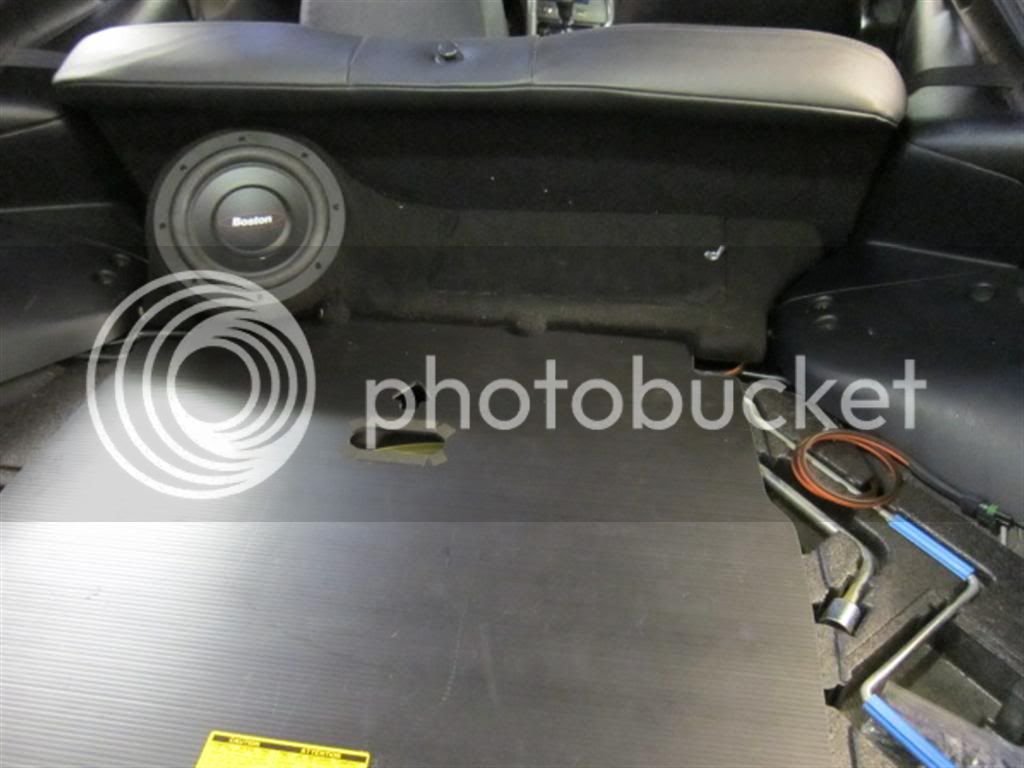

Here's the hatch access:
And covered (that coiled cable with the Weatherpack connector is a quick connect setup for a battery charger. I wound up putting that in plastic loom, which really improved its looks.):

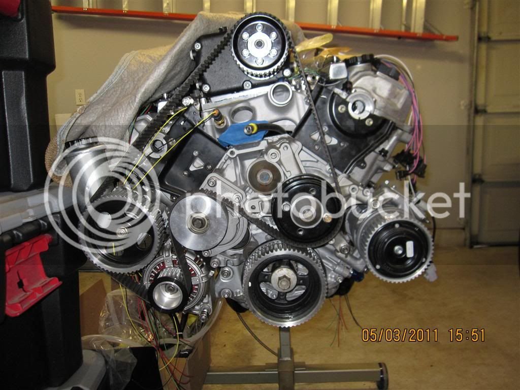

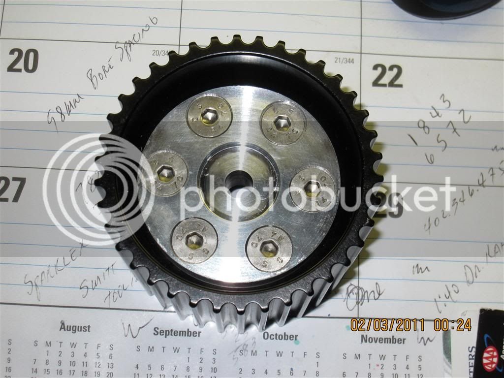

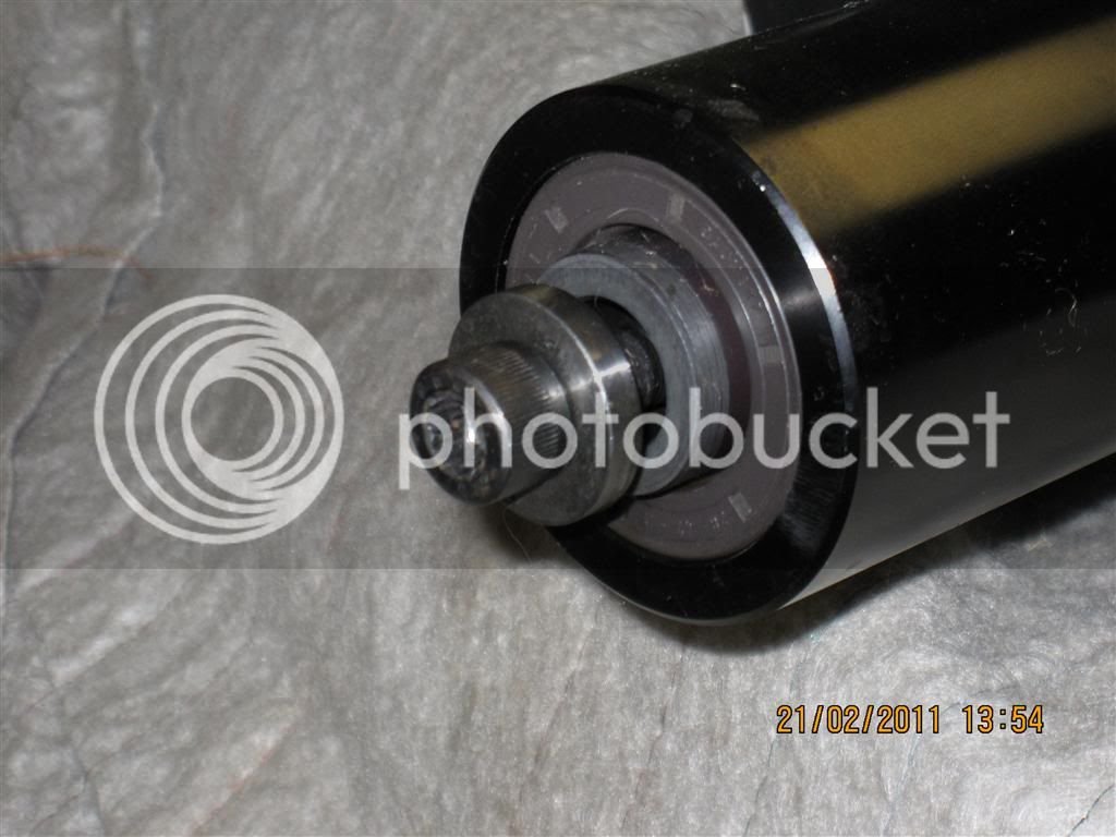

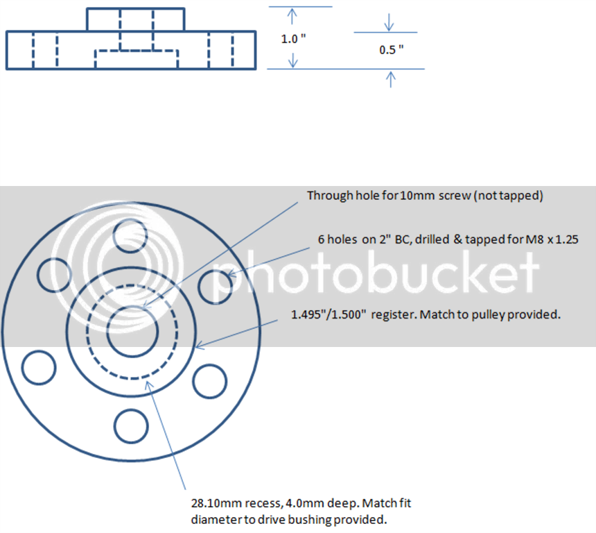

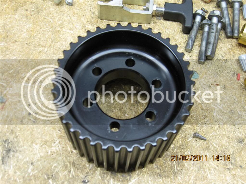

Made a bit of progress on my supercharger drive setup. The last of the pulleys (the supercharger pulley itself) arrived, and all I had to do is figure out how to adapt it to my supercharger.
So how do we fit this:
Onto this:
Well, we make one of these:
Then it almost turned out as drawn, except my ace machinist missed the note about TAPPING the holes for M8x1.25, so then he had to go back & countersink them:
So here it is, on the ‘charger, and I’m checking belt alignment. For all you real smart guys, yes I know I missed a few pulleys with this belt routing! This is using the stock timing belt just to see how the pulleys line up – and they’re not bad!
Unfortunately, this is about as far as I can go with it this time, as I’m off to play in the sandbox for a month. Next time I’ll get the idlers squared away, and make sure I have all I need to drive it on the dyno.
