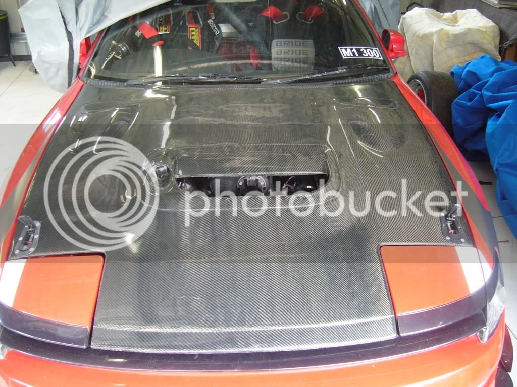

Now you see it
Now you don't :)
excuse the exposure, dunno what was going on there?

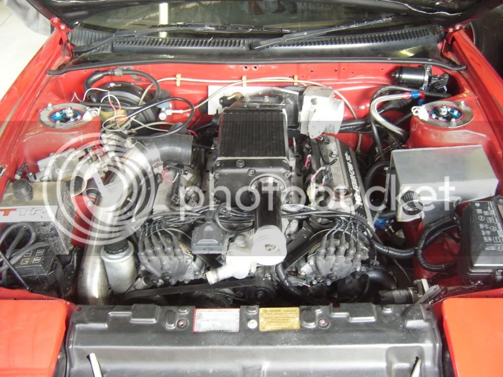

So test fitting the bigger SC in hope of a new and improved twincharge setup. I'll have 1200hp of turbo on there too :) I'm not chasing quite that power but nice to have Veyron levels for a poofteenth the price ;)
Looking the goods Justen. Should certainly liven things up a bit hey?
May I ask what make and size supercharger that one is?
That is Rod's 1.9 (?). I have a Kenne bell 2.4 to go on though :)
Still some measuring, test fitting etc to go so could be a while (if at all) before i have twin charge on board again.
Justen, I "think" Rod's charger is/was the same as mine, the 2.2 liter Opcon-Autorotor OA-422MX
