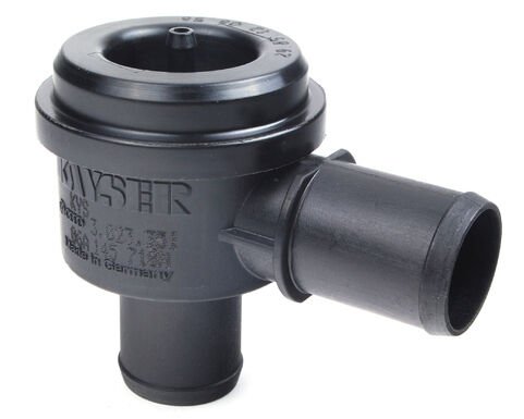

Bypass Valve: Audi TT and Porsche 710N Bypass Valve
Part # 06A 145 710 N
This is what the mustang guys use to upgrade the bypass valve that comes with the vortech kits. The 710N has metal internals and is great bang for the buck. Only $50!

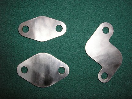

All that's left to buy is the vortech pulley, belt, piping and some miscellanious wiring to relocate the battery to the trunk. I also have to copy the EGR Delete & Fishbracket that my friend's have (would order from lextreme but parts ordering is hopefully only temporarily closed). Apparently the EGR delete is necessary or you won't build boost (you get boost leaks). From what I read I need 7/16" x 127mm bolts and 103mm spacers (the spacers I'm not 100% sure, this is from what I read on a forum). It's too bad I can't order the bolts and spacers directly from Lextreme right now.

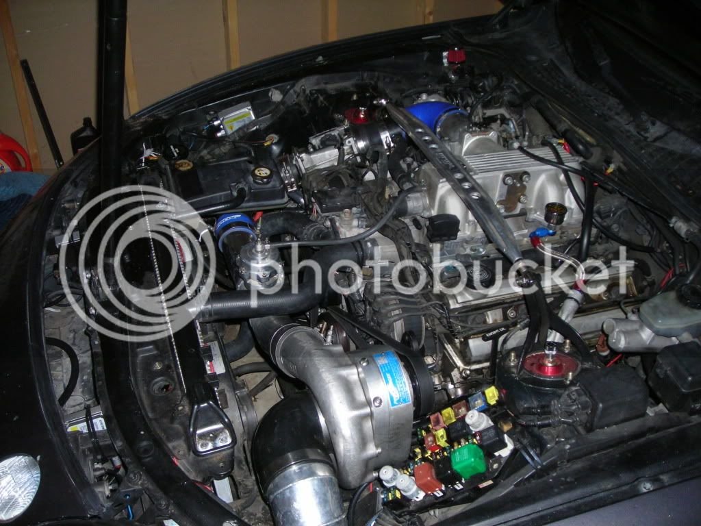

The plan is to have the supercharger piping setup looking like this (not my car. SPF's car who is on Lextreme.):
