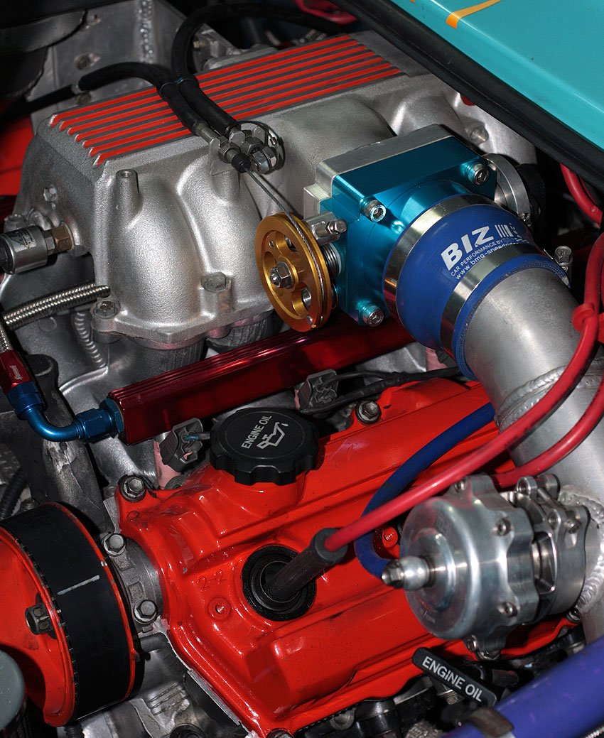

Thanks guys for your time and interest . . . and recommendations. With the small Vortech V9 supercharger making only 8+ pounds of boost or so in the 4000-6800rpm band, I want to stay in that rpm zone as much as I can throughout a 1/4 mile run, so the three-speed auto makes more sense to me. Remember these 1UZs are only 242 cu. in. (4.0L) - not a big block with gobs of torque. I suspect my car is right on the borderline for having enough torque to take advantage of a Powerglide. My car weighs around 850 kilos (1870 pounds).

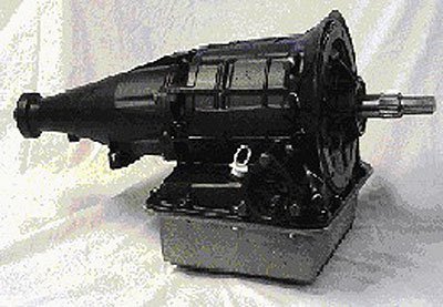

example of my powerglide:
std oem 1.76 gear set, std housing, std 6 pack high clutch, std 6 pack reverse clutch pack, and a name brand low gear band, and 235-240 psi trans pump pressure, we did over a 100 passes @ 1920 lbs in the high 6 second, low 7 second range.
saying that, you power glide with cost you miniumal to build, and maintain.
once a year overhaul, and all is good..
