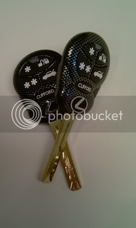

Hah..hah..Interesting...The first carbon fiber remote. :D
Steve, thanks.
The remotes come with the Clifford G5 alarm system. I took the remotes, opened them up, removed the key chain and epoxyed the actual Lexus Keys into the remote. I had to remove the plastic key fobs from the actual Lexus keys and then hacksaw off part of the metal end of the key so it would fit into the remote. I used a special epoxy so the key can handle the torque from twisting it when opening a door or starting the car with the key, even though that isn't needed, as the remote will open the car keyless, and remote start the car as well. I wanted the remote to be integrated with the key so that it takes up less space in my pocket, and and so the key will look like an OEM upgraded key or perhaps a "Special Edition" key package from Lexus as an OEM option.
The Lexus Logo is an actual Lexus Key Fob logo, that was removed from actual Lexus keys and attached to the front of the CF remote.
I am also having individual "form fitting" leather pouches made for each key which will open in the front of the pouch to access the remote buttons. This should keep the keys from getting scratched up, and still not be bulky in my pocket. I only want one bulky thing around my front pockets, and I was born with that permanently attached to me :D:rolleyes::eek::cool:
