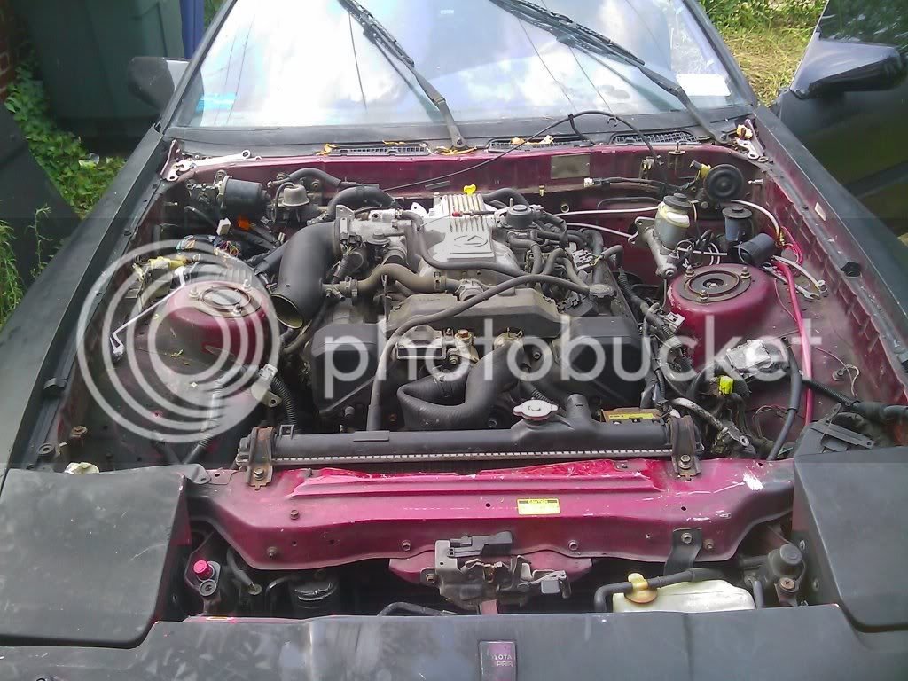

ok so yesterday i got the fuel all sorted out (i think)
i bent the stock 7m hardline into place
its a little bigger than the uz banjo but the washers still seated properly.
todays chalenge is the brake booster and the wiring
crunch time
the car has to be driveable by saturday when it must be moved from its current location
i got the brake booster on its kinda wierd tho that pedal is hard as a rock and only moves like a half inch.
went out and had a custom fuel line made and got rid of that hardline(found that the banjo was too big)
all thats left is wiring

OK now i have a bigger problem NO SPARK!!!!!!!!
im getting plenty of fuel and air but no spark
i pulled a plug wire and a plug and tried the old spark jump trick and nothing at all.
what did i miss???
OK got its sorted out and SHES ALIIIIIIIIIIIIIVE!!!!!!!!!!!!!
and for some reason overheating within seconds of running
took the thermostat out and its still overheating
any ideas?
any ideas?

got the girl up and running without a problem
temp gauge is acurate
now im actually overheating
lol it takes much longer than before but its now truly overheating even without the thermostat in her.
im about to go check the lines at the back of the motor and see if they are run right or not im kinda stumped
i only made it halfway home before it overheated and steam came out one of the coolant lines on the back of the motor
I just stumbled across this thread, from google. Taka get a new thermostat and put it in the motor, 1uz will over heat with no thermostat to control flow becouse they are a double bypass system. with out the thermostat the waterpump will pull water from the engine and pump it back into the engine and not pull water at all from the radiator. water lines at the rear of the motor almost dont matter as long as they are not leaking. also make sure all of the air is out of the motor. use the nut by the thermostat to get the last bit of air out of the motor.
ok ill drop the thermostat back in in the morning , and hopefully find that nut
i opened it a bit and didnt see where it went when the coolant shot out.
does anyone know the actual thread type that the nut is or where i can get a new one (just in case i cant find it.)
