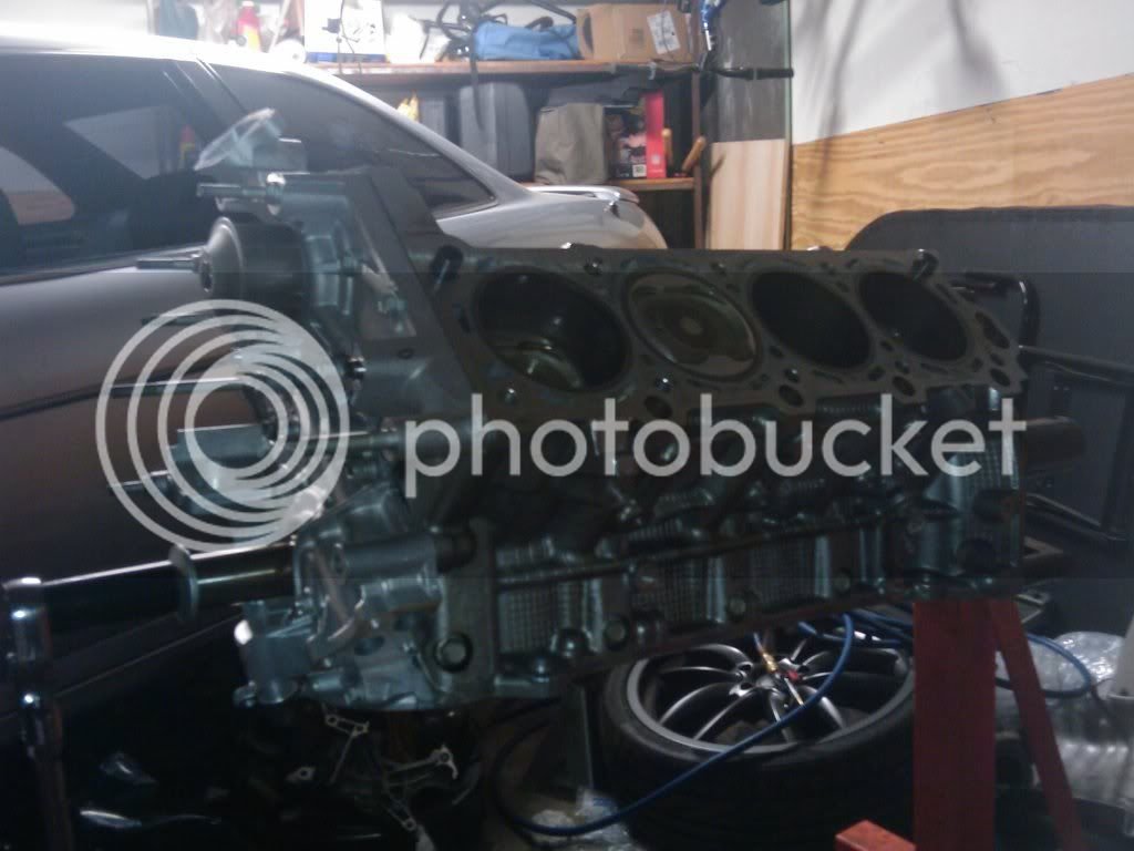

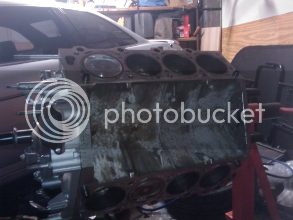

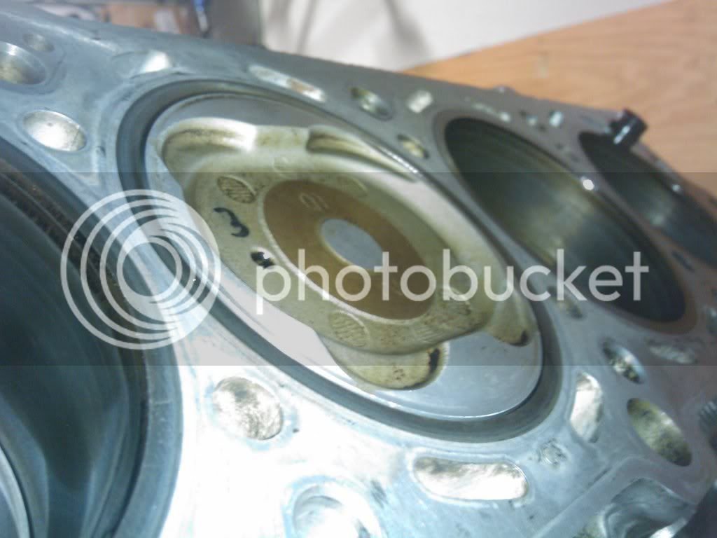

Damn it, I effin ordered the wrong rod bearings. The messed up thing is that i took all the pistons & rods down to the lexus dealership, w/the info sheets that told me/us how to know which standard bearing to use. 2,3,4,5,6,7. Well it says the # for the bearing is on the backside by the notch. BUT if the bearing # is not able to be seen, then use the # on the rod cap ADDED to the # stamped on the first lobe of the front side of the crank. Then use that # bearing. Ok so all my rods are stamped #2 except for #1 piston. It is stamped #1. So im thinking I need (7)#2 & (1)#1. Ok cool I got 7 #2 on order & now you need a #1, well i dont show a #1. So we all read the info again. Then I take the rod cap for #1 piston, pull the bearing out & there is a 3 on it. He says do you know what the #s on the crank are? NO. He says well 1+2=3 so ill order 1#3 & 1#4 w/the 7 #2's & we should be good. go home & look @ the #s on the crank & add them up & call me back. There all 2's on the crank. So cool 1+2=3, were good. I didnt realize till after disassembling 7 pistons, cleaning all the carbon off ALL the rings,piston, & installing all the new #2 bearings, that i didnt do the math right with the "7". 2+2=4. The 7 all have a 4 on them. Damn im stupid. What can i say 1st timer. My only shot is if i get lucky that a toyota dealership local has 6-7 in stock or my hole weekend is shot.
No one has them in stock, will be tuesday before i get them. So now im trying to get everything cleaned up and ready to just assemble.

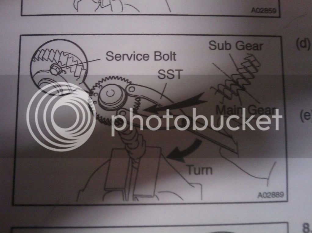

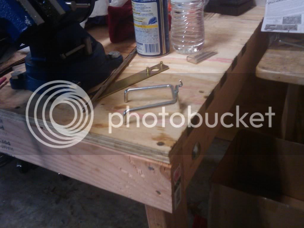

So I was pre loading my cams & didnt have a spanner wrench tool. So I went to a couple of auto parts store's & no one has it. So i had to improvise. Somtime its funny what kind of stuff you can find to work as a tool. Check out my custom spanner wrench/peg board hammer holder L O L. Total worked & cheep, hell i got 3 for $2.49.
Yep just remember to take the bolt OUT !!!
Aww man i was gonna leave it in there to make the cam stronger, for all this new torque im gonna be puttin down. Its gonna need every bolt i can find to put in it. Any place i can find a threaded hole is gettina bolt :D:p
