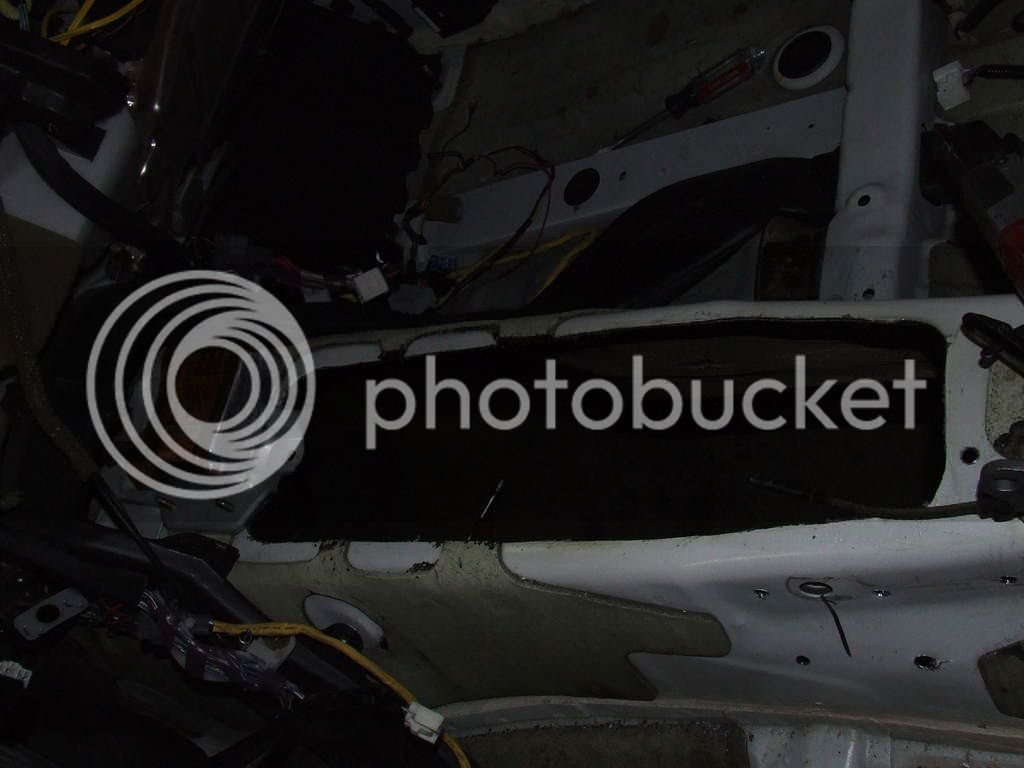

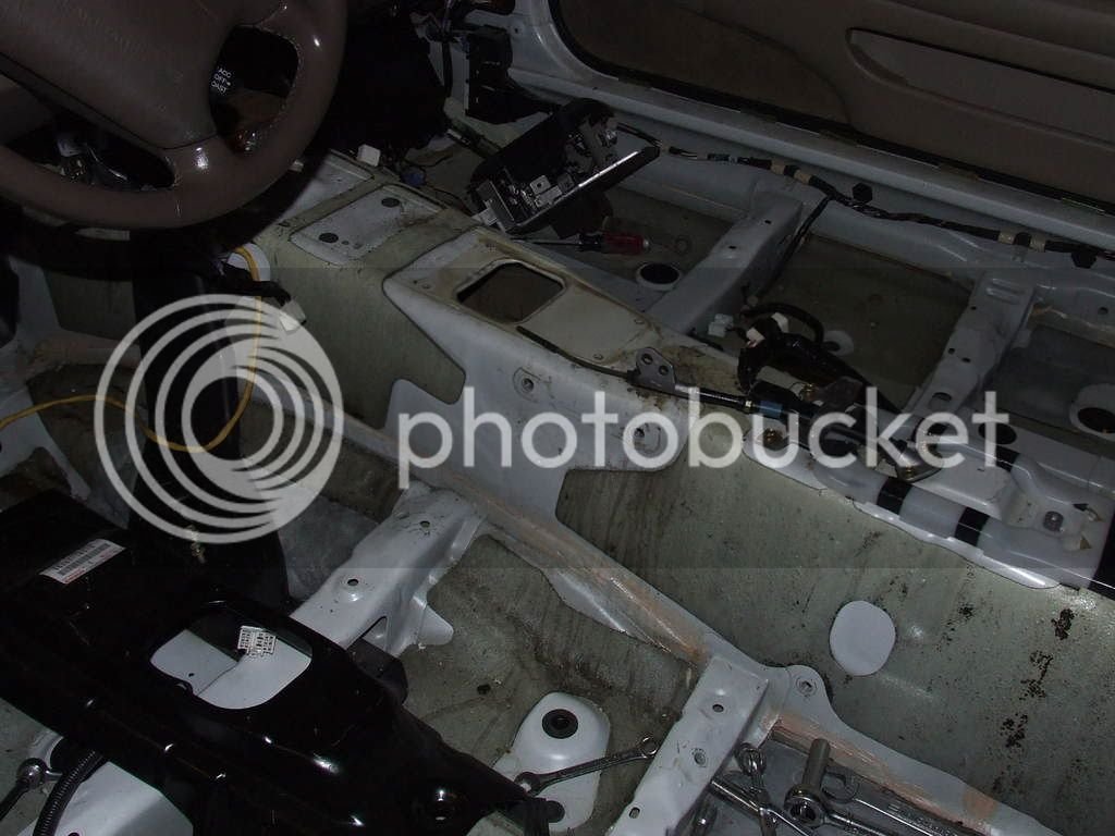

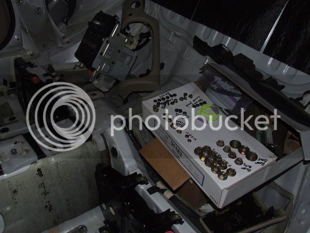

First I gutted the interior, I'm upgrading it anyway so it had to come out.
Now the great part! I did a lot of measuring and it apears the shifter will come up in the right spot!woohoo.gif

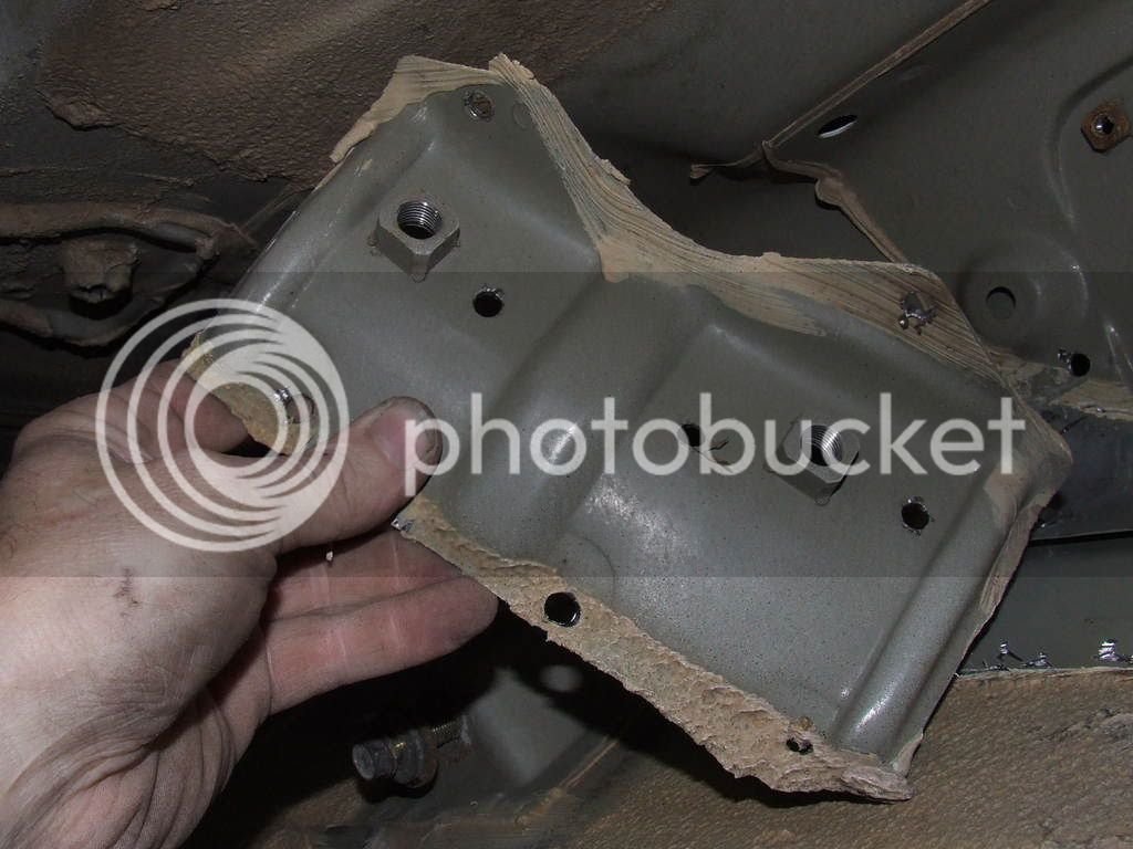

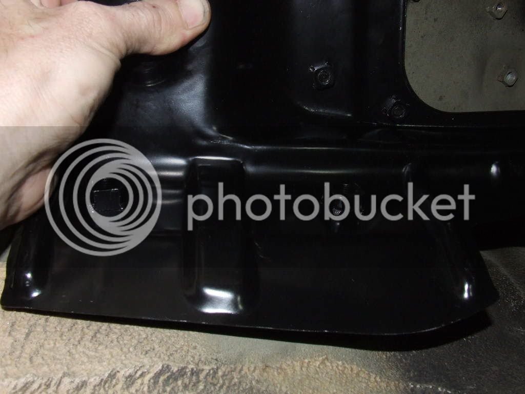

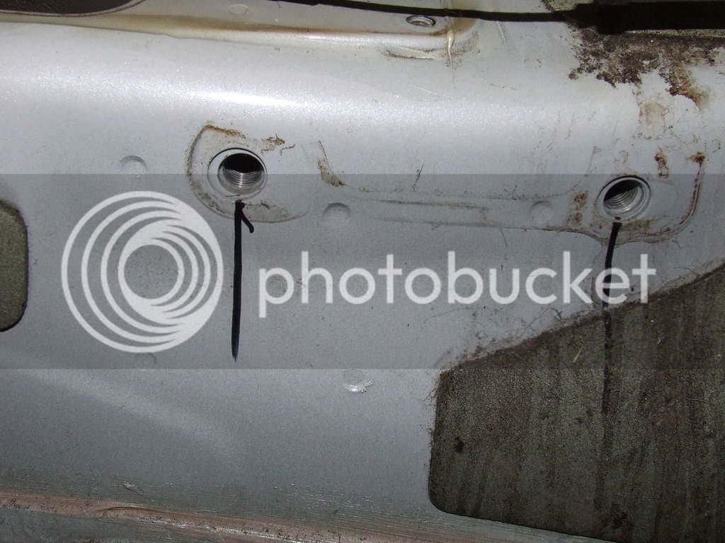

The first thing that has to go is the E-brake bracket, No problem, the tunnel will replace it. Here is the said bracket, the one with the two large nuts on it.
Here is the replacment part on the new tunnel.

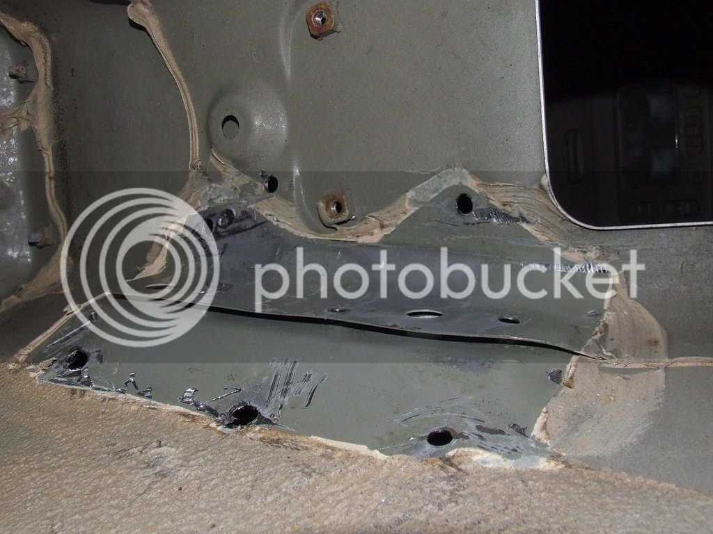

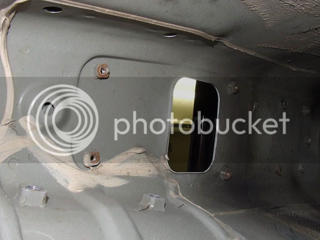

Here it is on the inside, Note all the spot welds!

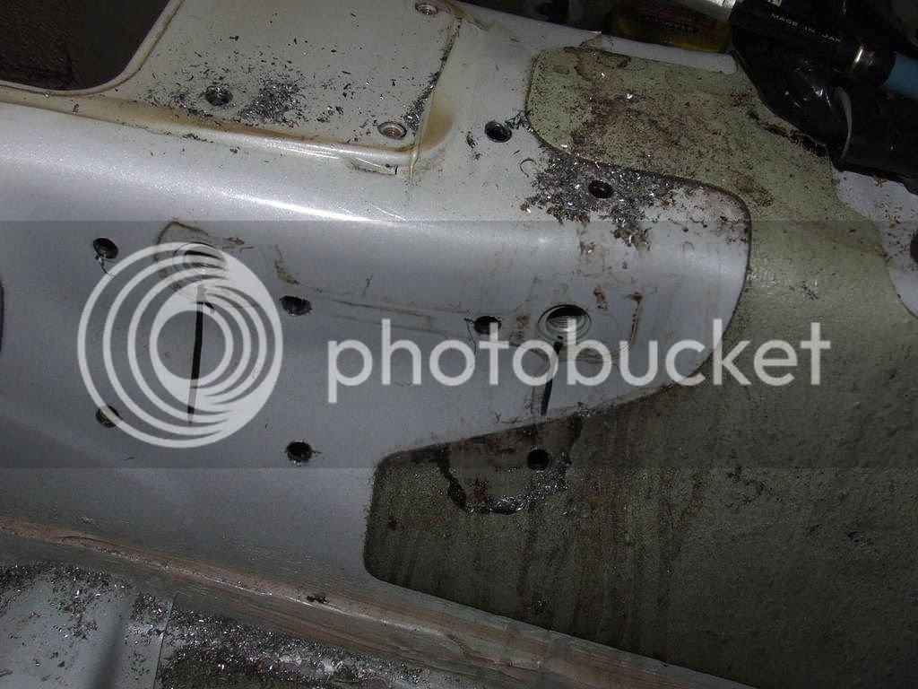

Get a drill with a 5/16" bit and drill all the spot welds out as shown here. Once they are all drilled get under the car with a hammer and chisel or a air chisel and knock the bracket out.

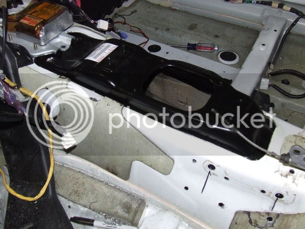

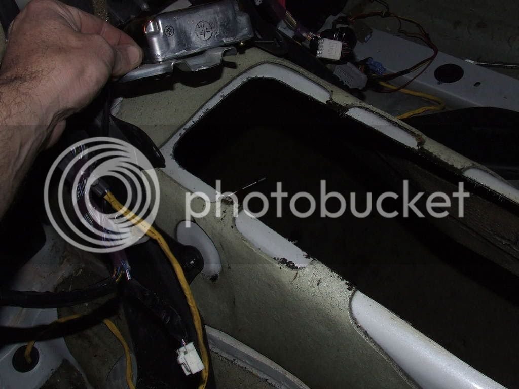

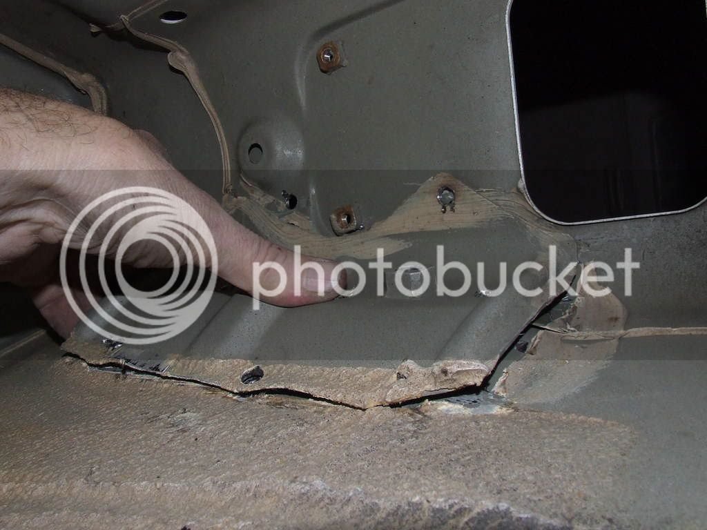

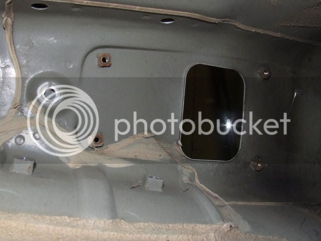

Next you need to cut the hole. There is already a line stamped in the tunnel, just cut on that line and it will look like this.

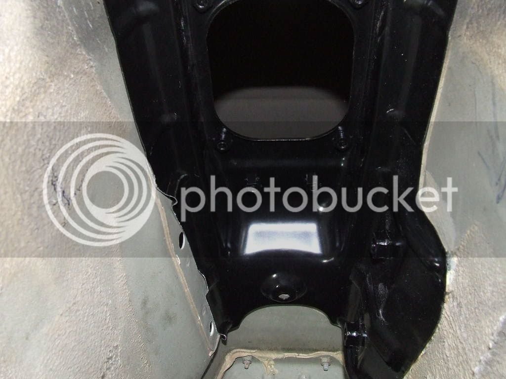

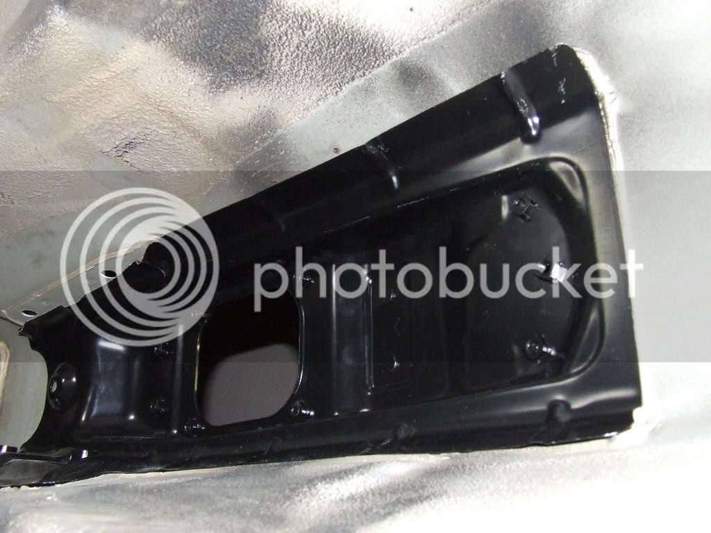

I had to cut one side of the supra tunnel off, it was the e-brake for right hand drive, they make it fit both.Next the Supra tunnel come up from the bottom. I just sat it in for pictures, I will be riviting/welding/sealing it in soon but for now here it is. Its like its made for it.

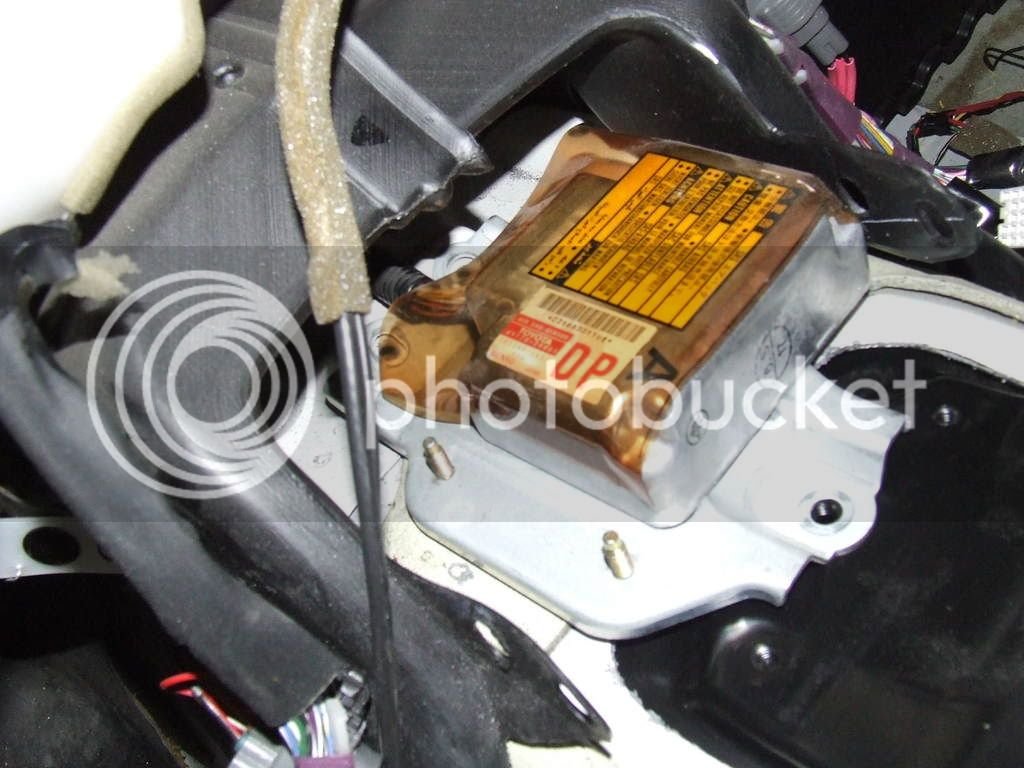

Look how it replaces the bolt holes up fron for the airbag modual mount and harness mount holes right to the stock location, and those ebrake holes I removed? Right back where they started. Sweet!
