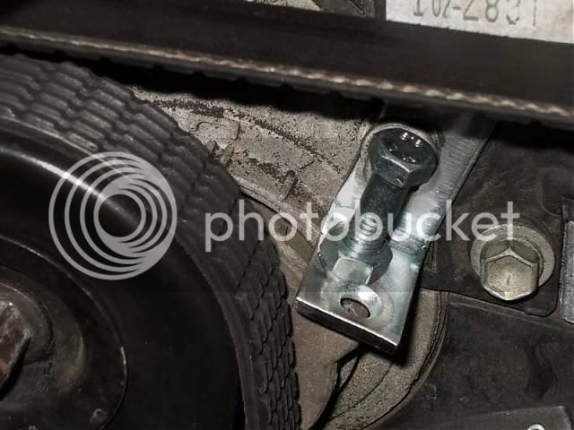

Here is my version of it.

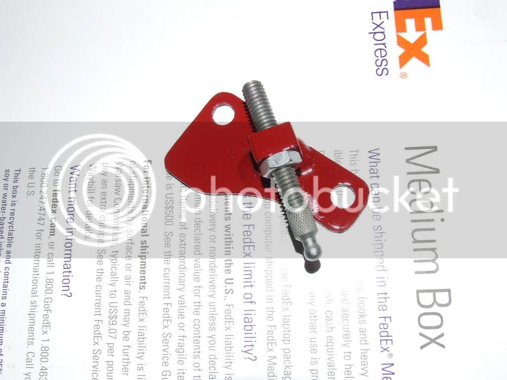

Spare Mock up motor for referance.

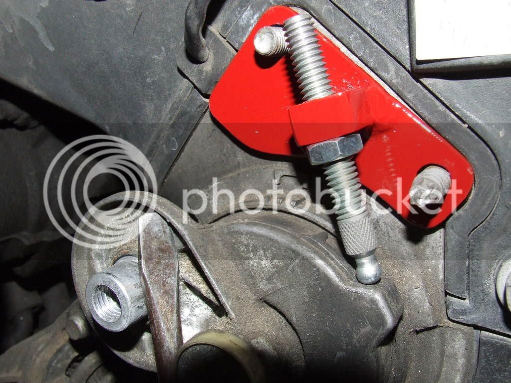

Installed on my car.
