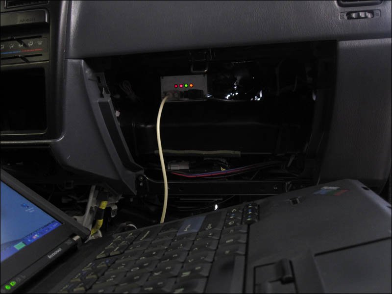

Just a quick update. I have the Adaptronic all wired up in its home in my glove box. Since I have all the wiring done right I have wrapped it all up and it's nearly permanent at this point.

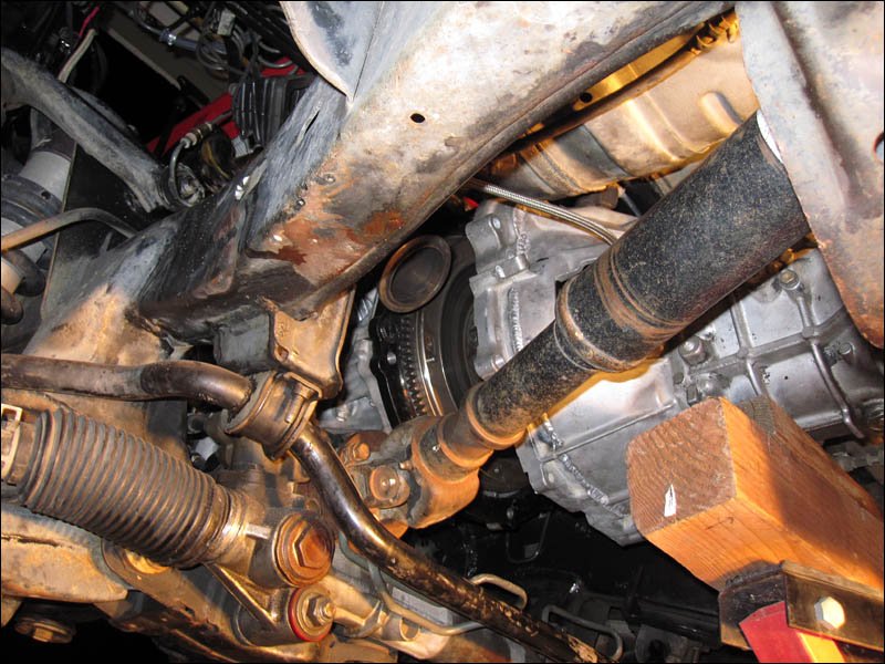

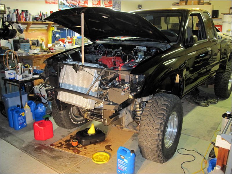

I also put the wheels and drive shaft back on the truck so you KNOW I'm getting ready to drive this sucker. So with the new ARP hardware (thanks to Mr. Lextreme : ) the wiring operational, radiator sealed up and not leaking, clean oil and a makeshift intake hose I've nearly completed the swap. The last thing I need to do in the morning is make a couple brackets to hold the tranny crossbrace in place for the time being. My gearbox sits a little higher than the stock location and I'll be driving it to a friends shop to do the welding there next week. It's not a huge operation as this will only take me half a day to cut and reweld a couple things.

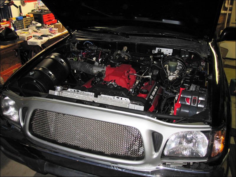

The front bumper, grill and headlights all fit right into place and bolt together really easy. It's just nice to work on it without all of that stuff attached.
The truck idles up perfectly and idles down when it gets up to temp. I revved it out a couple of times and boy does it sound good! My neighbor said, "that sure don't sound like a Lexus!". This is going to be fun.

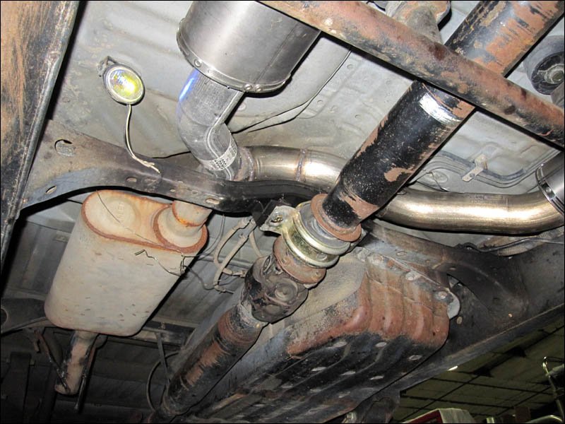

Your exhaust solution was stupidly easy and looks like the most effective way to route it.

Yeah I'm loving the exhaust and I'll be making another system to swap in place that will be street oriented (more quiet). The one you see on there now is my offroad system and it comes off with only 2 nuts that clamp the v-bands down where they connect at the headers. I'll be able to swap out the loud for the quiet system in less then 5 minutes when I want to go from one to the other. =]

And for everyone's viewing pleasure I took a video of the engine firing up today while I was troubleshooting the alternator. It starts up on it's own with the turn of the key like it should. I have the Adaptronic tucked nicely under the dash and it's working quite well. Of course the wheezing air sound is the idle speed solenoid doing it's thing. I need to connect that with the air intake system or get a little filter for it or whatever. It's funny to watch my friends come over and stick their fingers in it. They get zapped but it's harmless. It gives em a jump though. :D

Cribbj thanks man. Also this Adaptronic is awesome. Runs nearly perfect and I haven't even dialed it in at ALL yet. It starts up like magic and it idles down when it warms up like it should. All that stuff is easily adjustable. I know a good amount about this stuff and I thought the Adaptronic would be easier but it's a steep learning curve when you are trying to get it running and I'm glad I had to make myself go through some troubleshooting because it forced me to learn a LOT more from their forum and by talking with other owners of the system. I have a lot to learn and I'm glad I have a lot of nerd in me or else this would be hell!

Thanks big C. This thing is a dream come true for me. I popped the clutch out this evening and I should be able to grab a different disk and make it work just fine. I want to take my time and get a performance clutch to match the good flywheel. I have a feeling I can get a 6 puck disk to work with the pressure plate configuration. I'll be taking it around to talk with some race car builders and get their input. I might end up re-drilling it also. I have a couple options. I'll be putting things back in tomorrow and I should be on the road again. I really need to just do some normal driving and easy tuning... that way I can run all the old fuel through it! It's one year old fuel and apparently it's working just fine. I have 1/3 of a tank to use up then I need to top it off with a fresh tank.
Transmission out then in - then out again and in - and one last time... I'm getting really fast at this operation. I'll be able to disassemble the whole truck with just a few hand tools now that I know exactly which ones I need to do anything.

Haha thanks man. I did some great burnouts today! Then when I was in another town visiting some friends at a shop my radiator sprung a leak so I used some super expensive industrial epoxy for radiators. The only catch is that it takes 24hrs to cure so it's parked until I get a ride back tomorrow to go back and get it. :D Now that's custom!
Just a small update. Just been adjusting the clutch and I think I got it nailed today. I also grabbed my old Flowmaster and threw it underneath so that I could actually hear myself think when I drive. It's cutting down the flow a bit but hey, I'm not choking in the cab from the gas now and it's nice and quiet so I can hear the engine now! I love it. I'm gathering materials and components to begin a roll cage so that means all the cross supports will be cut out underneath and replaced with custom cage cross members. When I do this I'll be re-routing a whole new exhaust system probably with just a larger Flowmaster muffler.
