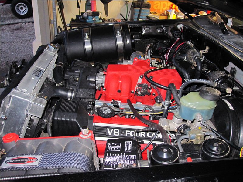

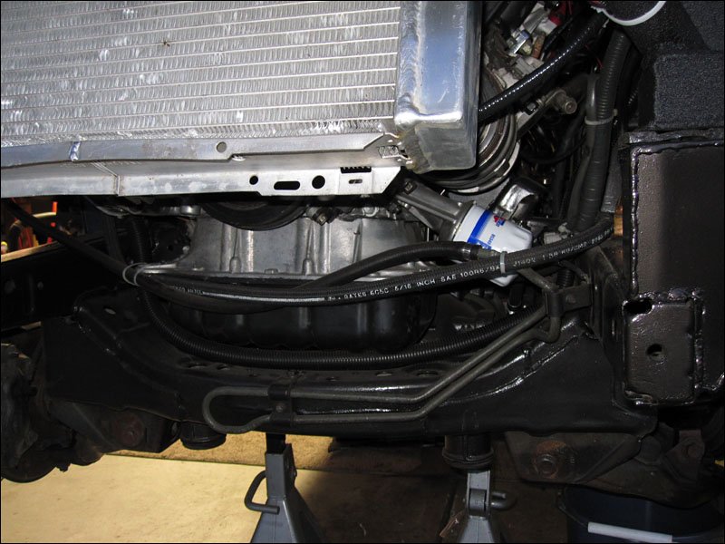

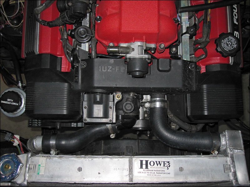

My new hood is on and everything is mounted securely. ALMOST DONE. I even got the radiator hoses to size and it's ready for oil and water. I'll put coolant in it when I'm convinced that nothing is going to leak! :)

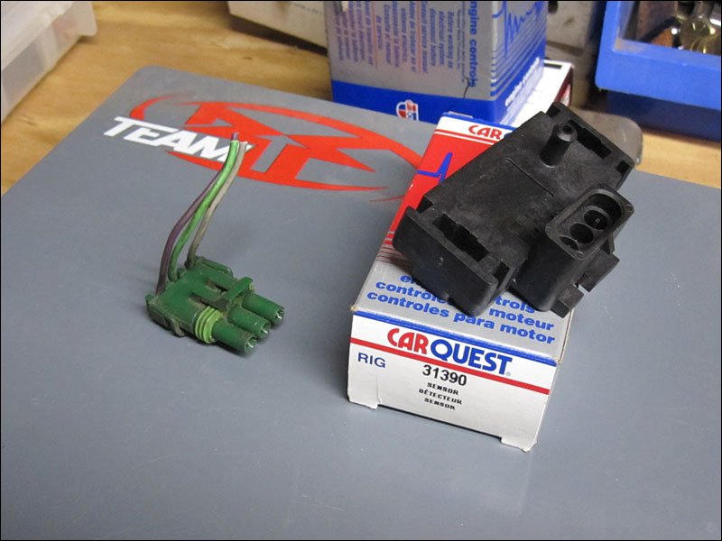

All I have to do is mount the MAP sensor somewhere... preferably where the nasty black spot is on the intake manifold (where all the pesky emissions crap used to go :D). I should be able to fit it there unless anyone has any better ideas? I'm assuming I can mount the MAP sensor anywhere right?
I just realized that I don't have to mount it directly onto the manifold so it's a lot easier to install than I previously thought. Installing MAP sensors isn't something I do a lot of. :D Here is what I picked up. I'll just make a bracket and run a hose to it from one of the existing manifold air tubes - like the one just above the ISC on the front I guess.

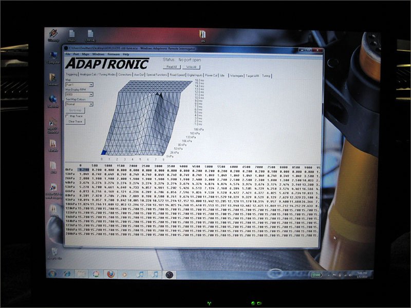

Ok MAP sensor all mounted up - not like it was hard. Now where does this thingy go? I'm kidding! Just another plug in the web of electrical components. I need to order an LC-1 ASAP! Of course it won't stop me from firing up the engine but I'll need it to tune the computer of course.

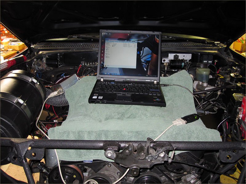

Now if the dumb serial to usb adapters I have would just WORK with my Windows 7 64bit life would be easy... but nooOOooo. I have another hard drive with XP loaded so I'll be swapping these and moving on with loading the program on the unit. Fun stuff.

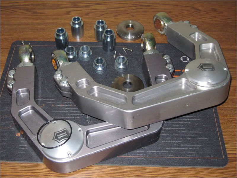

Nice looking arms dude, billet lowers too? Can't wait for your finished product!
What do you think of the wari software? I still haven't sorted mine out but this sumemr will be my D-day (I hope). Keep me informed if you manage to get everything tuned, I have some wiring/software bugs with mine right now.

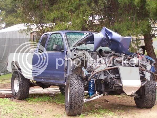

This was what happened when I got a little too aggressive w/ the right foot and rear ended another truck that was over a blind hill (I wasnt too bright back in the day :rolleyes:)
Oh man that's not good! What happened to the truck? Still have it? Sell me those front arms :D. I will be making steel lowers. The uppers can be billet but the lowers always have to be steel as there is no way aluminum can take the beating. That Taco looks awesome... just needs a new super tough bumper and some new fiberglass but it sounds like it's all in the past now.
Yeah I'm dying to get back to driving my truck. I'm not stopping until the 1UZ is running smoothly. I've been studying literature on it for the last two days and have become fairly familiar with everything. It should fire up in the morning when I get to working on it again. Earlier I set the TPS values at 0% and 100% and just now at midnight I set the ignition perimeters for Lex/1UZ so it knows when to ignite. I hope their aren't too many more tricks to just fire it up so I can hear it run. I don't have any turbos or anything to complicate the matter so I'm hoping the tuning will go well. Monday my LC-1 will be here and my radiator crack should be fixed. Must be patient. >:-\
FINALLY!!
It only took a couple years but it's ALIVE!! Wow I actually feel a whole lot better. It's like all this time and $$ spent was worth something now. :D I've been working on this engine for SO long that I just had to tell myself that I need to keep at this project with continuous work or I'm cheating myself.
A big thanks to David for putting this forum up on the web and bringing us all together to share info on these machines. This forum is basically what encouraged me to do something that I really thought was just a dream. Thanks to everyone who has helped me and basically everyone who takes part in this forum. Ahhhh I'm ready to drive my truck almost. What a feeling to hear a project fire to life. I'll post pics of course but here's a link to the video of it idling for a bit. It idles and then dies... but this is just standard practice for using a standalone ECU for the first time. I'm getting the hang of the Adaptronic and I have a lot more to learn.

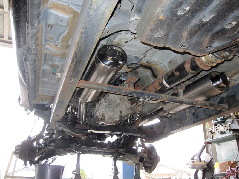

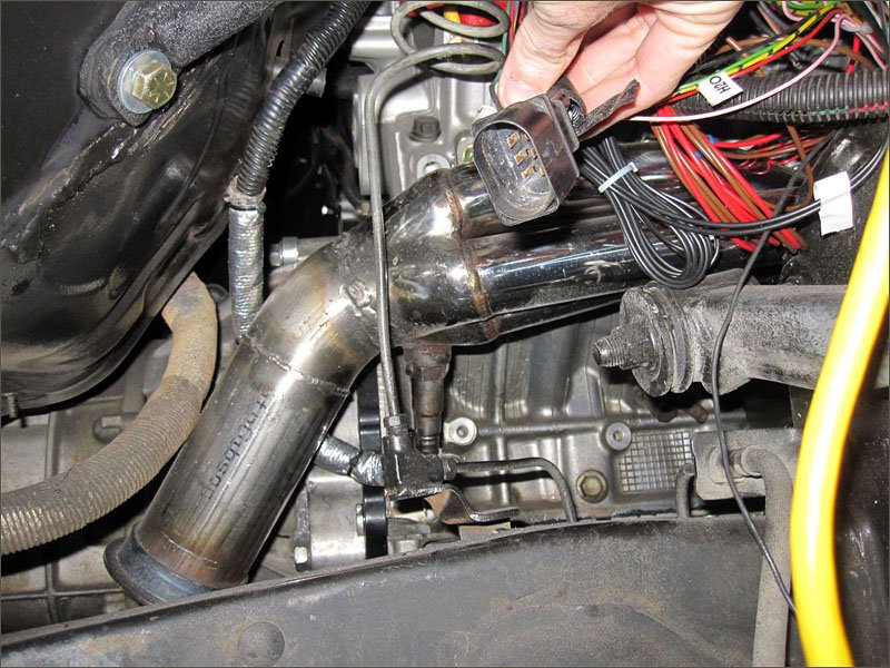

Made up my exhaust yesterday so now I'll be able to tune my Adaptronic. No use messing around with it if you only have open headers. Luckly it wasn't raining too bad yesterday so I was able to get this done pretty quickly. Later on if I like how these work I'll run some muffler tube from the ends of these back to have them dump out in front of the rear tires.
I had the pleasure of trouble shooting all day long and I was victorious in solving my problems. Here is a video I shot while working through a couple problems with the fuel pump signal. I hard wired the fuel pump while I was reading the computers fuel output signals. I got it working properly at 10pm tonight. This stuff ain't easy. I'm liking the Nascar sound! My neighbor txt messaged me when he heard it start up from the next house over. :D Ahhh sweet music.

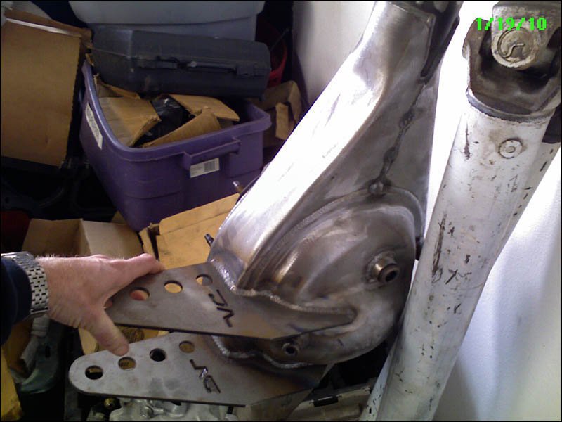

I did consider the R150F but I have friends at transmissions shops and the guys commented that the W59 will be fine. They just give the advice to fully depress the clutch and not to do anything stupid. Mine is a low mileage tranny I got recently and I can find W59's cheap anyhow so if it breaks I'll just go grab another one. Someones has to test out the W59 right? PLUS the W59s come with the much more desirable gear driven transfer case. So if you go R150F you'll be going backwards in that respect and you'll be going to Advanced Adapters to buy a plate to mount the better gear driven case. If I change to a different gear box it won't be Toyota that's for sure.

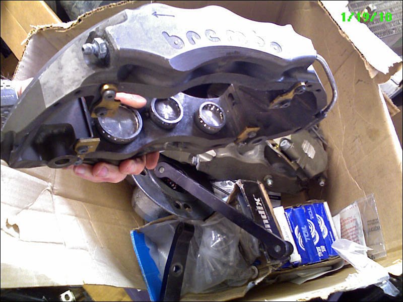

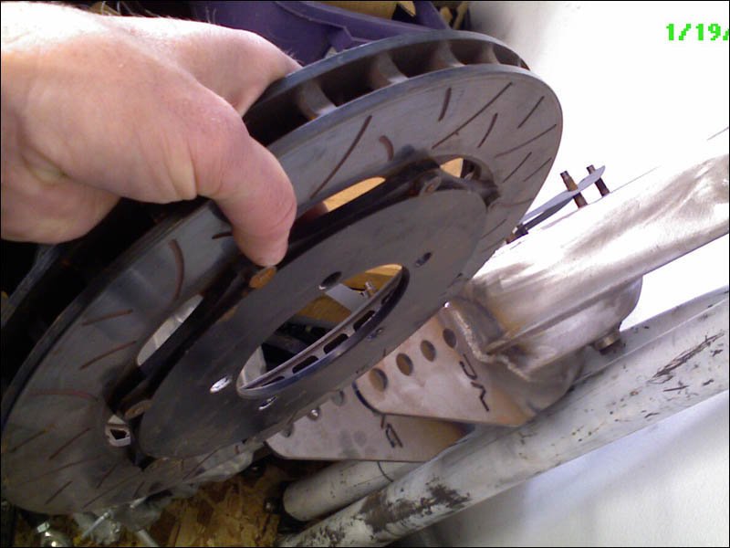

I have a nice used 9" already but I also have the option of using this new 9" full floating axle housing and some insane Brembo race car brakes. Yeah they are bigtime overkill but if I'm going to spend a little money to upgrade I might as well get the best bang for my buck! I would just need to rebuild the calipers maybe and pray that the pads that go with these have some meat left on them because they are extremely expensive. But it would be much safer driving around offroad and I have plans to go to the desert this summer. =]
I'll have to take it easy on my wimpy Taco rear end until I can afford the axles and hardware to mount this up.
2pc aluminum fully vented - More 1UZ power means brakes require upgrading as well.
Might as well put them to good use right?
