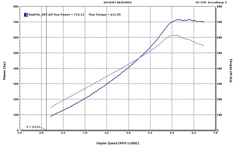

Just got the words for Carlos from AAP. The SC430 have custom rods, pistons and laid down 715RWHP at 24psi. Its running by Motec stand alone. Dyno sheets are coming.... Currently the car is powered by 550 cc injectors and they are maxing it out.

I love this car but I am surprised by the dyno curve. I would expect MUCH more low RPM torque. At 4000rpm it is not much different than a stock 430. This is weird. I would think more like 500-600rwtq at 4000rpm. The curve also gets very unstable above 6200rpm. Not knocking the car but just very surprised by this data. Typically an engine will double (or more) its torque at 15psi. Running a peak of 24psi at say 6000rpm should give an EASY 15psi at 4000+rpm.

Dyno sheet 715RWHP at 24 psi
Could it be due to how it is dyno'd?? I have had more to do with dyno dynamics than dynojets but i know it is possible to get vastly different torque curves depending on how it is run up. My theory is that due to a dynojet not being able to hold the engine at a particular RPM/Speed, you cant load the engine up to get it boosted then run it, it often does not give enough time to get the turbos up to speed so they are only coming on towards the top end, a bit like 1st gear vs say 3rd gear on the street. It is more pronounced on high HP cars.
The power curve could be a result of tuning done for reliability, or just that the car was maybe spinning the tires on the dyno.
