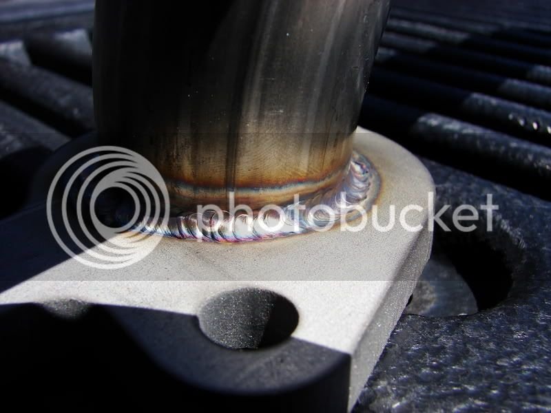

The headers are wrapped because the weldings are not done yet. I think they just tack weld the pieces together. So wrapping it would hide the weldings. Its way over priced.
I saw them on Supraforums, they look like they are TIG welded completely

These are indeed TIG welded, and extremely good welds. It seems to me that the average set of stainless steel headers is a minimum of $1000 to $1200 per set from any good fabricator. $2500, well, I won't defend that.
