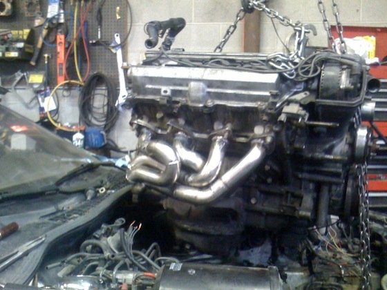

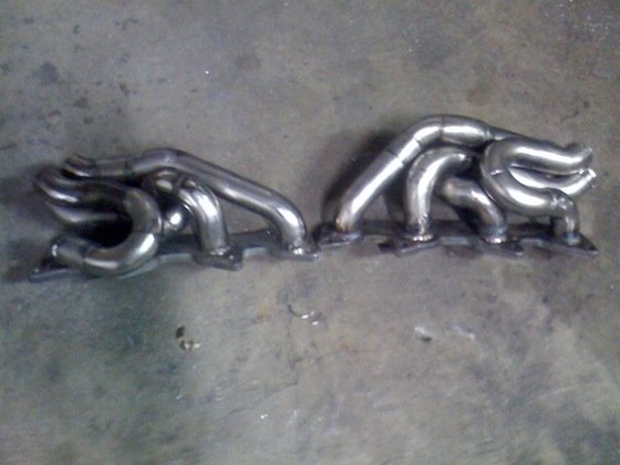

Well the mustang headers were a complete bust. Maybe the 4.6 would have been better. The passenger side hit the motor mount, which caused pretty much everything have to be completely re-done. The drivers side cleared the motor mount, but not the steering.
Basically I ended up cuttting both of them completely apart, and used an old MR2 ebay header I had for extra bends, and pretty much built these from all the scrap.

they might work, but still require a little work since the ports don't line up. Your drivers side(right side)will still need to be redone due to engine mount.
il price everything up, byt the time i add the cost of headers, postage, making them fit, i could probably be just shy of buying rush ones
i just dont have enough room to sit and make a complete set of equal length, whereas making a pair fit i could do in a day.
