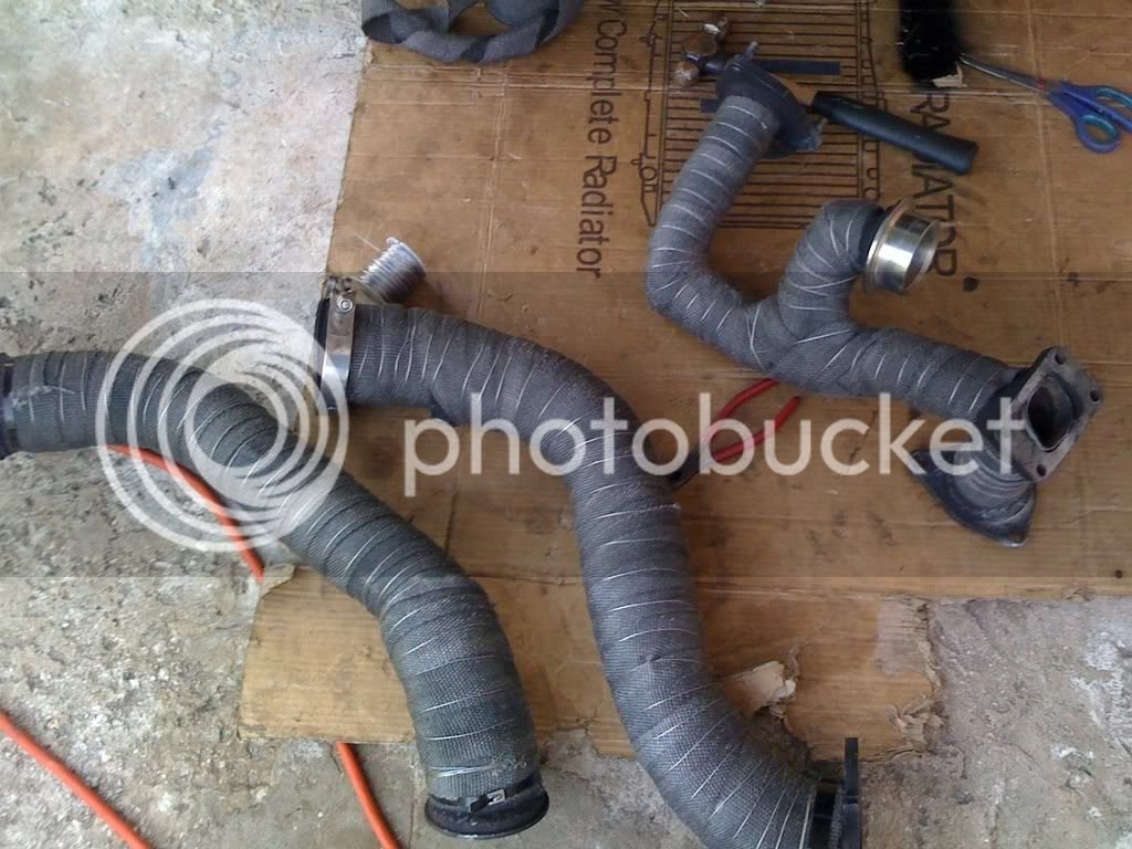

I'd say twin 2.25 will be equal to at least 3.5 or 4 inch pipe. A single 3" pipe will handle 600 rwhp easily. You don't need to go really big unless you aim for 800-1000 rwhp.so you think 3.5 to twin 2.25 wouldnt flow as well as the single 3.5?? I figured it would flow like a 4inch atleast given that the drag or resistance it will encounter during the splitting on the mass of air flowing through the 3.5 inch will affect a .5", but then again this is just me in my mind.
So far who do you guys think about the exhaust set up???![]()

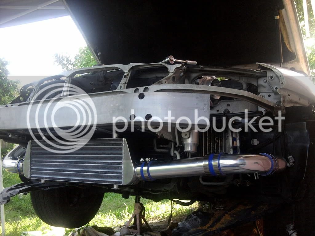

Ok cool cool sounds good would it be ok if i PM you once I get my FIC installed?.. exhaust went in today, AFPR, and some fluids, I might have a video by late night friday![]()
